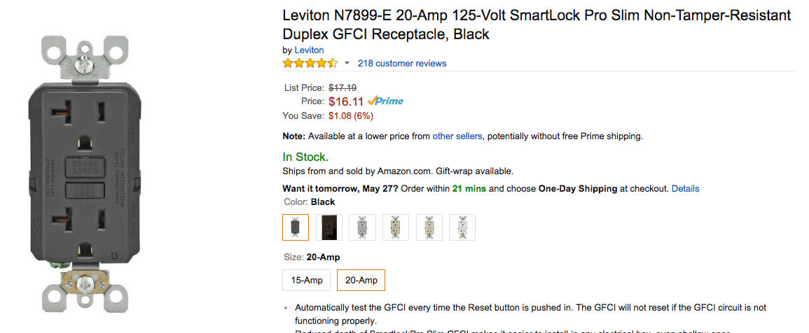

I think this will be ok to replace it, any objections?
http://greatlakesskipper.com/leviton-7599-e-black-20a-125v-60hz-ground-fault-boat-gfci-receptacle-w-wall-plate
