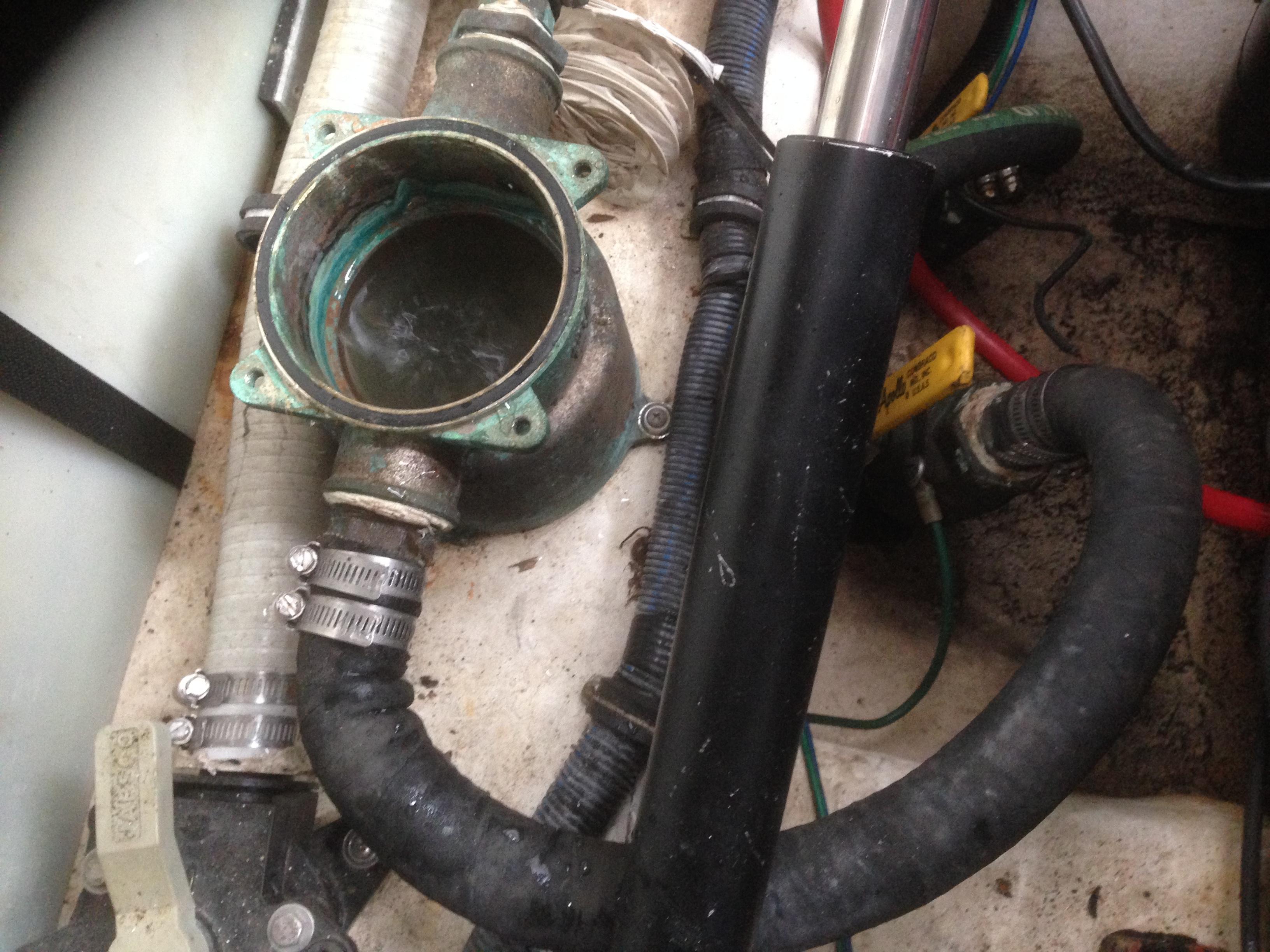

    Duane - a very nieve question. I asked my certified mercuries mechanic after reading your original post (and pictures). He said my boat doesn't have a strainer???
    Based on the picture I'm assuming it's an obvious part? Is my mechanic way off?  Do some versions of the mag 350 not come with one?
    most importantly where would I find it?

    Some boats have dual water pickups (one through the outdrive, one from a thru-hull with a strainer).  Some have only the outdrive pickup.
    If you have one, there will be a thru-hull fitting with a shut-off valve near the keel in the back of the engine room.  The strainer would be an 8" diameter metal can with a glass top and two rubber 1-1/2" hoses attached to it.  It would be pretty easy to find, so I'm guessing your mechanic is right and you don't have one.

    here is a picture of the basket for my strainer. it is on the starboard side of the bilge. the metal basket in my original post goes in the brass pot. there is a lid with a glass center so that you can observe the flow through the stainer. if you have one, you can't miss it.

    Thanks for the picture. Very helpful. Honestly I know that spot in my engine compartment and I do have a thru-hull valve but it clearly goes to my head. I just assume that's the water pick up for my toilet..?
    following up with my mechanic he said, "only closed cooling engines have the second pickup?"  My boat is raw water/sea water cooled and I only have the out drive pick up.
    I will absolutely look again but I think in my engine compartment the only thru-hull opening I have is the one piped to the head.....
    thsnks again
