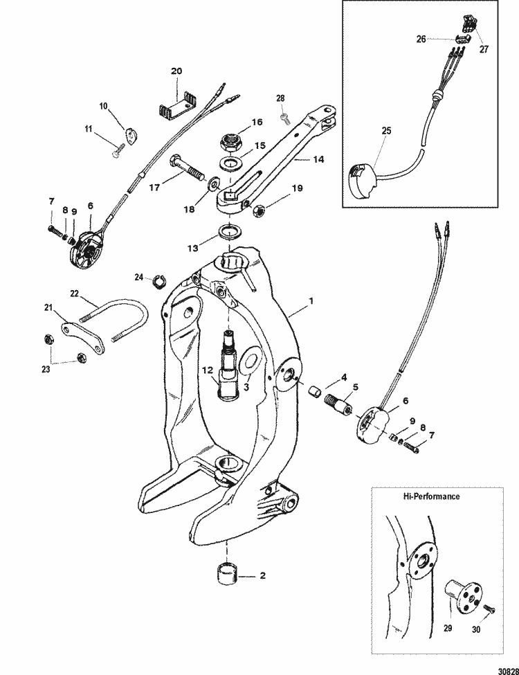

    He stated the drive should not move side to side more than an inch...that's pretty much what is used to diagnose a worn gimbal ring and steering pin.  5800 for both drives...assuming them both need it done seems very reasonable.  I think the hazard would be lose of steering????

    I agree with @skennelly, they are talking about the swivel pin/gimbal ring. I had more than an inch when I did mine, mechanic told me he'd seen worse so not sure it's such a major issue but does need to be done at some point. Extreme hazard - no, you'll lose steering on one drive but then I doubt it will be a sudden "break" either.

    Well...here are my thoughts on this. First, have not heard the service history on this TA. Second, look at the design above. You have a round steering pin and a half oval u bolt to secure the gimbal ring. What really is going to limit the left to right movement of the out drive? My answer is the rest of the steering system. Granted, if the steering pin becomes worn I can see you have some slop or a little play but if your moving an inch left and right, that steering pin would have to be worn to a pencil. I just replaced mine, which really had very little wear but had some putting at the seal. Still have the same amount of play. Was told by someone else (which I have not tried) to check when it's running and the power steering system is under pressure. Or, there is some excess play in the cable..still working on the rest of the possibilities. But to say replace the transom assy because of that play I say fuey!
  • IanIan Member Posts: 2,900 ✭✭✭✭
    @rasbury, agree that you need to look at the system but also at individual parts of it methodically. The pin is not the only wear point, the ring itself is more the culprit I saw based on the wear of the square hole in it versus pin wear on mine. An inch of play side to side at the skeg is only a fraction at the pin/ring and careful inspection looking at how the ring moves with the pin and the steering arm is the key - if it moves and the steering arm doesn't, there is pin/ring wear. If you see the arm moving as you side to side the drive then I agree, the issue is likely more at the other components such as cable play. Fuey? - I also agree, more information than "transom housing" is needed to understand what they think the real issue is and path to repair. I'd say from the description and age pin/gimbal ring is at least the core issue.
  • rasburyrasbury Member Posts: 8,477 ✭✭✭✭✭
    From what I saw on mine, the square part of the pin is not a wear point, only the round part that contacts the u bolt. It really is not a very good design, the whole asy imo.  If you can move the gimbal from side to side that's a problem. And by that I mean say the diameter of that pin is .75 and it is worn down to .50 giving you 1/4" slop allowing side to side that is a problem. If the pin is the proper dimension and you grab the foot and it pivots side to side then it's just doing what it's supposed to do and that slop is some where else in the steering.

    True but it is possible to see by inspection with 2 people looking at the steering arm and pin.
