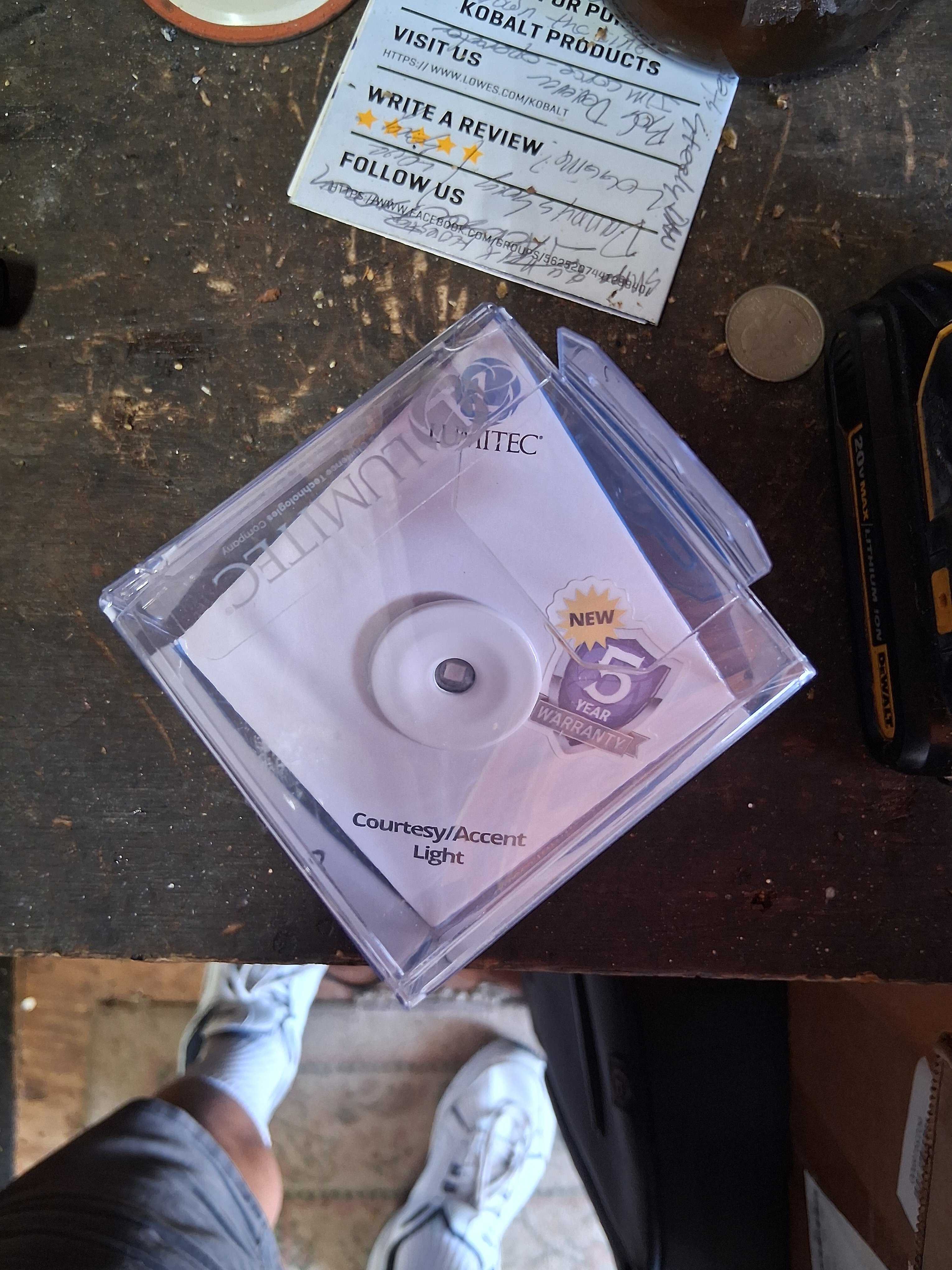

Our 270 has two courtesy lights- i replaced one with a nice blue led- should have bought two- i looked on great lakes abd also amazon but not finding a replacement- these are 1/2" dia best guess...also, my rocker switch for the hatch puked- is that considered a 3 way or two way switch? Will I find one that will fit and be pined the same? I have not pulled the switch for a part number but it is 2006...

Most of the year I don't care for the backlight switches but as fall approaches and the sun goes to bed much we earlier, I don't like having to fumble around for the switch I want to hit.
Actually it must be as there is not dark spot in the middle where this is.
