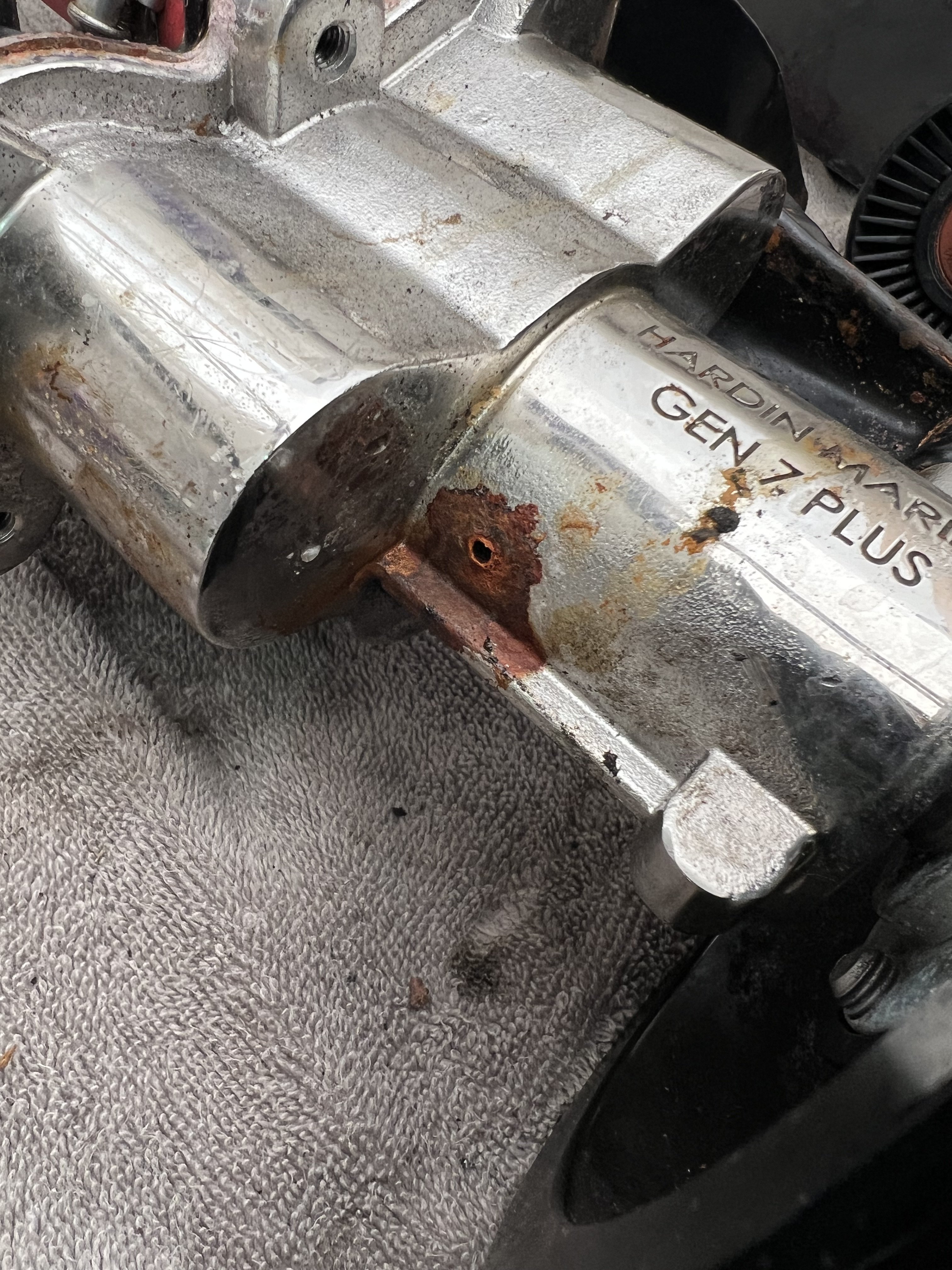

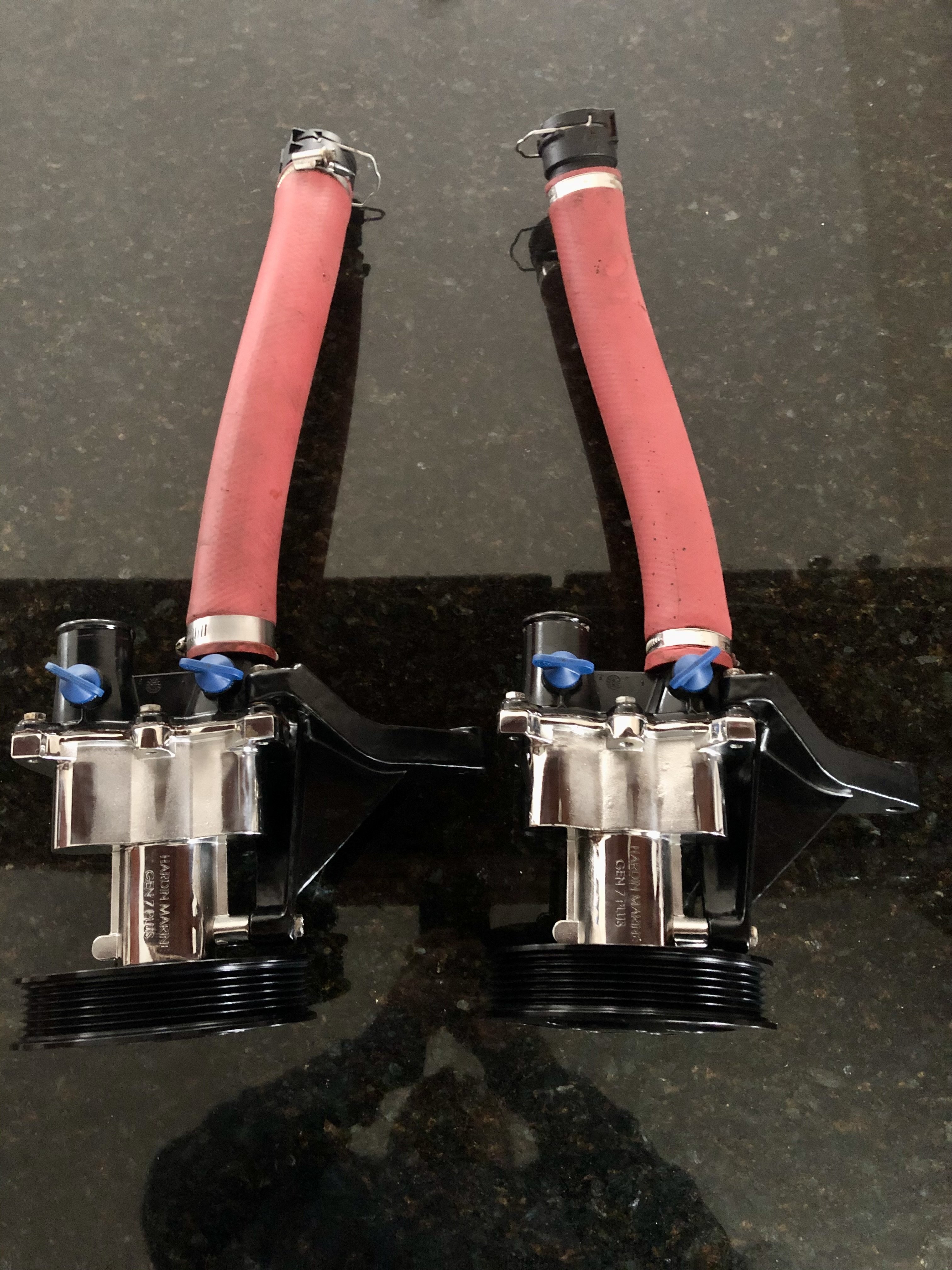

Just resurrecting the topic since it is now time for me to do some replacing. My shaft seals are leaking. I've read all the past topics and have a pretty good idea about them but does anyone have any real world experience on the Hardin Gen 7 Plus series since we last discussed in 2023-2024? Such as longevity and value compared to OEM?
My mechanic said he can make the switch while in the water - but that makes me a bit nervous. Anybody swap a pump while in the water?
I know @LaRea was the resident expert on rebuilding these Hardins but has moved on to bigger and better things!

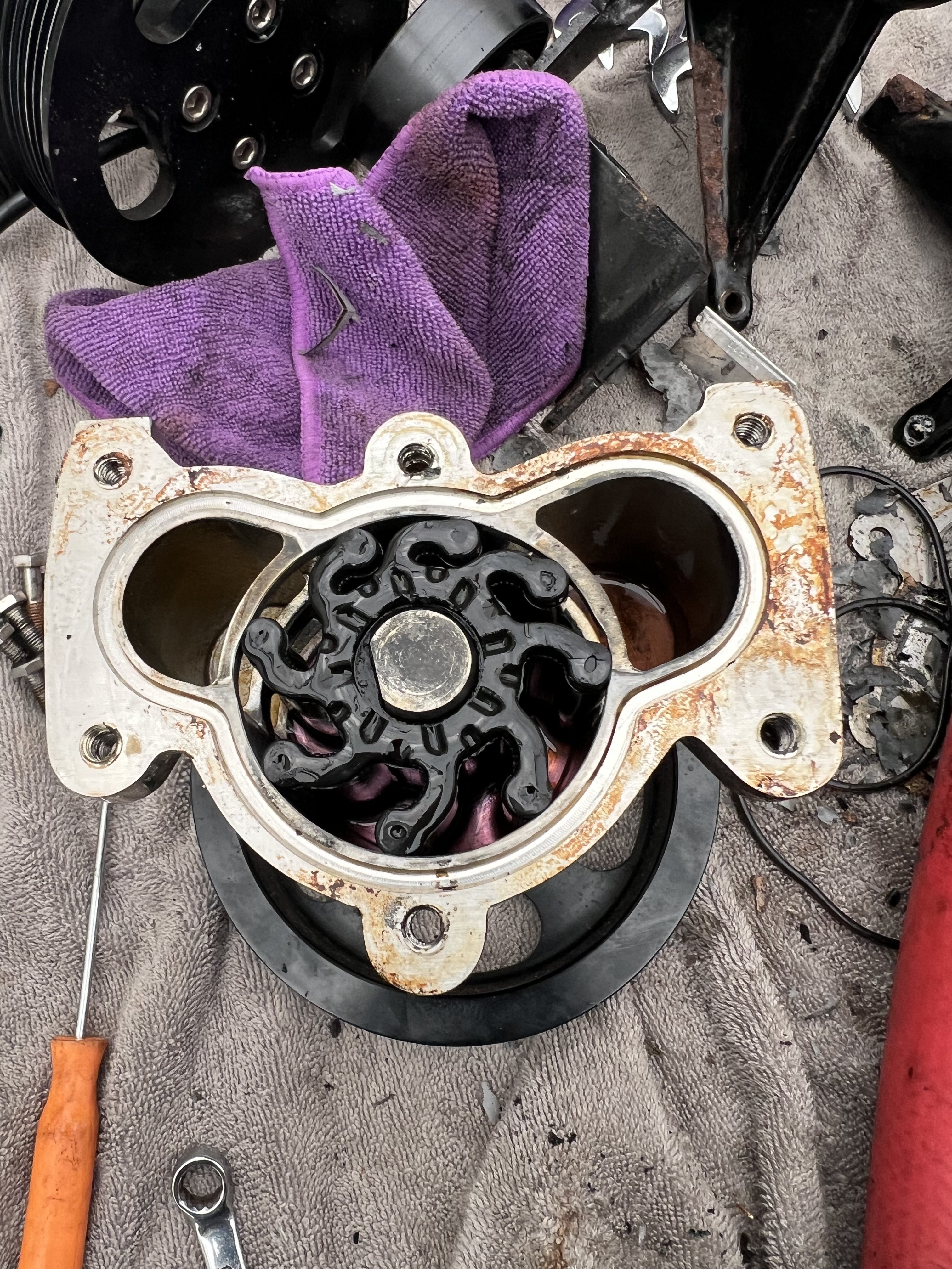

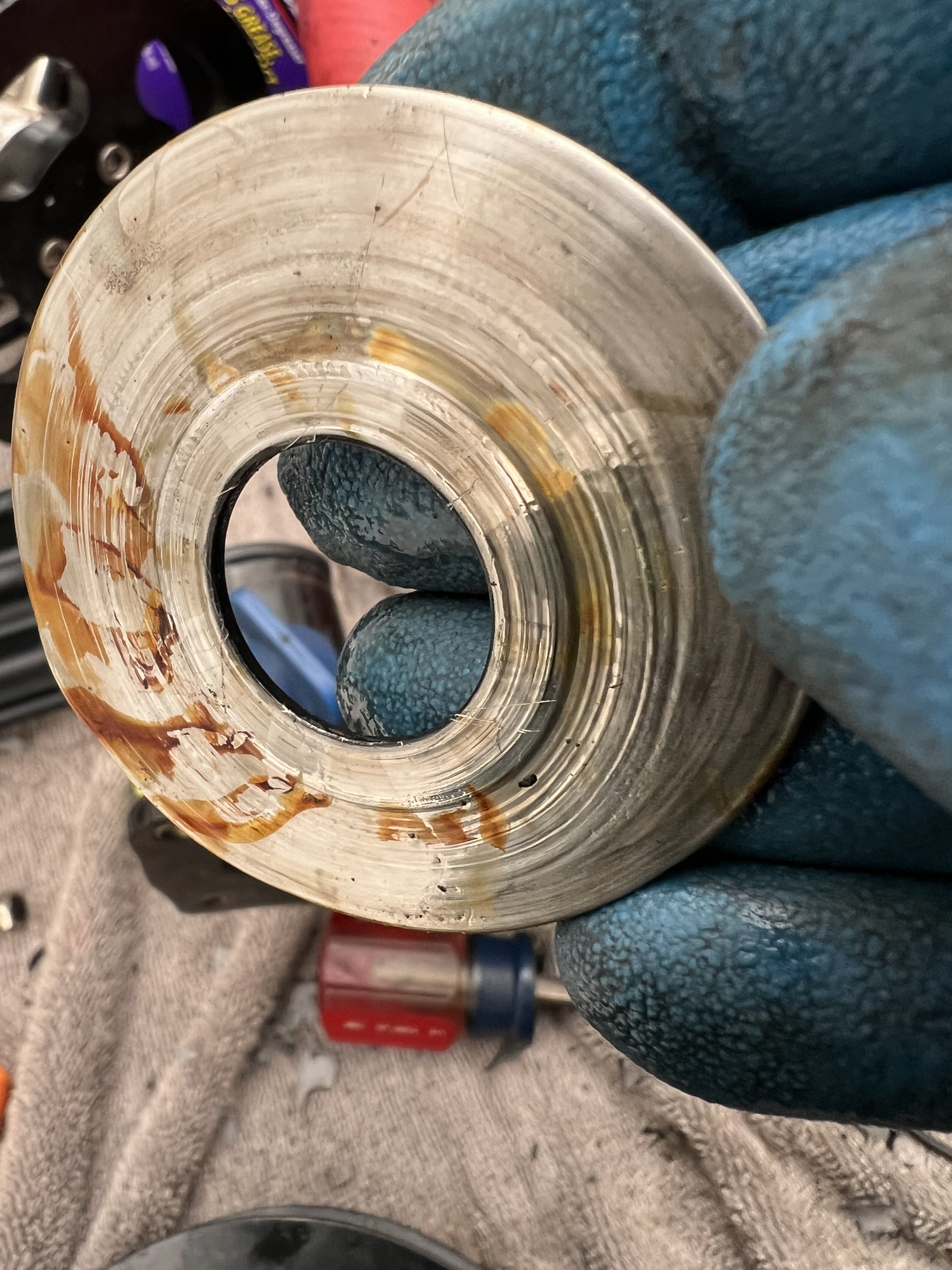

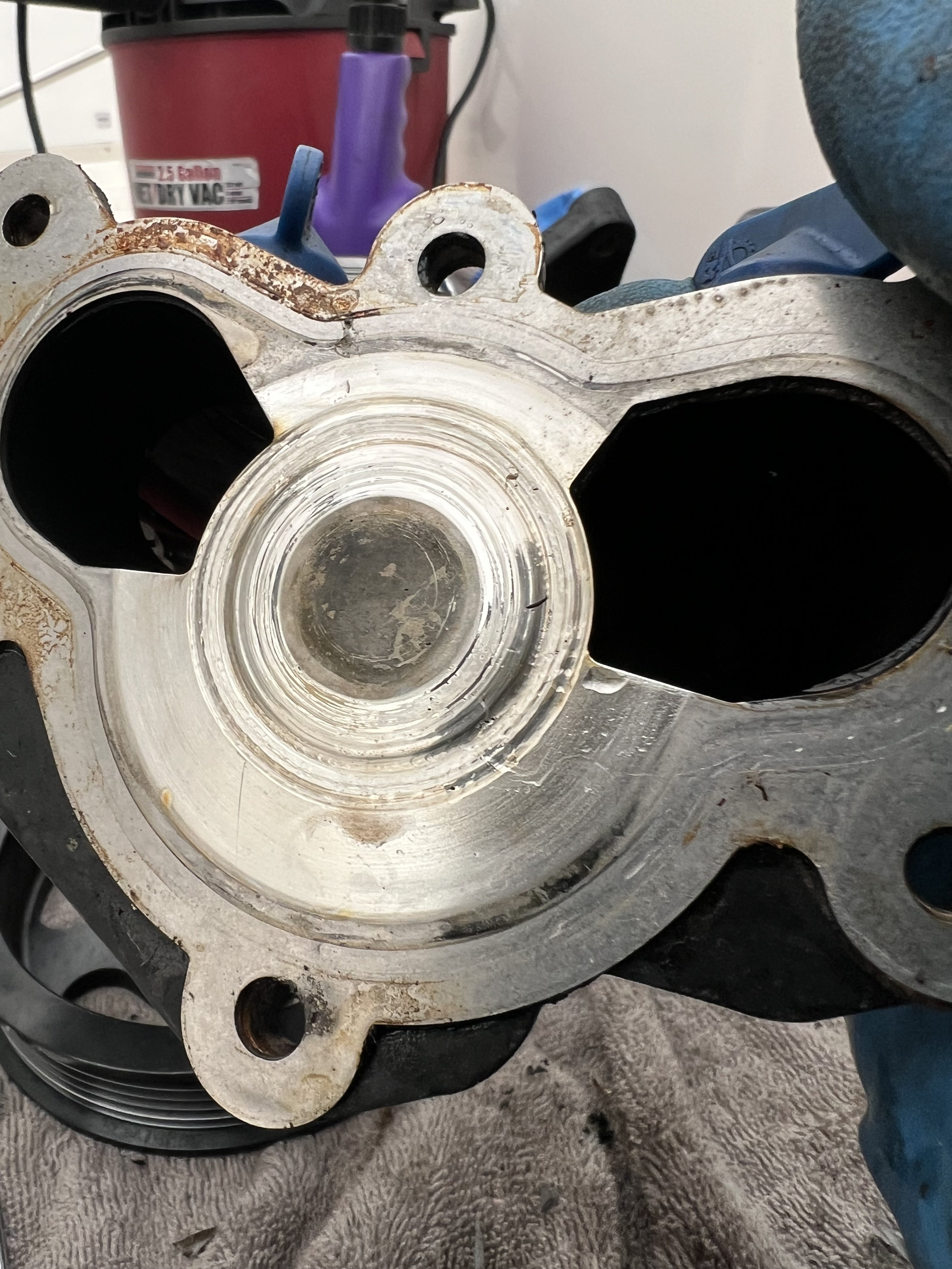

    The "better" is replaceable wear plates.  When the inside of the pump body gets worn from ingesting sand or whatever, you can replace cheap wear plates instead of buying a new pump.
    Hardin's original pumps were great, except the bearings and seals didn't last long enough.  The "Plus" models have bigger, stronger bearings and seals.  The question is -- do they actually last longer?  (I never owned one, so I don't know.)

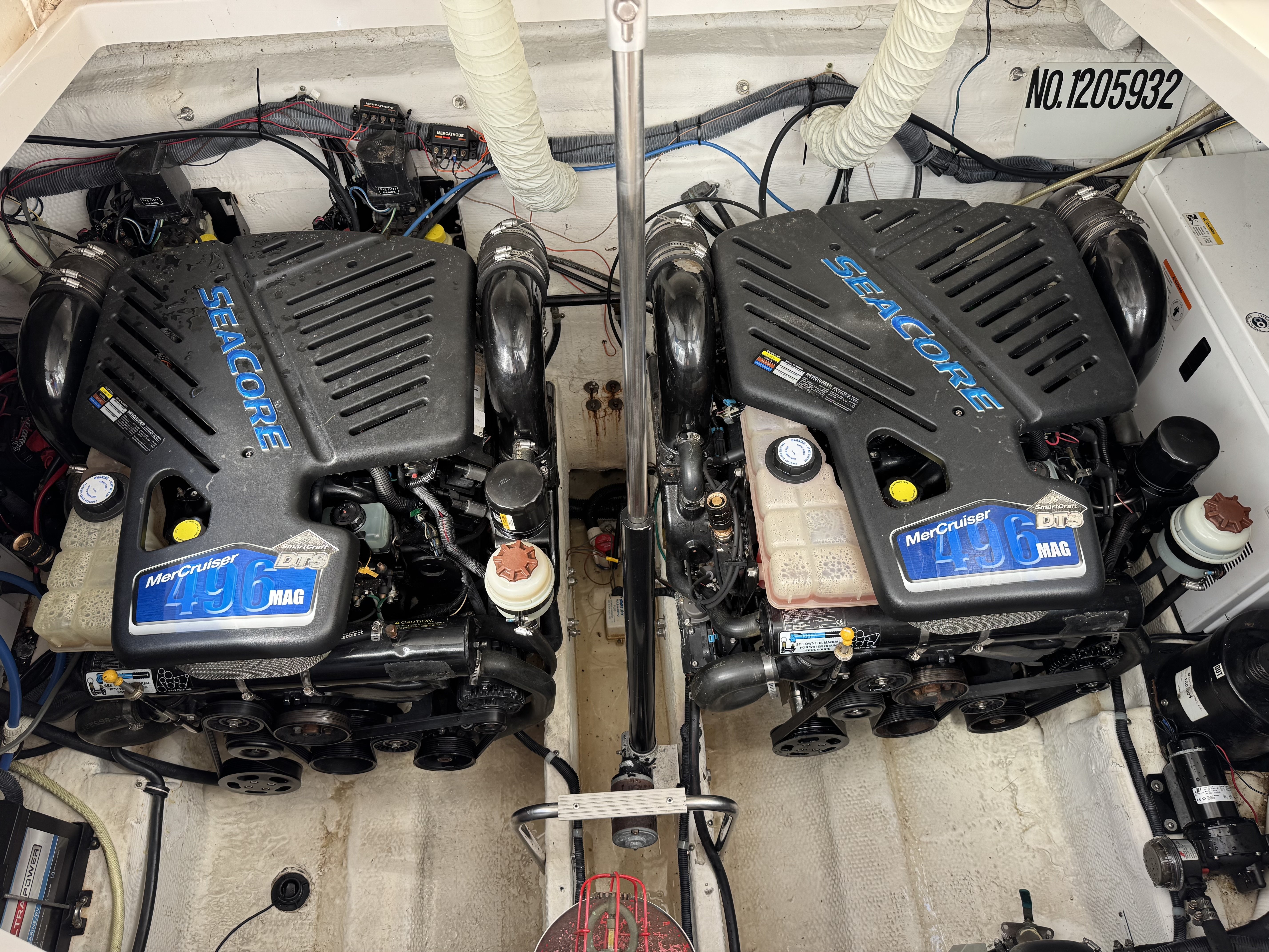

    Well I guess I will be the Guinea pig for the Gen 7 Plus.
    I found a guy who was selling his boat and the new owner wanted all OEM so he swapped out his newly (10 hours) installed Hardin back to Quicksilver. So I got it with an extra (new) impeller, plates, adhesive, and stainless bolts for $400.
    Plan is to install the Hardin and then rebuild the OEM for future use if/when needed.
    I'll keep everyone posted as to the long-term success/failure.

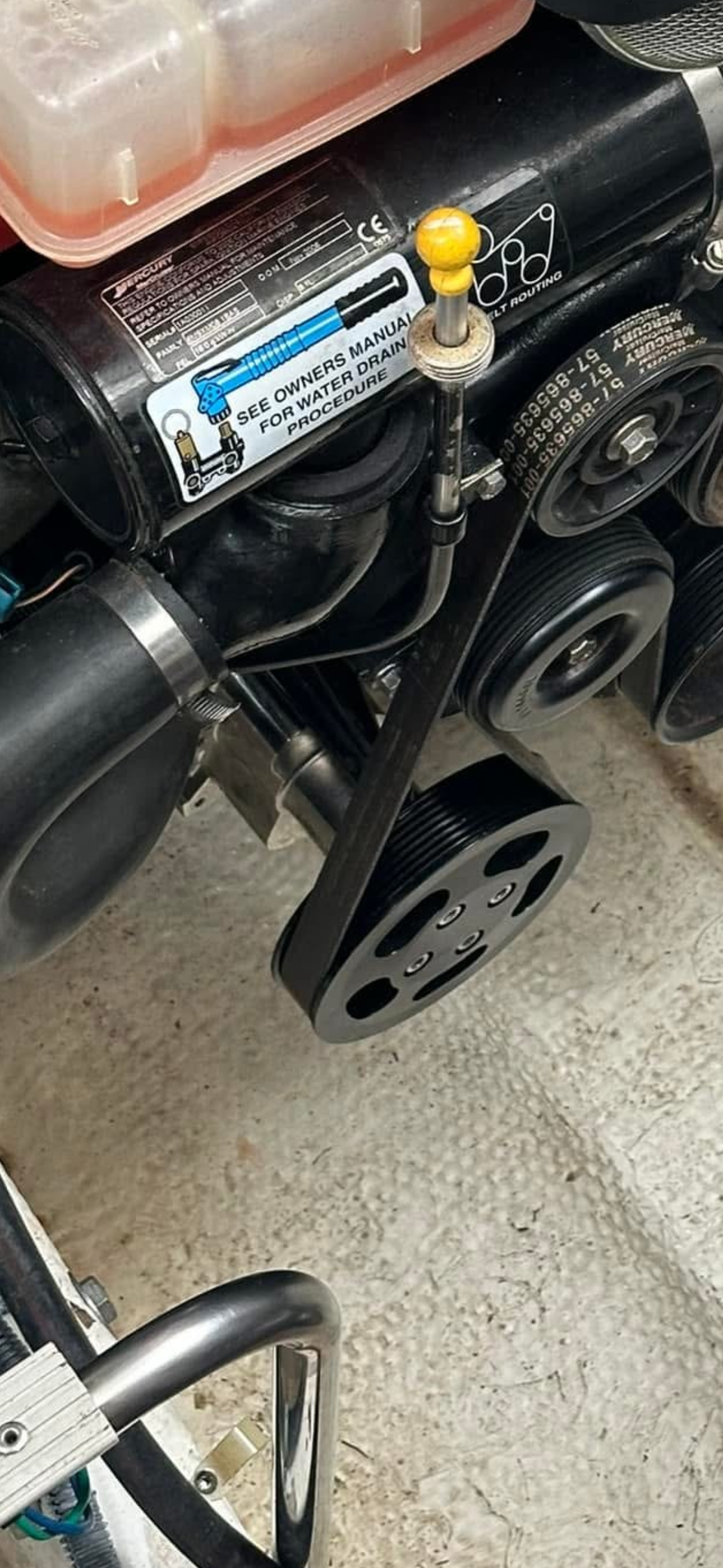

    When you guys remove the pump are you removing it with the bracket? Can you remove them without the bracket, seems like it would be tough to reach the bolts. Have I been doing it the correct way?
    edited October 2025
    My mechanic did the dirty work while I "supervised" -- he removed it with the bracket. For him it was a little over an hour of labor for each engine to swap out old and new. He definitely knew what he was doing. BTW - I wound up with Mercury OEM instead of Hardin because of an order mix-up. So now have two new OEM pumps.
  • LaReaLaRea Member, Moderator Posts: 8,078 mod
    Yes!  Much easier to remove the bracket.  I learned that trick on this forum many years ago.
  • YYZRCYYZRC Member Posts: 5,557 ✭✭✭✭✭
    My brackets had a little tab on them that hit on something (engine block or pulley, can’t remember) that made removal annoying. I ground the tab off and now it’s almost a pleasure to remove the pumps. Ha!
  • aero3113aero3113 Member Posts: 10,041 ✭✭✭✭✭
    Are you removing them with the intake hose on? I’m assuming that’s why it has the quick disconnect.
    I take the hoses off at the pump because I can’t reach in beside the starboard motor to wrestle with the quick connects.
