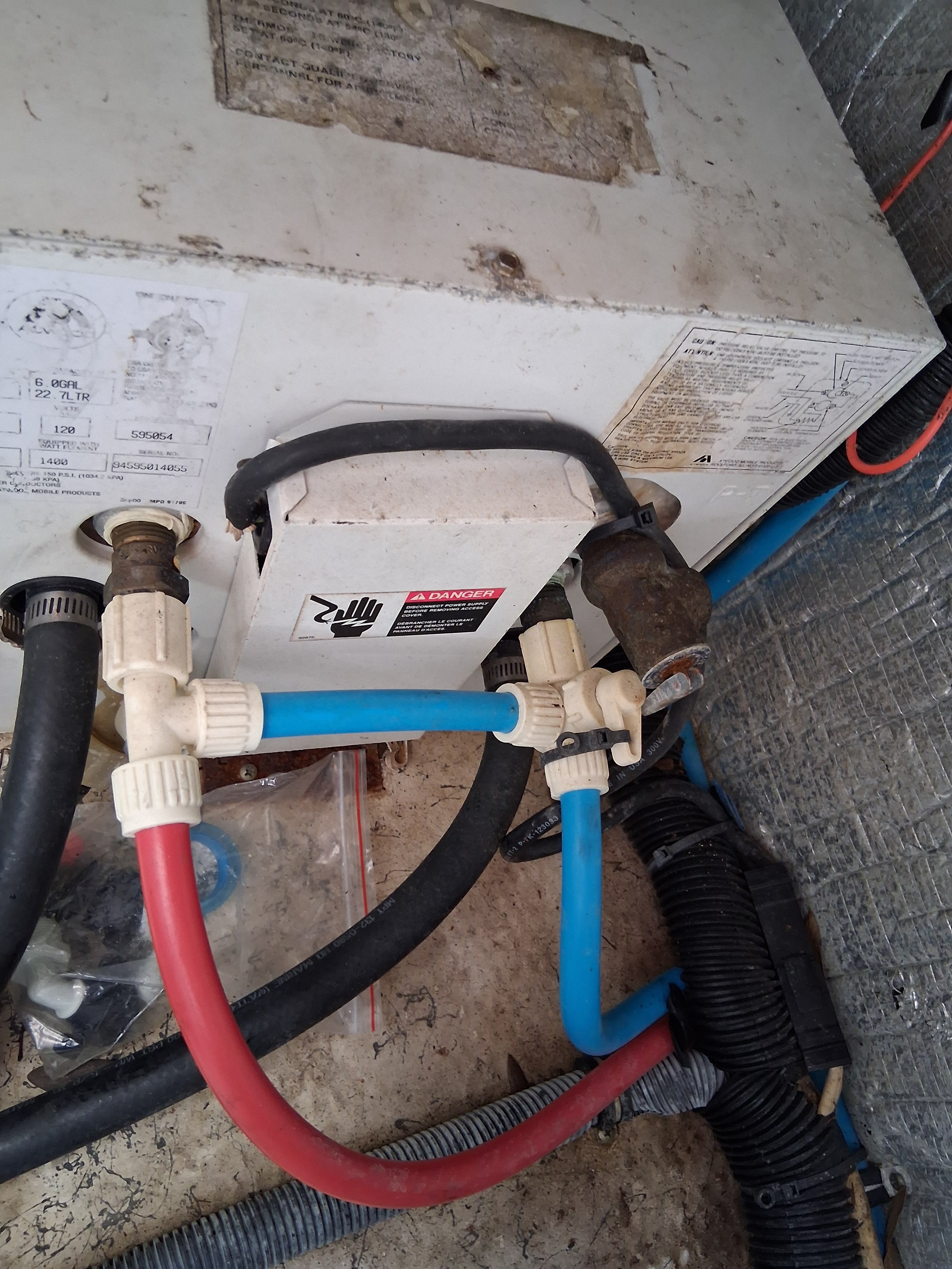

  • rasburyrasbury Member Posts: 9,012 ✭✭✭✭✭
    What pressurizes the hot water side? It really is not making sense- looks like water goes in but never comes out!
  • GrahamuGrahamu Member Posts: 922 ✭✭✭
    edited August 2025
    The valve enables you to bypass the hot water tank. In it's present position in, your photo, the pressurized cold water (blue) goes into the tank where it is heated and then exits via the red pipe under pressure. If you cut the tie wrap holding the valve open and turn the handle you will bypass the tank and all hot water taps and showers will receive cold pressurized water. This is use full when winterizing as you do not want antifreeze going into the tank. If you do this make sure the electrical breaker for the tank is turned off. Also do not drain the tank until finished winterizing.
    @Grahamu - Is spot on with the description, but I am noticing that the hot water side tee does not have a valve, so if you did winterize with antifreeze it would backfill into the hot water heater and defeat the purpose of isolating the heater - and add an extra six gallons of antifreeze to the system if filled. Should be by-pass valves on both hot and cold side to work correctly.
    @TonyG13, I mentioned not to drain the tank until finished winterizing. With the tank full of water it has nowhere to go and prevents antifreeze from entering on the hot water connection.
  • YYZRCYYZRC Member Posts: 5,548 ✭✭✭✭✭
    Next time your boat is in the water, start the engine and, with the freshwater pump turned off and the engine running, open a faucet (hot or cold). If water comes out, you have a rotten heat exchanger in the water heater.
