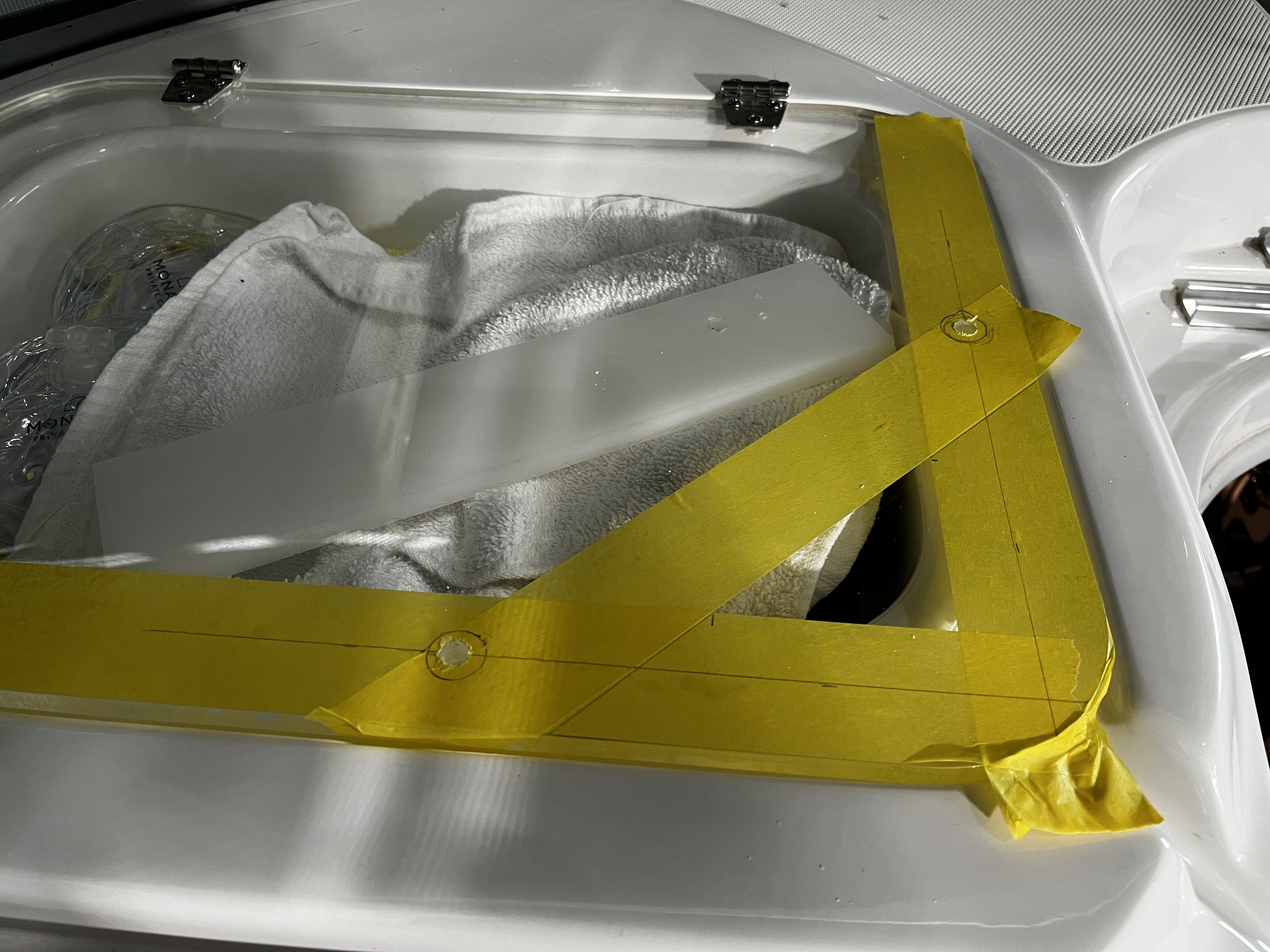

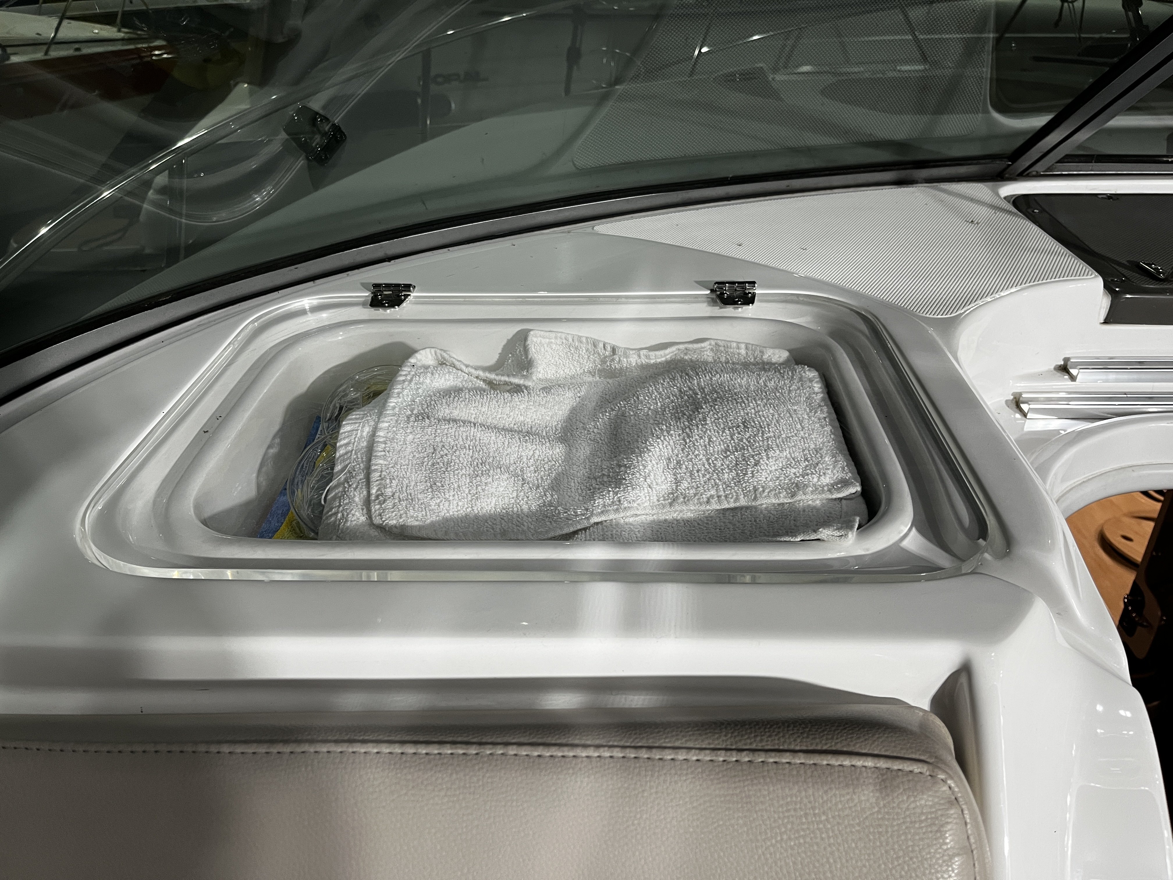

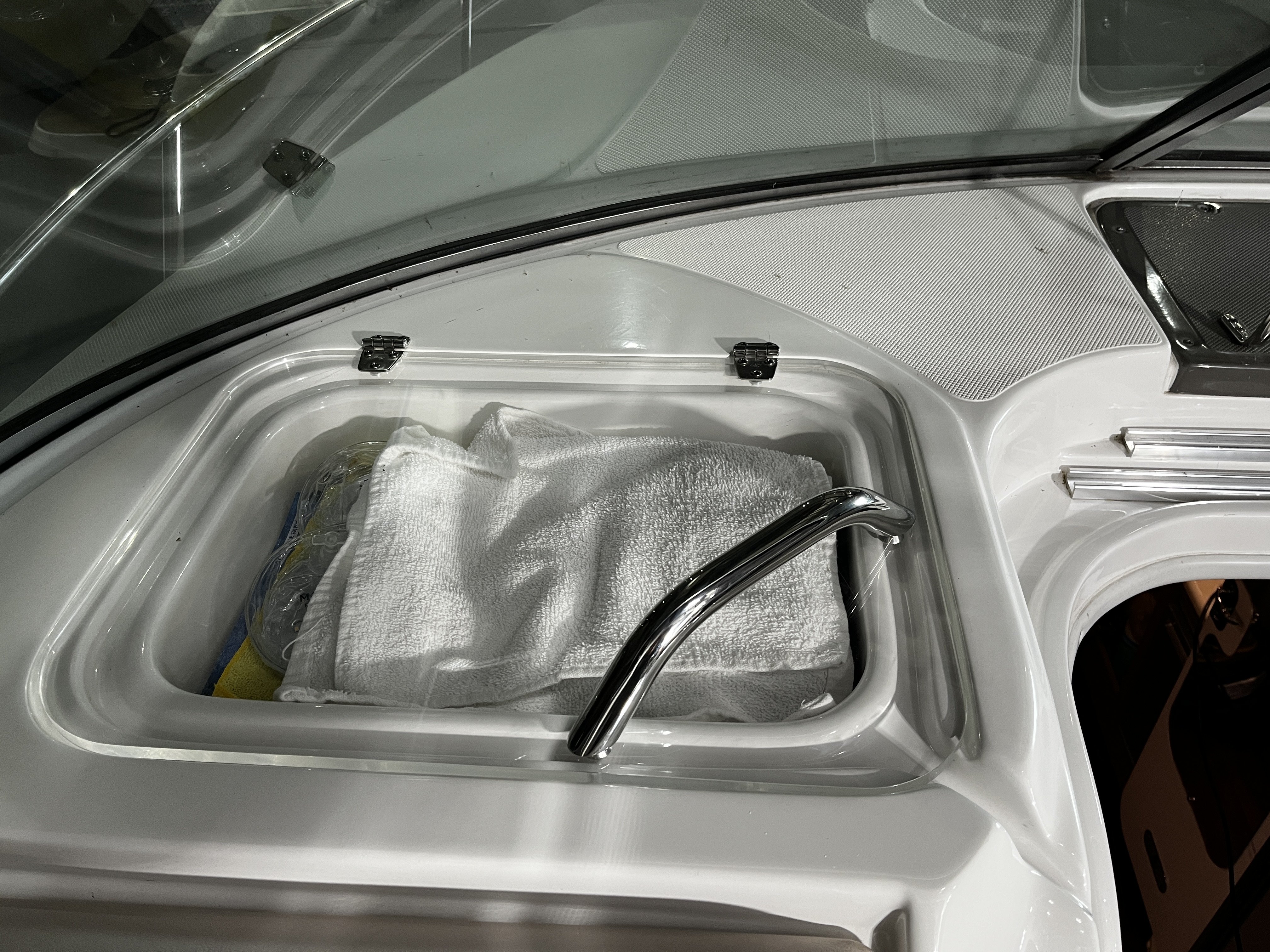

    Another day, another project. Installed a grab bar on my acrylic map tray cover. Lots of time when someone is standing next to me at the helm they're looking for something to hold on to. Had a grab bar laying around so I decided to put it to good use.
    Hardest - and most nervous - part was drilling through the acrylic without cracking it. Took about 15 minutes per hole going light pressure and slow speed to work through the 1/2" acrylic. I think it came out pretty well.
  • captkevincaptkevin Member Posts: 475 ✭✭✭
    I'd be nervous if any one really pulls on that & breaks the acrylic or pulls out the hinges
  • TonyG13TonyG13 Member Posts: 1,406 ✭✭✭✭
    I thought about that. It's a pretty hefty piece of acrylic. It's 1/2" thick and the way they designed it to sit in the recess, it's in there pretty solidly when closed. Absolutely no side-to-side movement, so the hinges shouldn't loosen over time. As for the drill holes, it's recommended that you drill at least twice the thickness from the edge to avoid cracking. I did 1-1/4" from the edge. After I installed it I pulled and put as much weight on it as I could and it seems pretty solid. We will see how it holds up over time.

    TonyG13 said:
    Maybe when closed if you had a latch to hold it in place closed...
