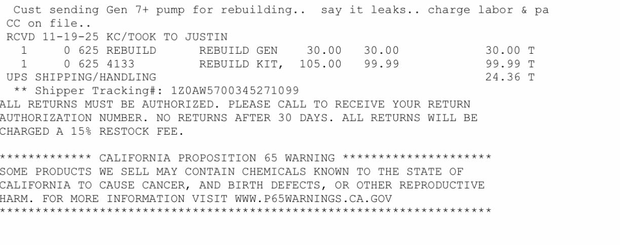

I sent my leaking starboard pump into Hardin for a rebuild. They said it’s $35/hr. Plus parts. I figured to have them do it, this way it will be covered under warranty if it leaks early.

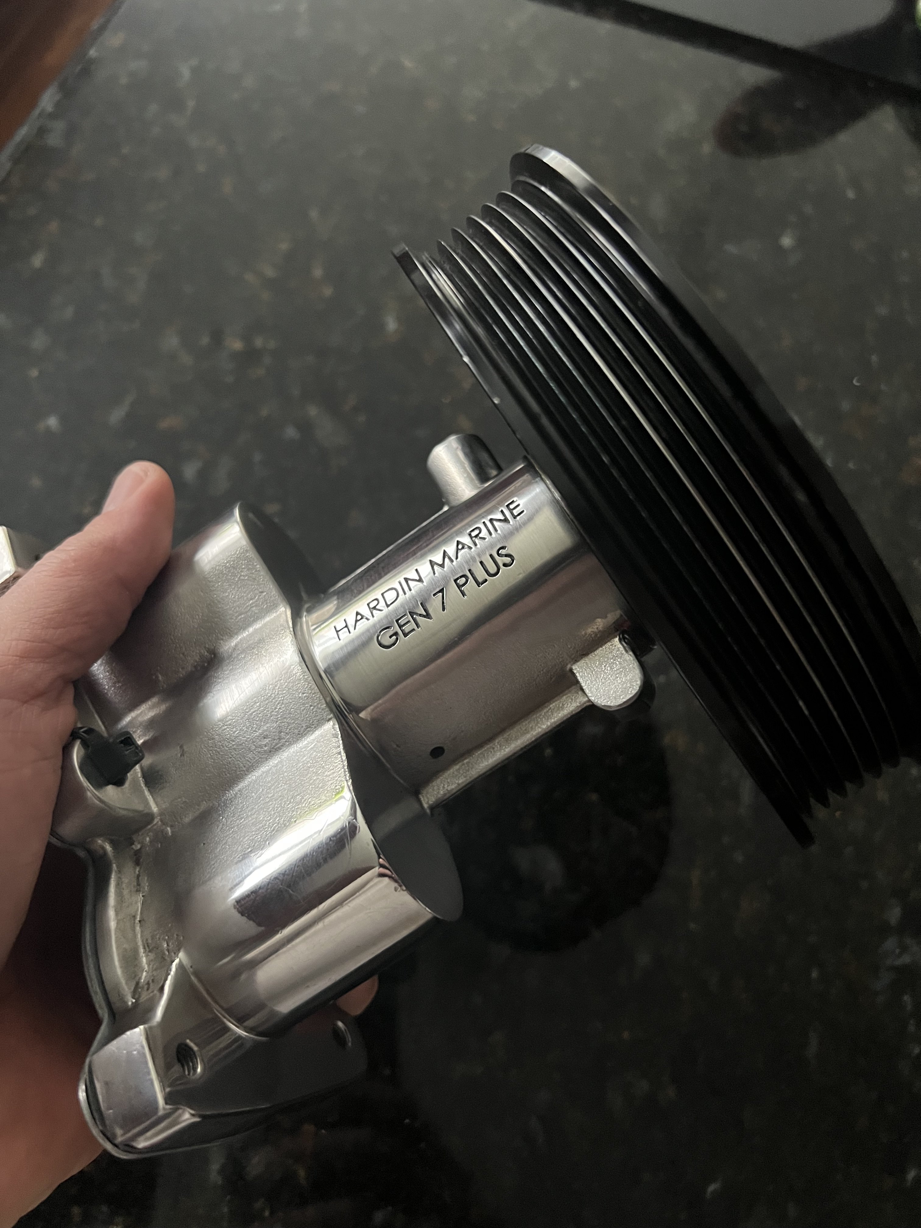

When I bought my 330 both of the OEM pumps were leaking. I went with the Hardin pumps because of the removable wear plates. I’m happy with them, this was the 5th season using this pump before it started leaking. I’m not regretting them but yes, they should last longer before the seals wear.
Seems like the Hardin solved a problem that very few people had (wear on the inside end of the pump) but created a bigger problem in that the seals and/or bearings fail much sooner than the OEM pump seals/bearings.
But yes, to your point @Ian , they sure are pretty!

Is the “prettiness” worth the cost?
