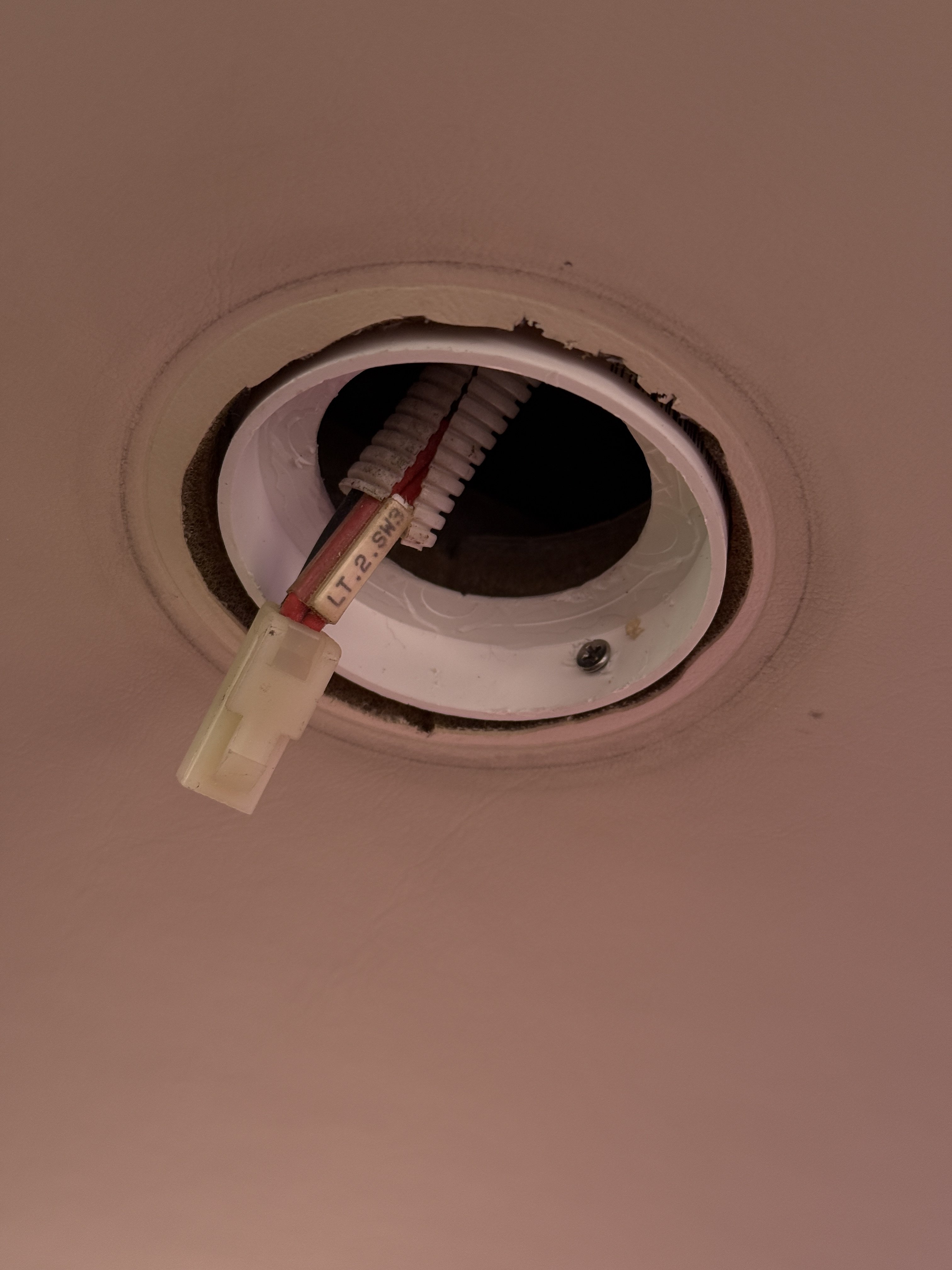

    Latest project: Upgrading to a wifi-controlled dimmer system for the salon, galley and cockpit.  It was much harder than I expected, but you guys know I like a challenge.
    I replaced 17 light fixtures a couple years ago, but those lights are not dimmable (which is why they were so cheap).  Those are going to the landfill.  Nobody on the planet makes a dimmable puck light that fits the cutouts on my boat, so I had to get creative.
    For each cutout, I had to install a spacer to reduce the diameter.  The solution:  buy PVC pipe caps from Home Depot, and drill out the middle with a hole saw.  That insert gets screwed into the cutout, then the fixture pops right into the insert.

    Wrapping up the light project ... here's one of the cutouts with a PVC pipe cap screwed in.

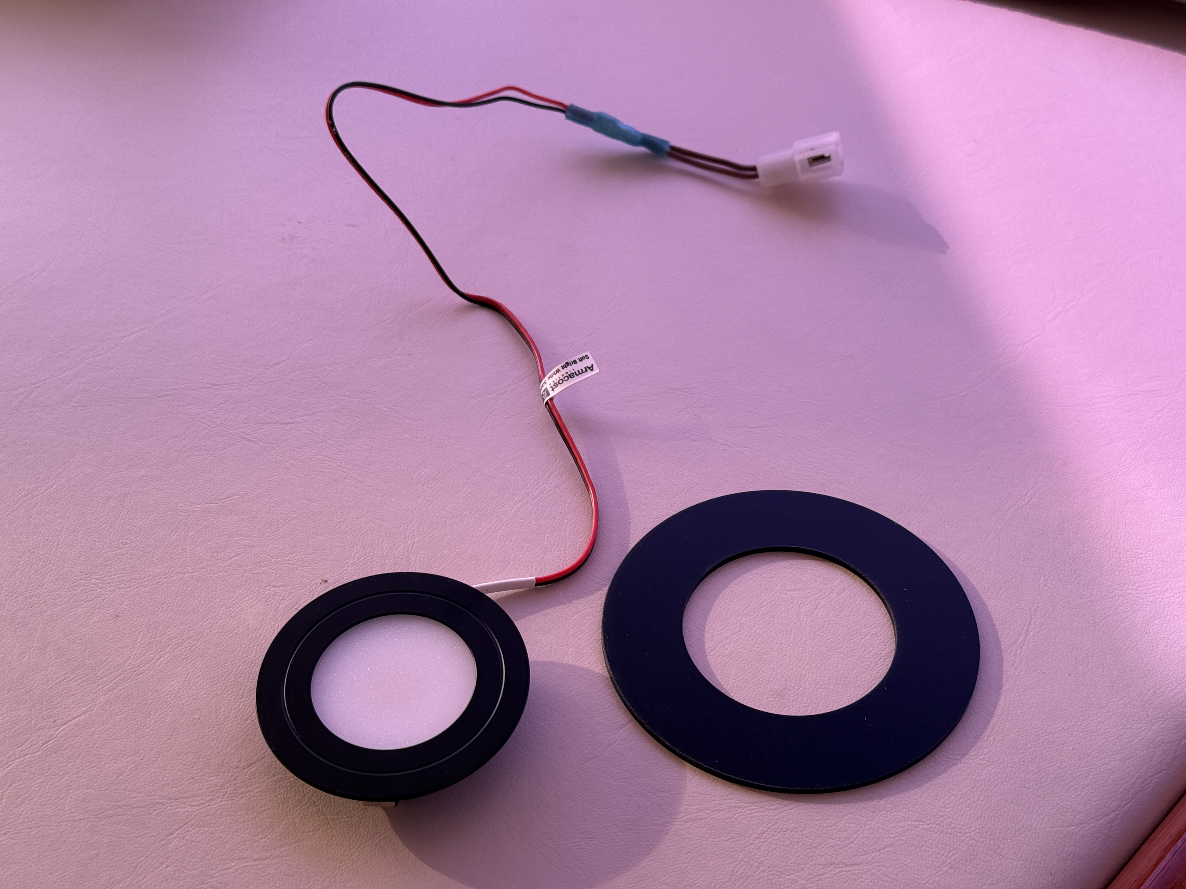

    And a light fixture with the custom trim ring:

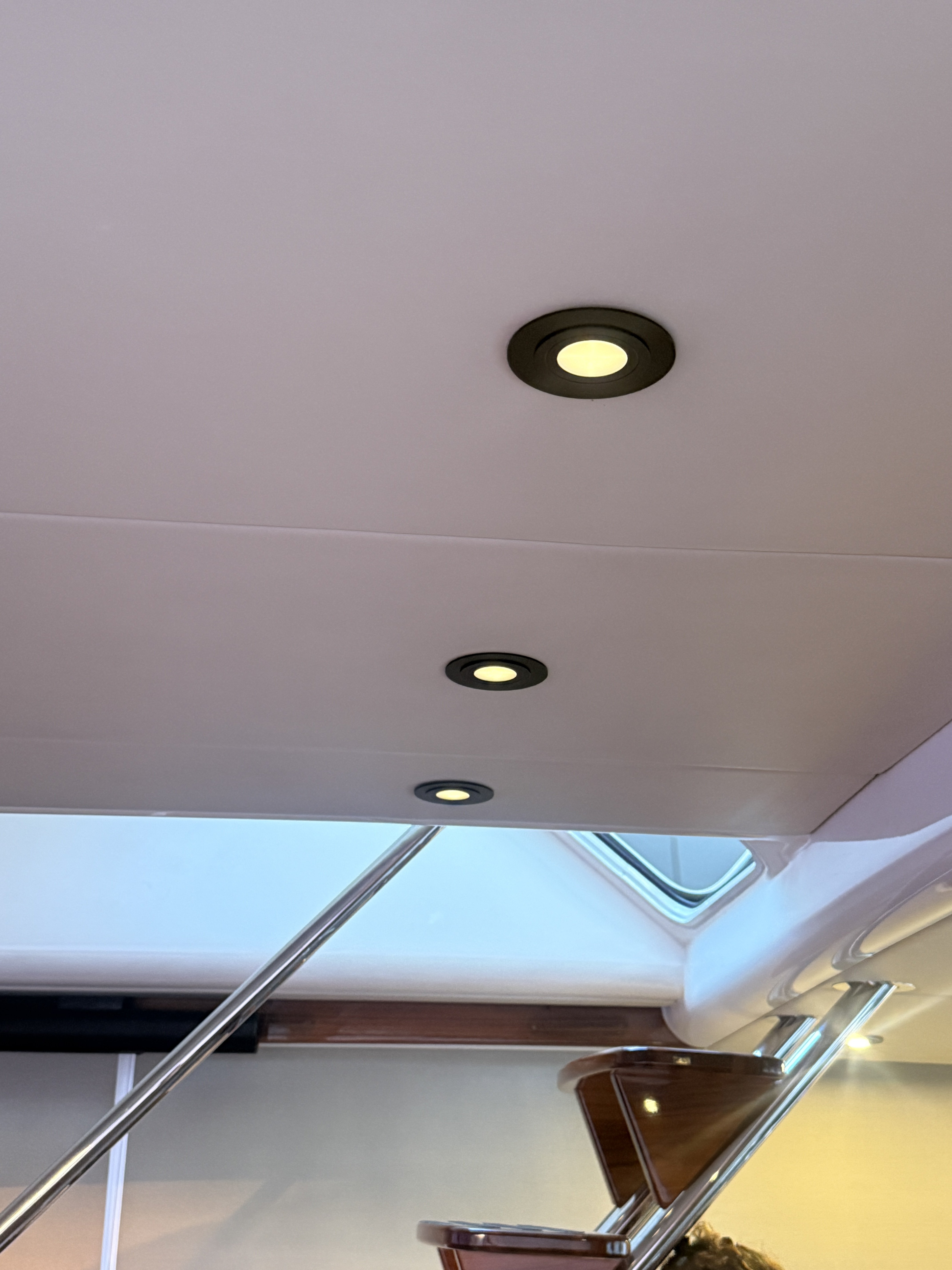

    Multiply all of that by 17 fixtures and you get the finished product.  This was a good outlet for creative energy.  All controlled by cell phone or wall switches.  At some point, I'll figure out voice control too.
    But the main thing is that now, with dimmers, we can actually use them for something other than cleaning or chasing away overserved guests.  :D
  • grouch0jrgrouch0jr Member Posts: 233 ✭✭✭
    The trim rings look nice. Custom? Did you make them, or have them fabbed?

  • LaReaLaRea Member, Moderator Posts: 8,074 mod
    @grouch0jr - they are from 1800ceiling.com.  Pretty much any size you want.  Very happy with them.

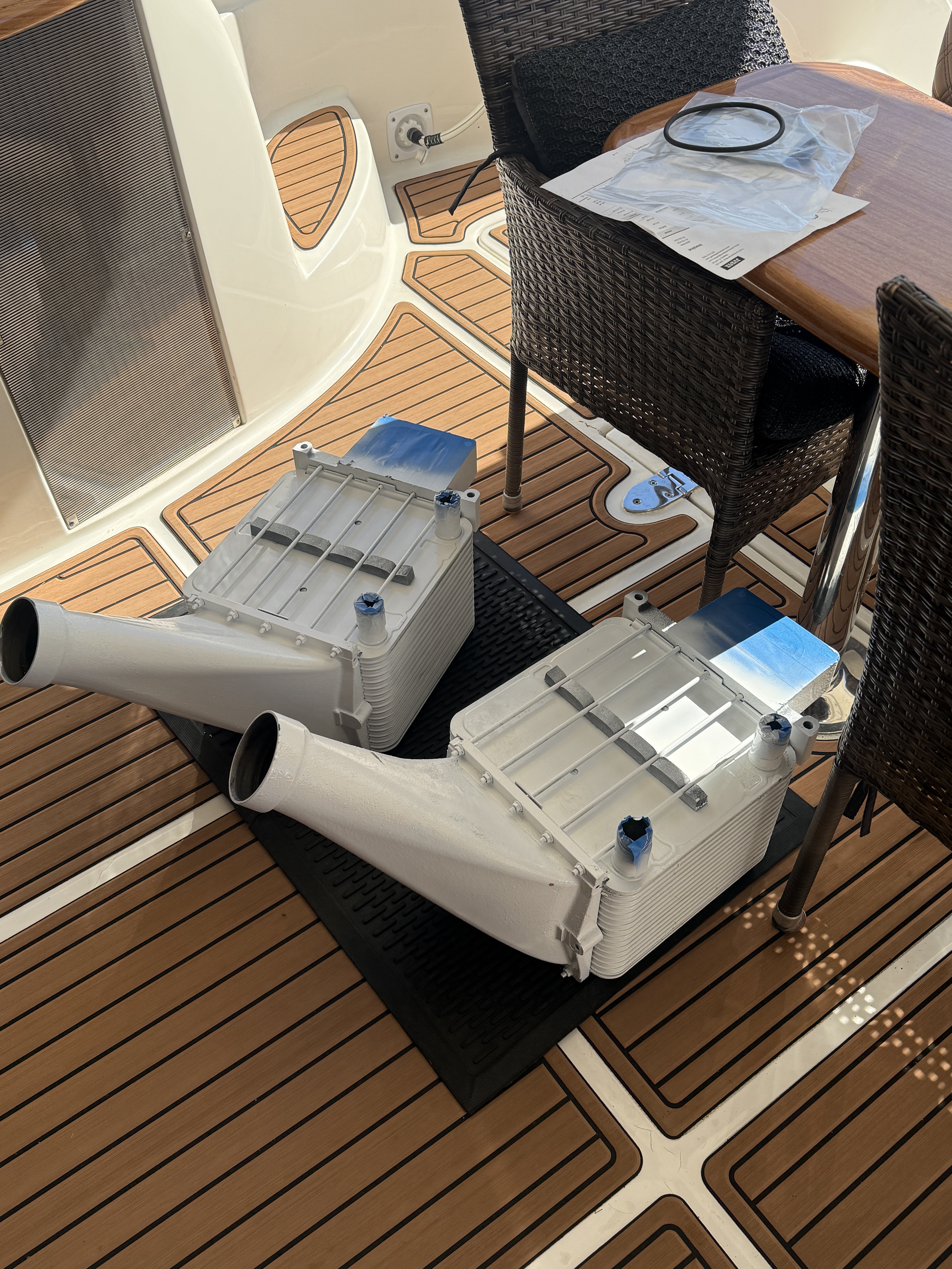

    Pic of the day:  Reinstalled my turbo intercoolers after having them acid-cleaned, pressure-tested, and repainted.  Woohoooo!
    I've been tracking that my turbo boost on the port side was down about 10% compared to the other engine.  I swapped the sensors and it didn't change, so that's a sure sign that the aftercoolers need attention.  The previous owner didn't keep great records, but I think it has been 1700 hours and almost 4 years since they were serviced.  It was time.

    Impressive as always. What did rebuild consist of?
    They take it apart and acid-flush the core to remove any calcification or oil from the cooling fins and coolant passages.  Then pressure-test to make sure there are no pinholes allowing coolant into the charge air.  Assemble and paint.
    The proof will come next week when we leave here for Ft. Myers and I can run her up on plane.  Should see the same turbo pressure on both sides, and better fuel numbers.
    Is it a separate cooling loop from the engine? I imagine it would have it's own seawater heat exchanger?
    The aftercoolers run engine coolant.  I'm glad they aren't seawater-cooled.

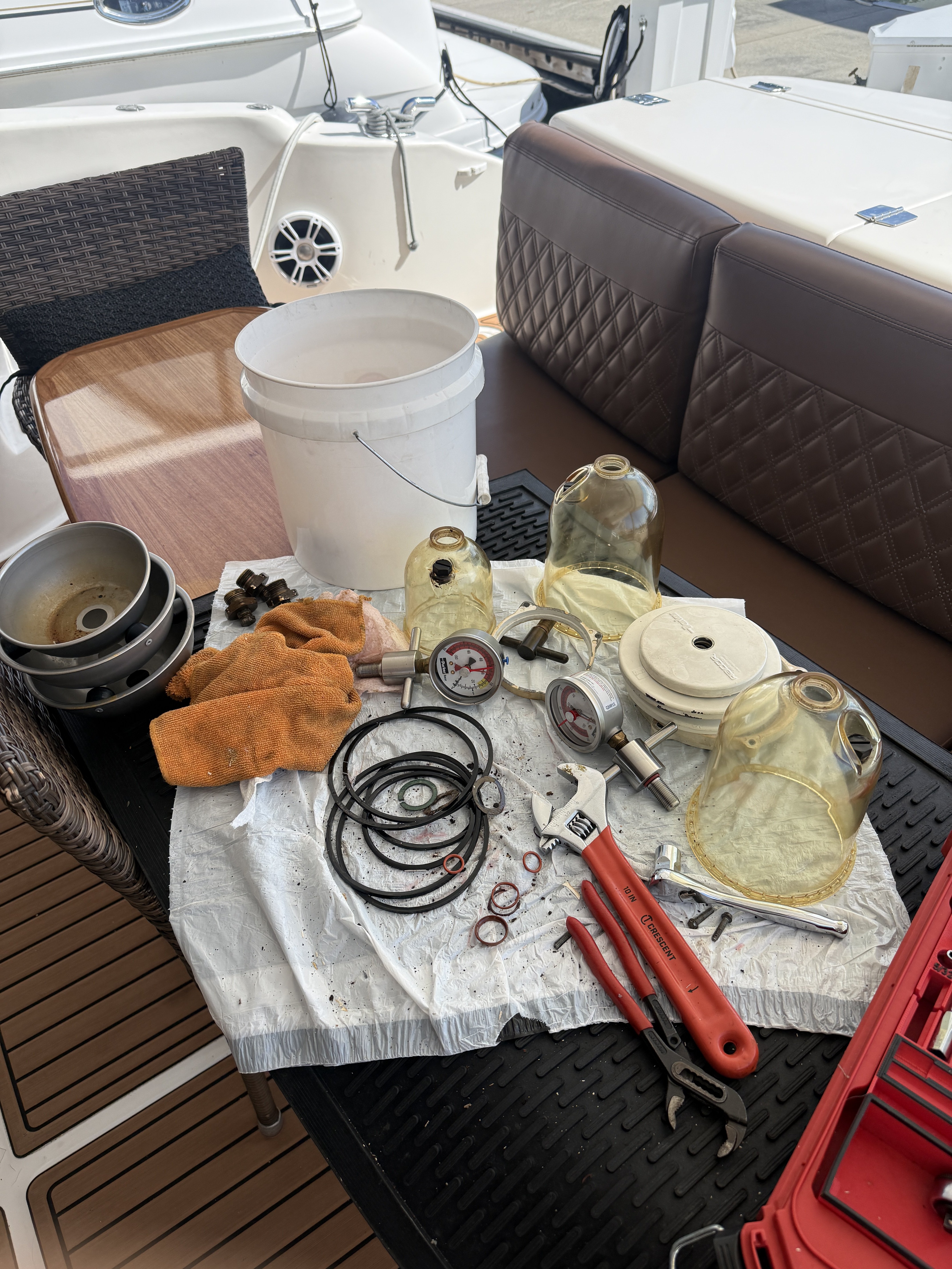

    Today's project - new seals and gaskets for the fuel filters.
