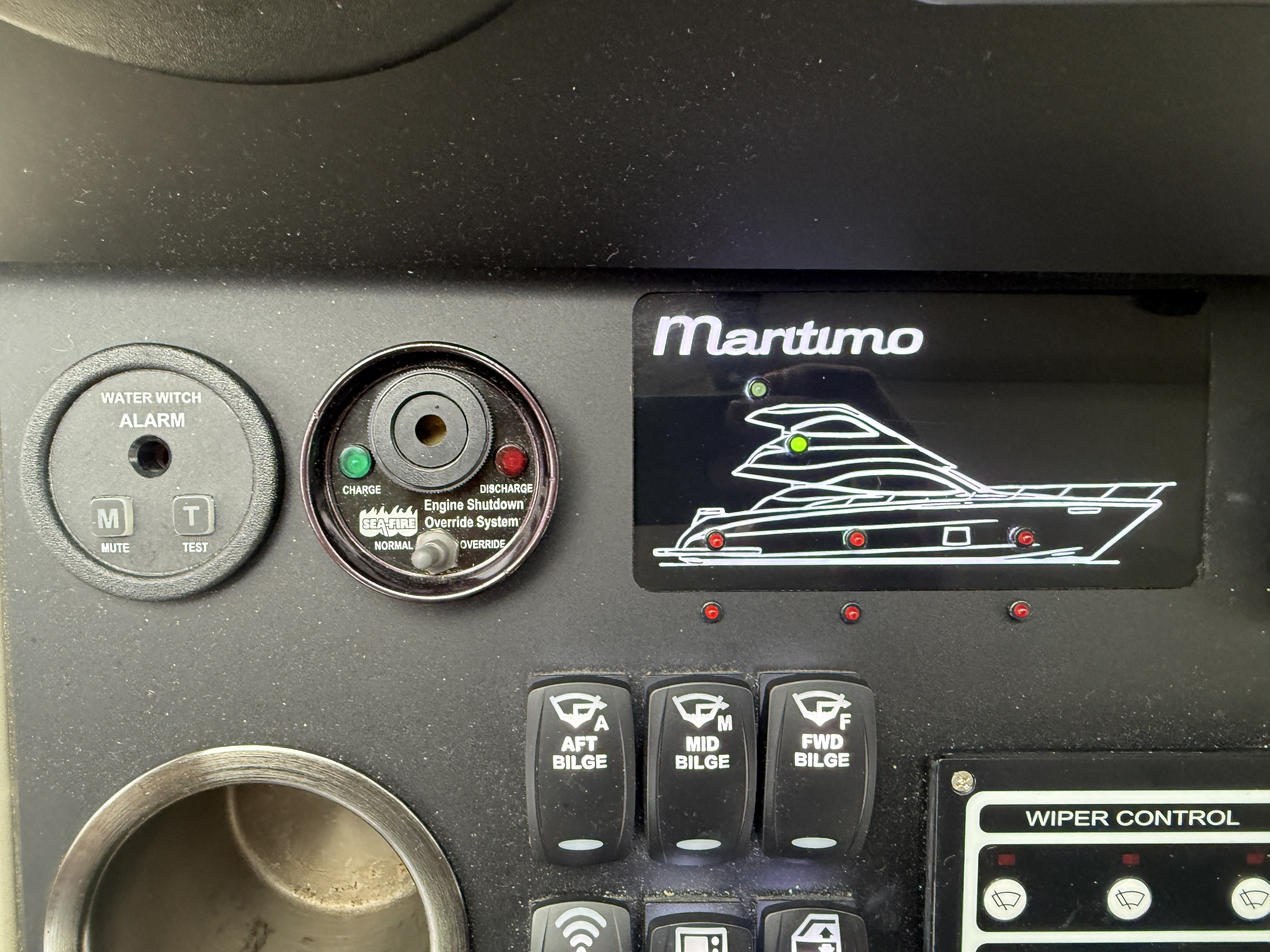

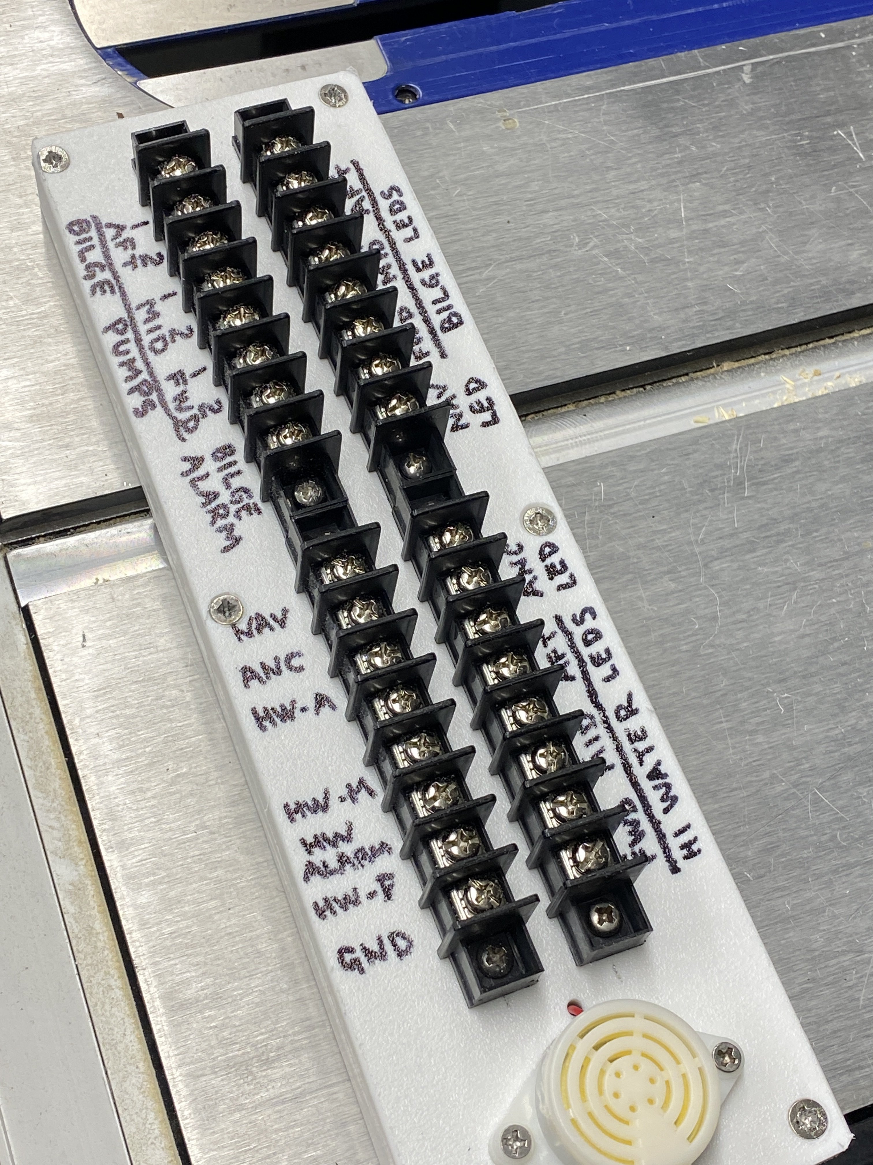

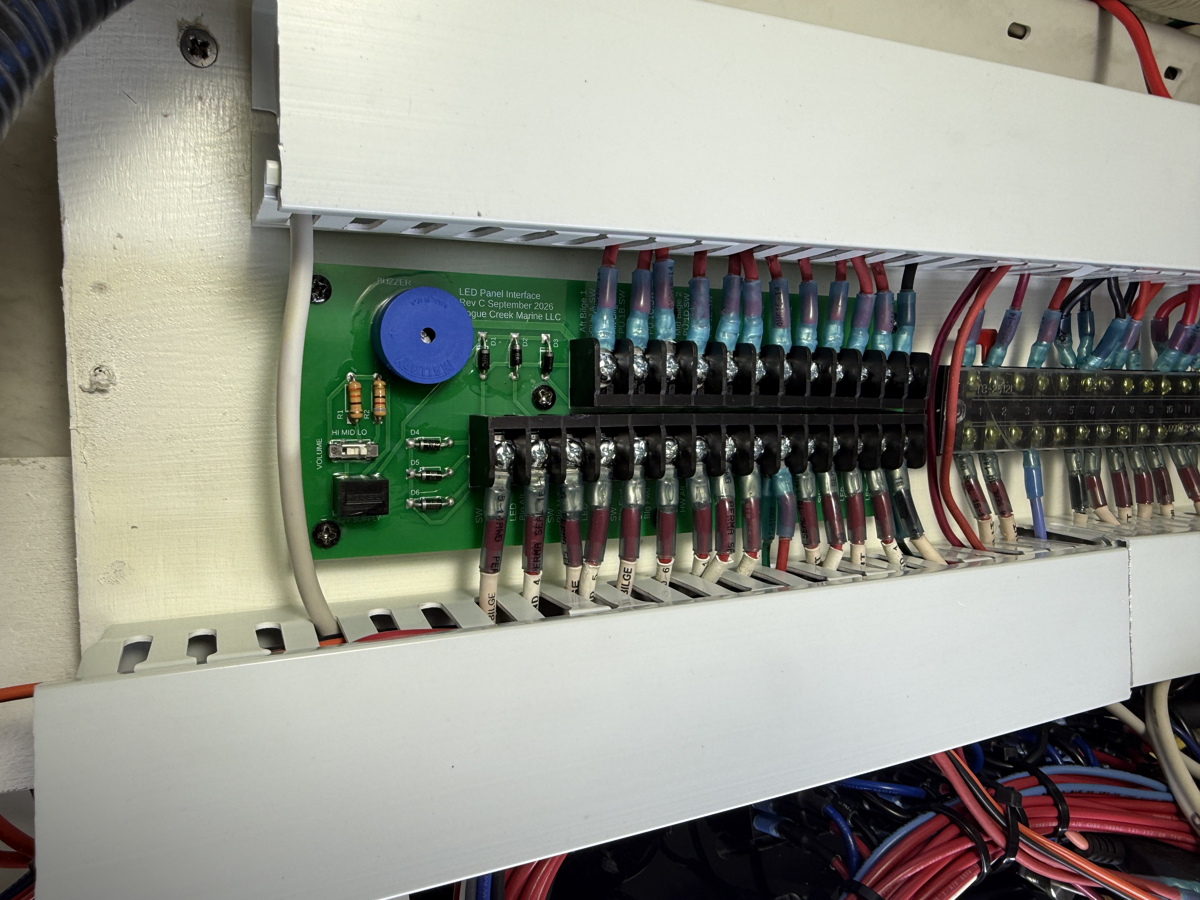

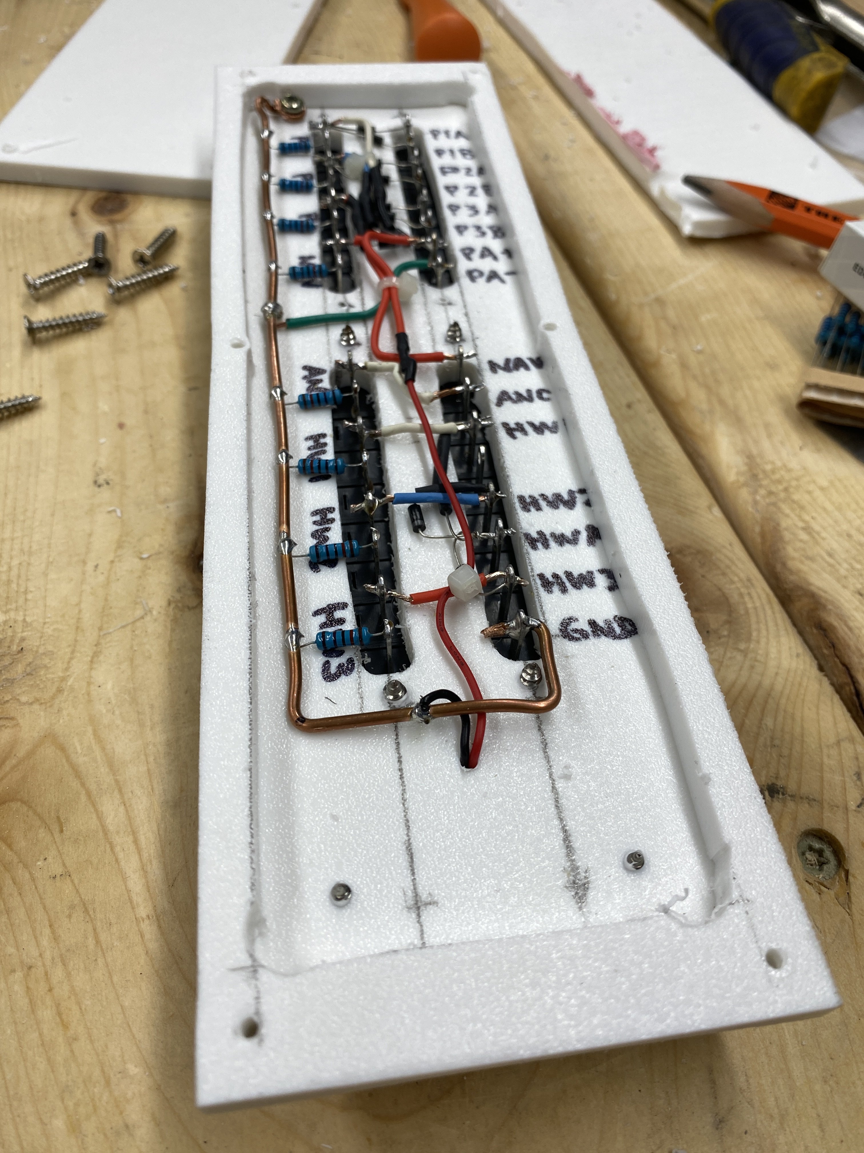

    Latest project:  rebuilt the helm switch/alarm interface, which controls bilge pumps, bilge alarm, nav/anchor lights, high water alarm, and indicator lights.
    Here's the prototype I built three years ago out of Starboard.  It worked perfectly, but it's butt-ugly.  I was worried that the appearance would cause too many questions if I ever sell the boat.
    Here's the replacement.  Better, eh?
    One of the things it controls is this custom LED display at the helm.  It has indicators for bilge pumps, high water alarms, nav lights, and anchor light.

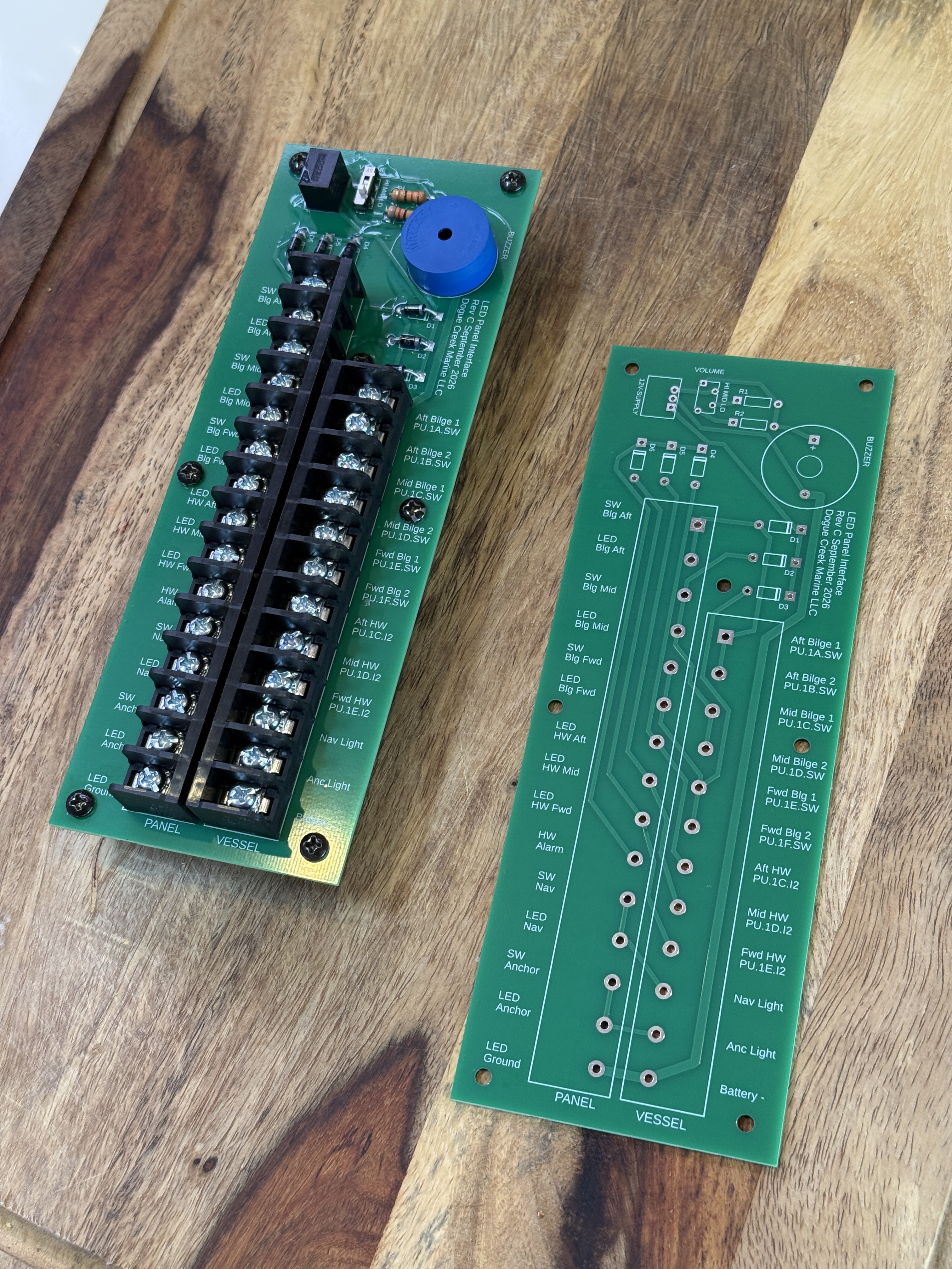

    This was my first time developing a printed circuit board, which is easier than you might think.  The software I used to design the board is Autodesk Fusion.  I uploaded the design to jlcpcb.com in Hong Kong, and they printed it.  Unsurprisingly, I botched my first attempt and had to print a second one.  Even with that mistake, the total cost was under $150.
    Even though this is a dead-simple board, it took me a while to figure everything out.  The engineers who work for me could have knocked this out over a lunch break, but I wanted to learn everything on my own.  It was a fun experience.
  • captkevincaptkevin Member Posts: 619 ✭✭✭
    looks amazing
  • FormulabenFormulaben Confirm Email, Member Posts: 242 ✭✭✭
    Dang, that's impressive!

  • grouch0jrgrouch0jr Member Posts: 287 ✭✭✭
    The PCB looks great. Do you have any concerns about exposure where it is mounted? Did the manufacturer have an option for conformal coating?
  • LaReaLaRea Member, Moderator Posts: 8,085 mod
    It's in a protected area under the helm, so no exposure worries.  They do have options for conformal coating if you're paying them to assemble the board, but I didn't do that.  I bought the parts and assembled it myself, then applied a brush-on coating on the components and exposed solder joints.
