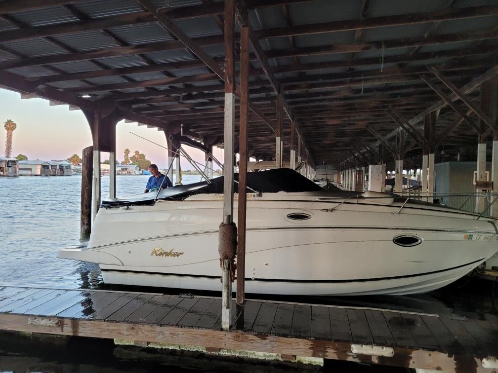

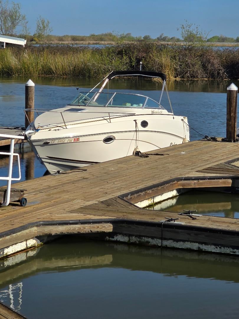

    Thank you! This is a 2002 Rinker 250 Viesta Vee. Bought it new w/upgraded 350 Mag / Bravo 3. Stored all these years on it's own lift at a vacation home. 315 hours on original engine.

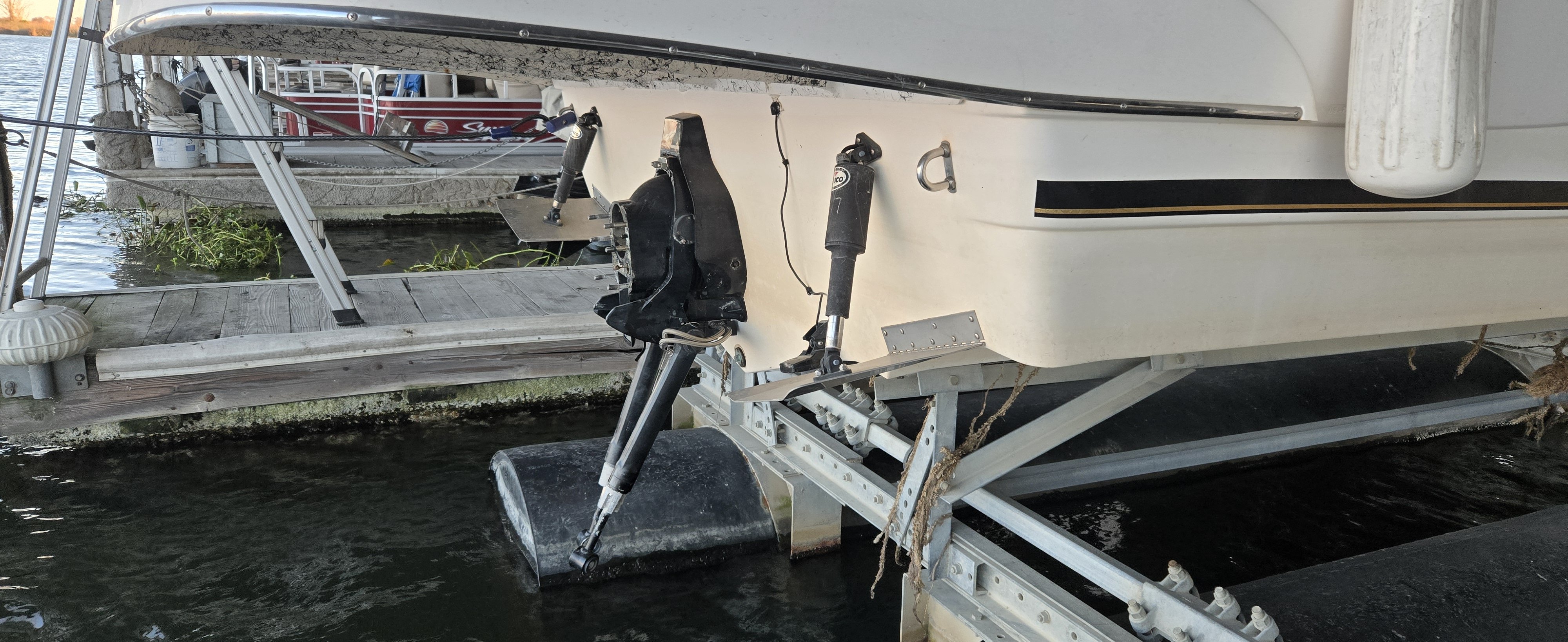

    New OEM with 2 props is quoted at $15.5K. That assumes they did no other damage when removing it. My new challenge that I am looking for suggestions. The boat is up on a lift over the water. It now has a large hole where the outdrive was removed. I need to have this towed from my dock to the marina. When I drop the boat into the water it will take on water, into the engine I think. BoatUS towing is saying I need seal this hole before they will attempt to tow it. Any suggestions on sealing this hole well enough that the engine/boat doesn't fill with water and sink the boat? Also note Geico insurance covered zero cost due to depreciation and deductible. THANK YOU ALL - you have been the only positive part of this terrible experience.

    That sucks on the insurance deal. Maybe you can get some kind of plate to bolt over the hole to seal it to move the boat

    What's the distance it needs to be towed? I agree about a plate.  Tows are usually fairly slow, so no worries about something ripping off under speed. So what about a 1/4" aluminum plate templated to the outdrive shape and stuck on with the bolts and some 3m 4200?
    Since you're on a lift you can test the water tightness of your plate before towing. Just dip it in to see if it takes on water. And make sure your bilge pumps are powered up - and/or have the tow operator put one of their dewatering systems in place just in case it's needed on-the-fly.

    Does SEI make a B3 replacement? I don’t see one on their website. I would think an aluminum plate would be your best bet. Good luck and keep us posted.
