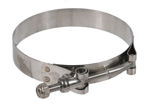

    I'm sick of worm gear hose clamps.  Next time I have to mess with a pump, I'm switching over to T-bolt clamps.  Solid band, with no jagged edge sticking out to form a skin-tearing hazard.
    Hardin seems to have good prices.  There are many other sources.
    https://www.hardin-marine.com/p-105-superduty-stainless-steel-t-bolt-band-clamps.aspx

    Those are nice clamps
  • LaReaLaRea Member, Moderator Posts: 8,083 mod
    These guys have pretty good prices on T-bolt clamps.  No small sizes though.  @GeorgeA you listening?   :)
    https://fatboyboatsupplies.com/products/ideal-hose-clamps-ss-t-bolt-hose-clamp?_pos=1&_sid=e2599982c&_ss=r

    Ultimately, I want to replace every hose clamp in my engine room with T-bolt or something like it.  But I'll start with the sea water pump in/out hoses (Merc 496).
