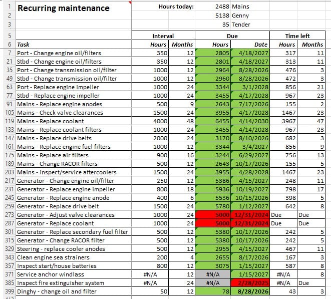

    I'm also a big fan of using spreadsheets to organize my tasks and notes. Some things I have just lumped into general "winterizing" and "commissioning" lists. Does LaRea stay in the water year round?
  • LaReaLaRea Member, Moderator Posts: 8,078 mod
    Yeah, no more winterizing for me.  We go south in cold weather.
    I always winterized the Rinkers, so most of my maintenance was annual and I didn't need to track it.  I did track impeller changes and water pump failures, especially after I started having issues with the Hardin pump bearings.  I also tracked repairs, but not like what I'm doing now.
