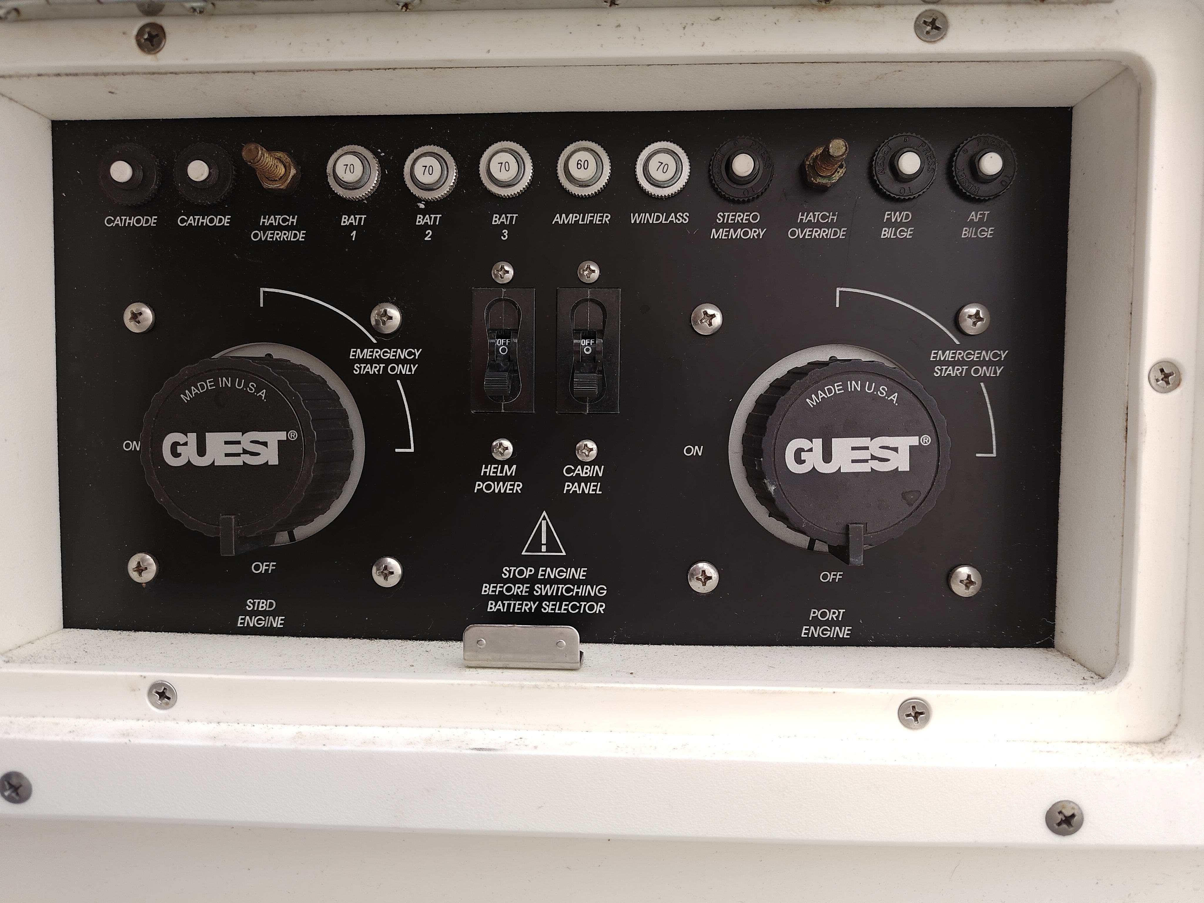

    I bought a 50 amp MRBF (based off the JL Audio specs) for powering the amp. Is it worth considering terminating my power cable at the aft breaker panel? The existing breaker is 60 amp. Or am I better off just connecting directly to the battery?

    LaRea, did you determinate the original power wiring at the breaker panel? I'm concerned about leaving that abandoned wire hot.

    I didn't cut the cable to length at the battery side, yet. I still want to see if I can find a way to terminate it at the battery breaker panel. I feel like that would be a much cleaner, factory-style install.
