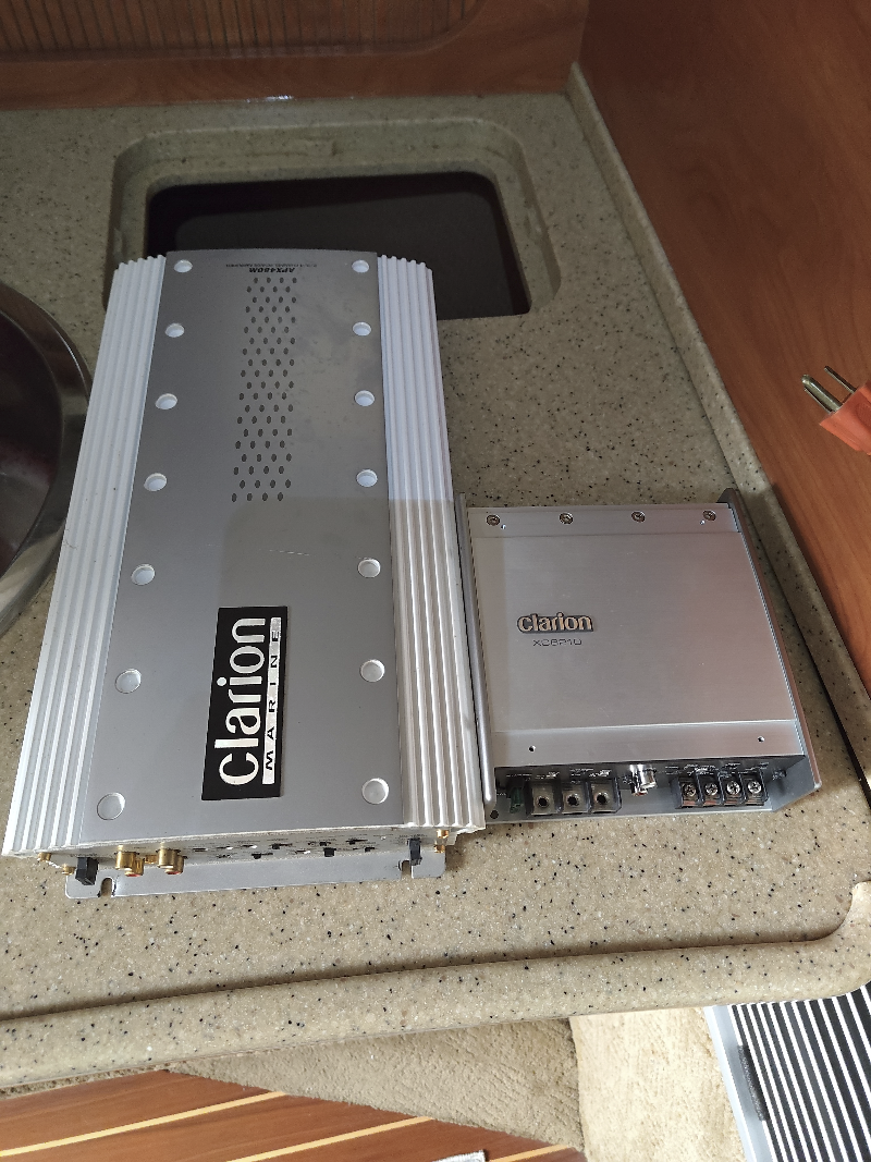

    I finally pulled my old amps today. One thing that surprised me is that each amp had its own wire for the Remote signal, 2 blue wires coming out of the wire loom. They were also jumpered together. This makes me think one is coming from the stereo, and then the other is going somewhere else. Anyone have any insight on this?
    Edit: I also looked at schematics for a 2004 342FV (found elsewhere in this forum), but it didn't show the Remote signal at all.
  • PickleRickPickleRick Member Posts: 4,402 ✭✭✭✭✭
    A single signal wire, spliced to make two different wires (one to each amp), coming from the head unit would be the correct set up.
