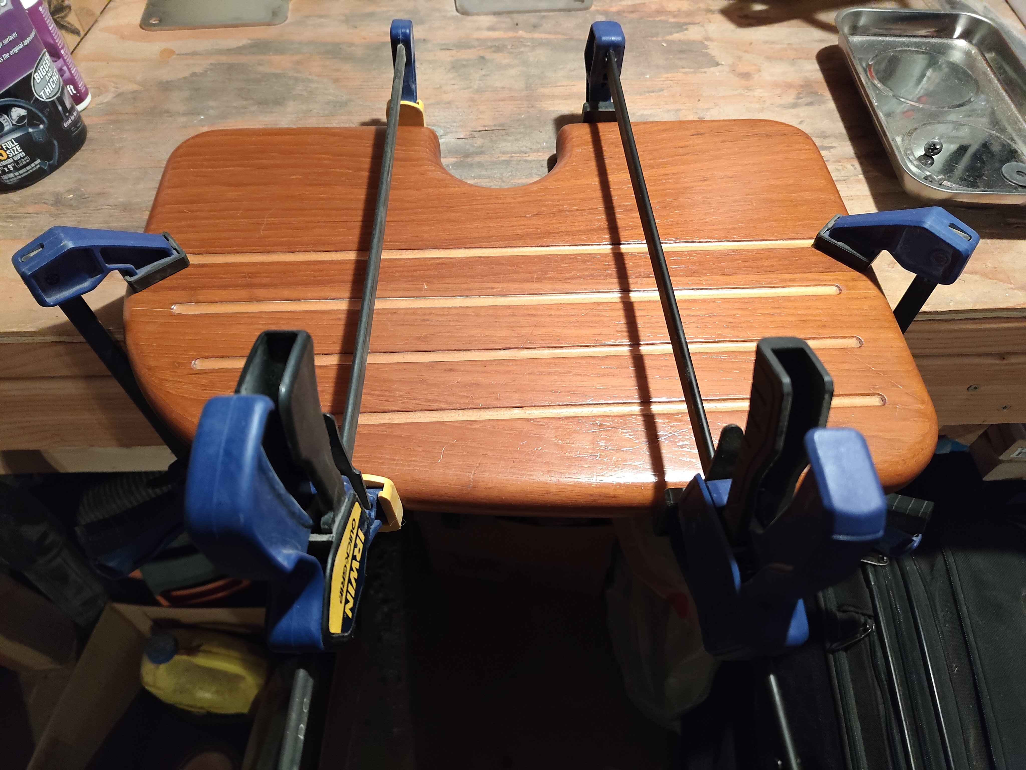

    Someone took a spill on my steps, and the middle one cracked. It didn't break all the way through, but it definitely would bend when stepped on. So I spread it open, glued it, and clamped it up. Much more rigid now.
    2006 342EC

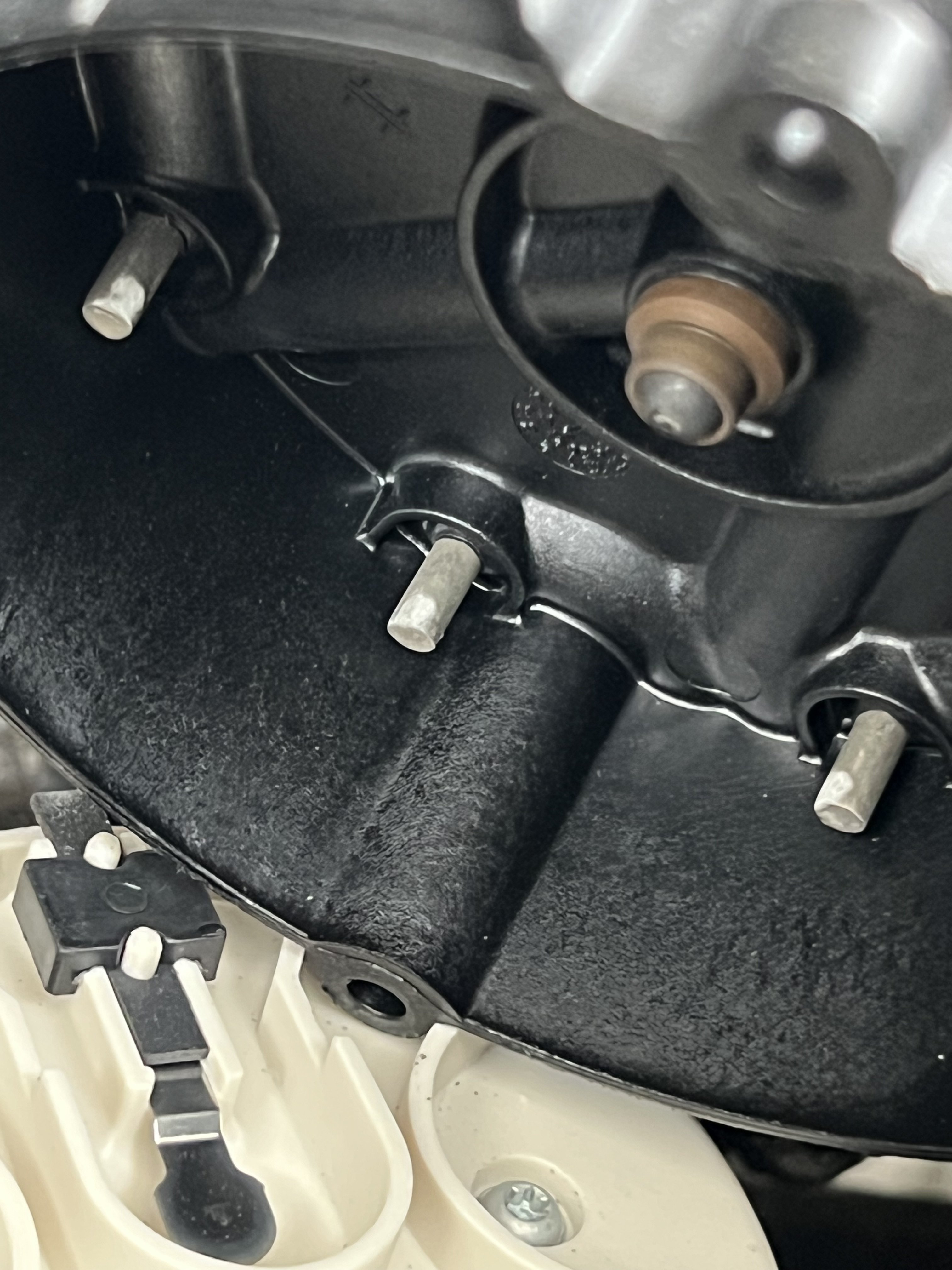

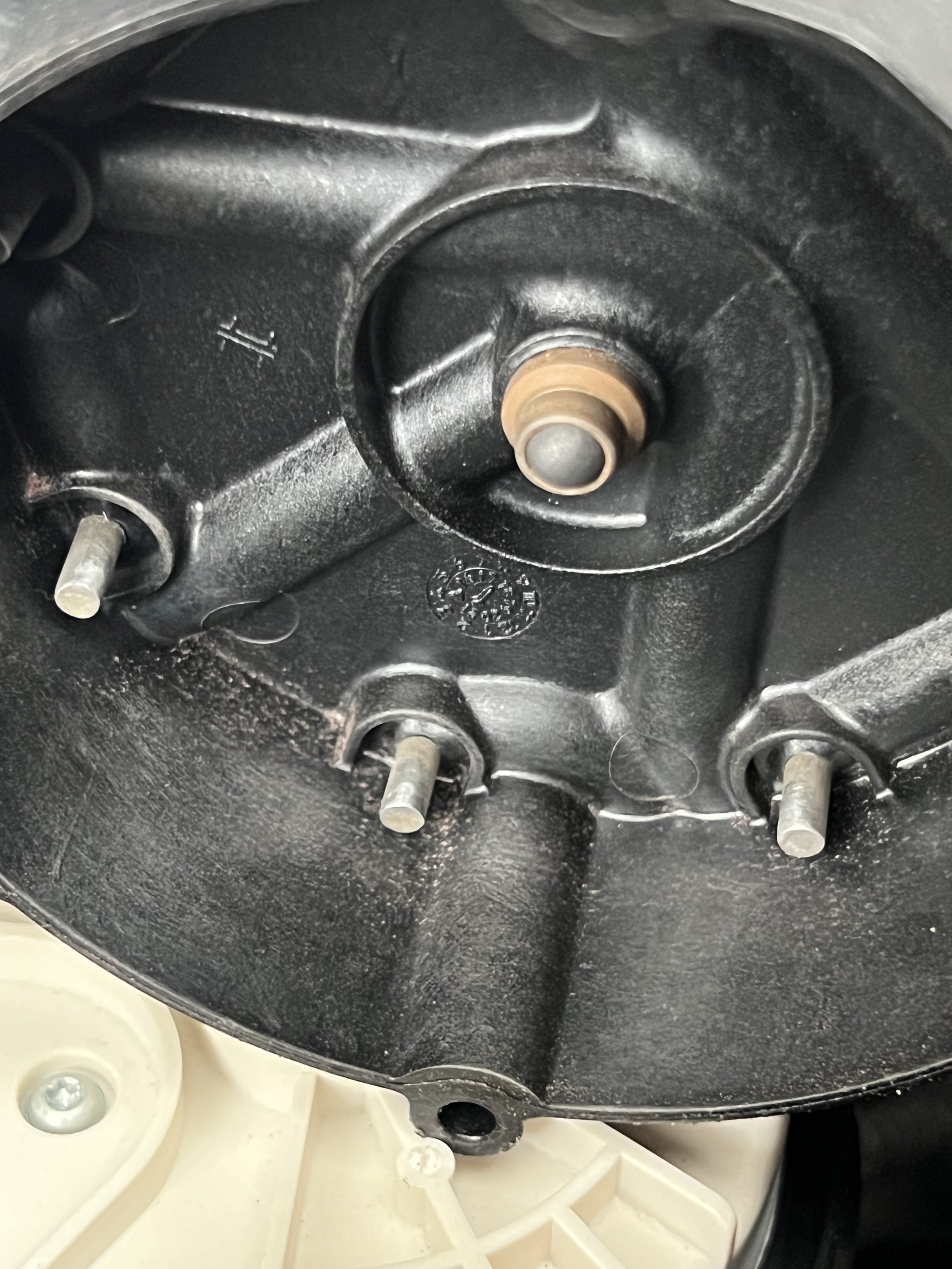

    So the issue with my port engine only going to 4000 RPM’s is back. I changed the fuel filter and no change. I did notice that my port battery is dead. Couldn’t even crank it. I can crank the port side once the starboard engine is started. I shut down the starboard engine once the port started, she stayed running and the battery showed around 13-14 volts on the gauge. So I guess the alternator is working on the port side. Could a dead battery cause a loss of RPM even though the volt meter looks normal when running?
  • YYZRCYYZRC Member Posts: 5,356 ✭✭✭✭✭
    I had that issue a few years ago and it was a bad plug.
  • aero3113aero3113 Member Posts: 9,556 ✭✭✭✭✭
    @yyrc I replaced all of the spark plugs at the beginning of the season. Do you think one could go bad that quickly?
    Unlikely I would think. I would start with swapping wires and then cap/rotor between motors.
    @YYZRC !!

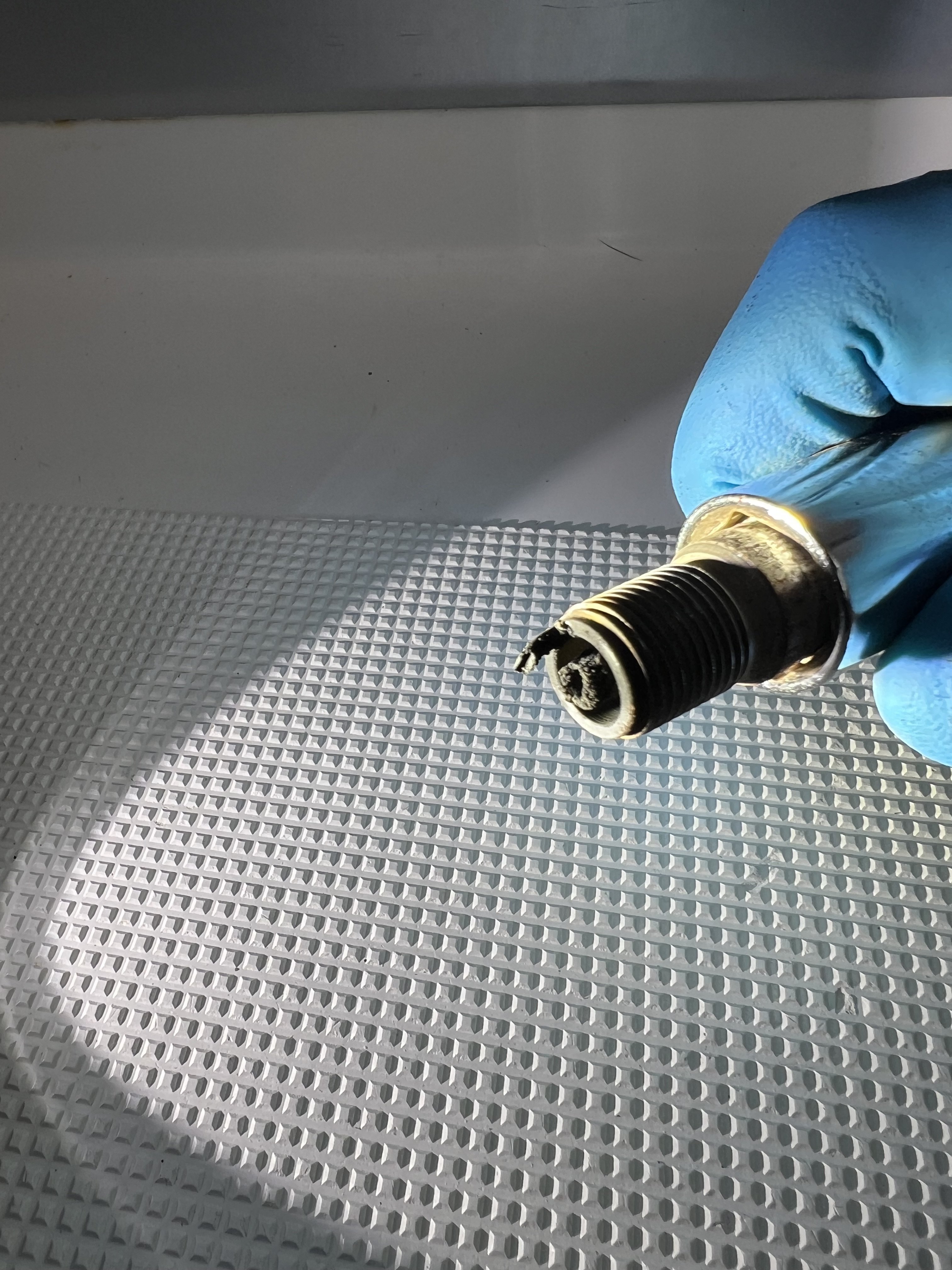

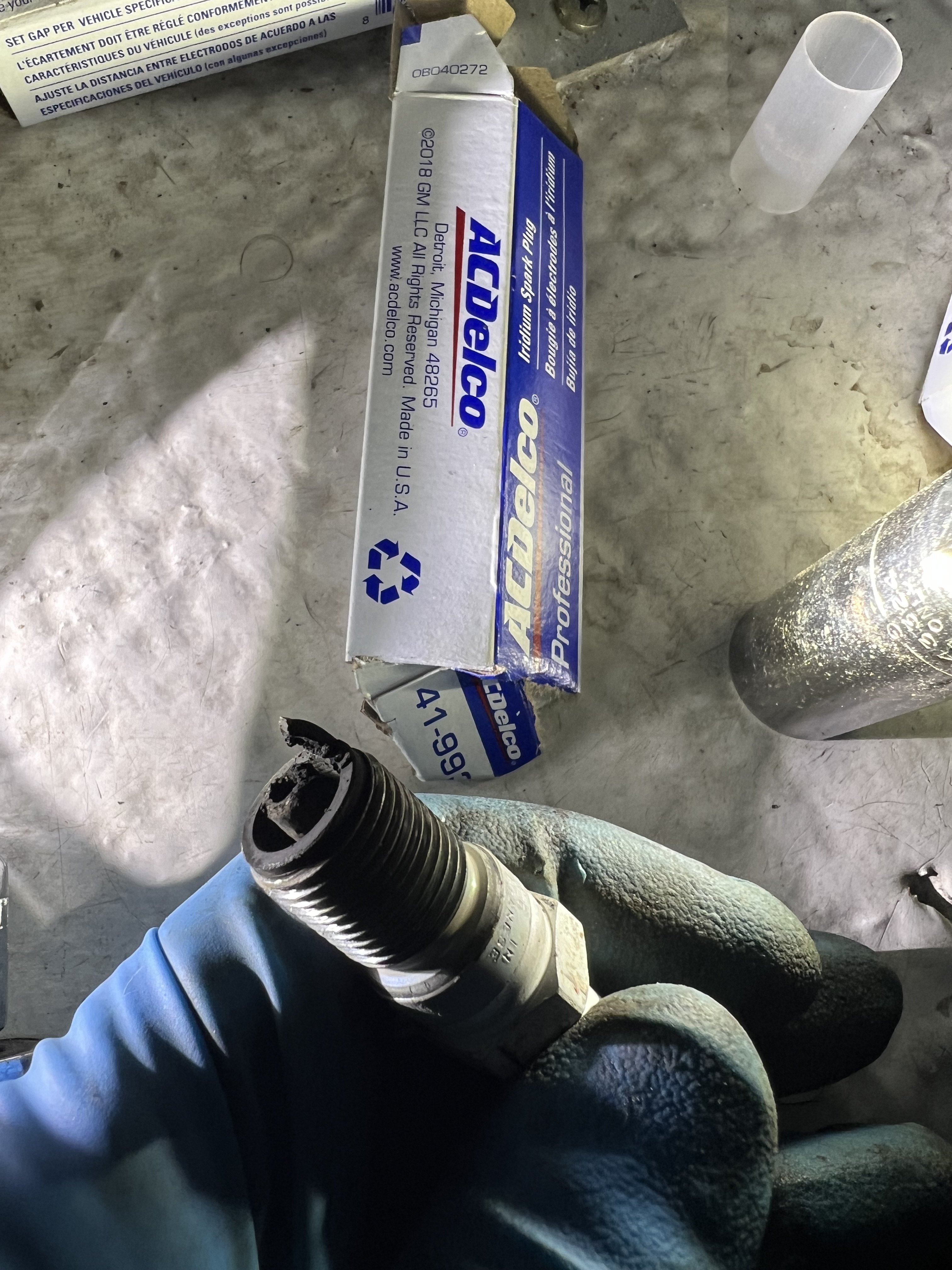

     I wasn’t going to be able to sleep tonight so I went and worked on the boat. We’re taking my brother-in-law and sister-in-law out tomorrow and our niece and nephews. I wanted to make sure all was good.
    #1 and #2 spark plugs!!
    not sure how this happened, maybe counterfeit plugs?? I didn’t take her out for a run, just started her.
    edited August 9
    WOW! That's wild! Are you worried about the missing pieces scoring the cylinder walls?
    I’m hoping they eroded and burned off or went out the exhaust valve.

    I hope your trip went well but looking at the pictures about the lucky- something happened to burn those plugs like that...
  • captkevincaptkevin Member Posts: 419 ✭✭✭
    Wondering if it would be a good idea to change oil & check for missing pcs
  • PickleRickPickleRick Member Posts: 4,217 ✭✭✭✭✭
    edited August 11
    Plugs usually look like that due to pre-detonation, excessive heat or lean running condition.
    Probably would be a bad idea to remove them and to see what coloration they have before another run.
    You monitor your temps like...a pilot.  Probably safe to rule out any overheating although raw water cooled engines tend to run less overall balanced temp wise vs closed loop.  I think the most drastic temp difference is #8 but my memory is fuzzy.
    Anyway, possibly catch onto an issue, if there is one, before it becomes a major issue.
