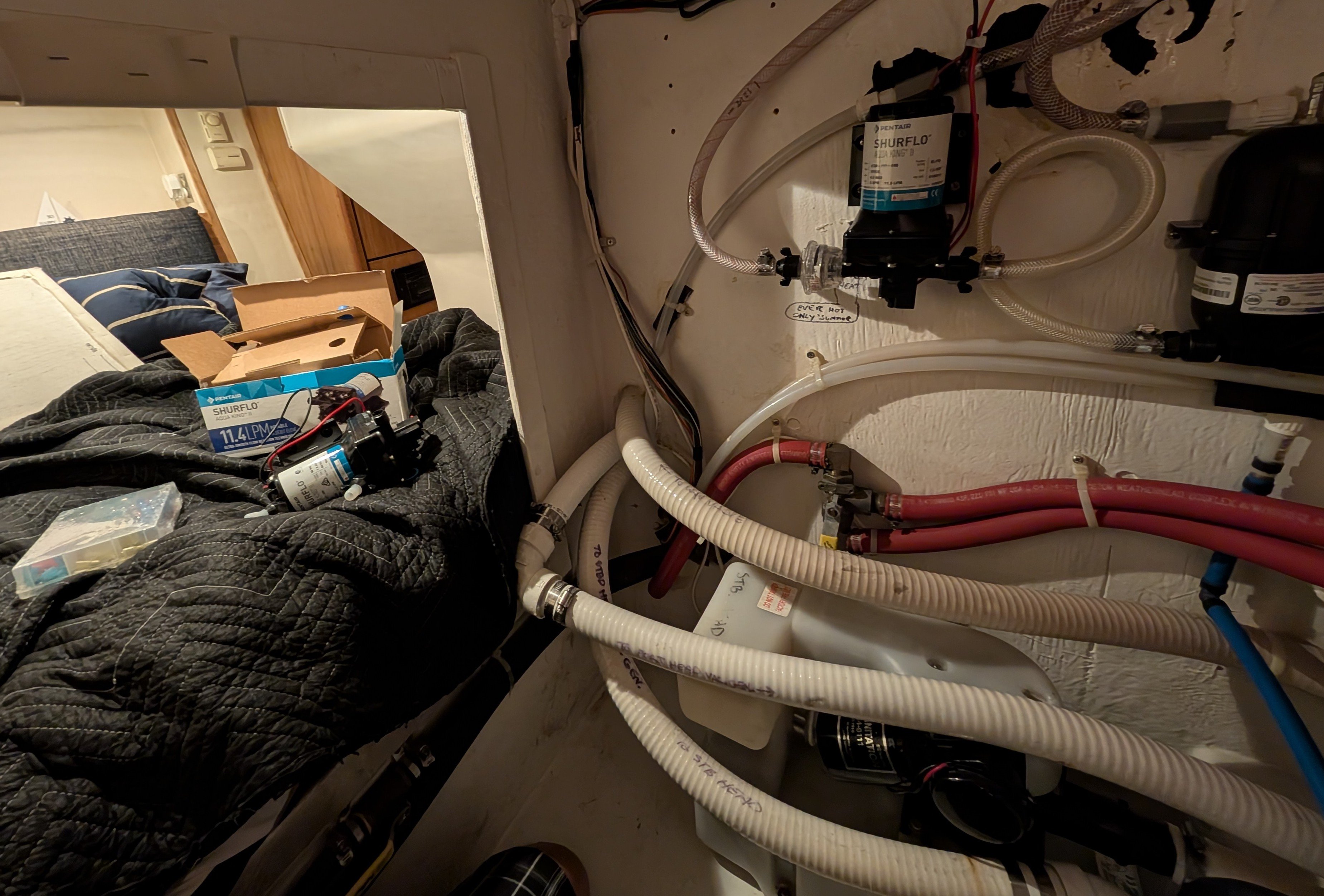

    I replaced my water pump after it failed, it apparently lasted 10 years according to the manufacturer date. The new one is the same pump but it's significant quieter. This was so much easier than my 280 pump, that thing was jammed way in there on the firewall.
  • LaReaLaRea Member, Moderator Posts: 7,890 mod
    10 years!!  Congratulations ... I've never had one last longer than 3 years.  On my current boat cruising full-time, I've replaced two in two years.
  • Aqua_AuraAqua_Aura Member Posts: 2,677 ✭✭✭✭✭
    When I told my wife that it was 10 years she said that's not very long. But I know all the stories of them not lasting. I may buy a cheap one as a spare just in case we are at anchor and have an issue, I also changed the wires to quick disconnect for that reason as well.
