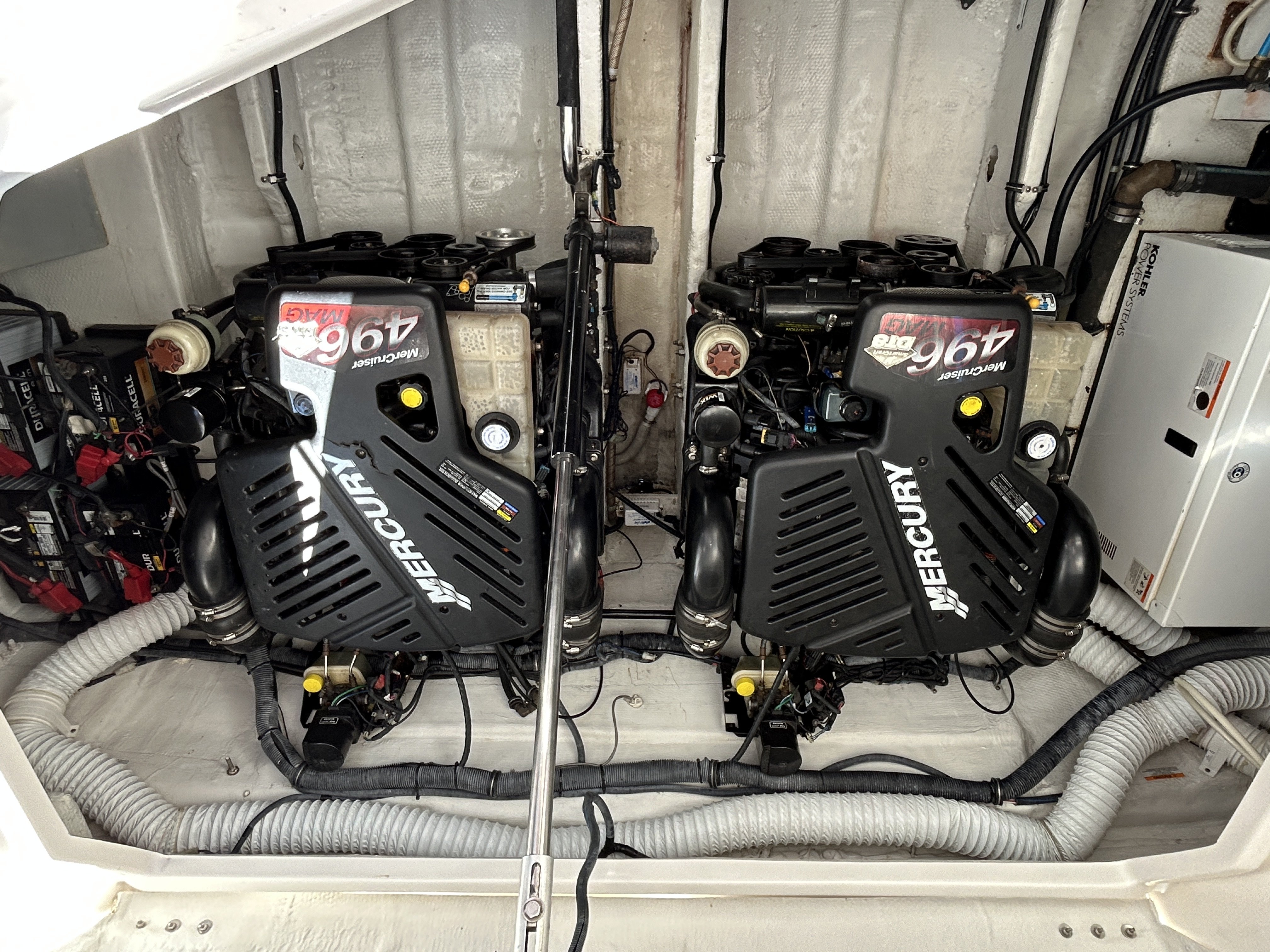

    Well, I began my cleaning for (winter).  Engine room is done.
  • rasburyrasbury Member Posts: 8,678 ✭✭✭✭✭
    Last time I submitted a photo for an issue down there i rec'd less than supportive comments. Maybe it's a fl thing but I can't get it clean to start with.
  • FormulabenFormulaben Confirm Email, Member Posts: 175 ✭✭
    If I ever have to pull the engine I'll certainly paint the bilge, as mine looks rough when clean too. They used some kind of splatter to give it a texture/look with black splatter on off-white paint.  And while it might make a slightly dirty bilge look nicer, it just never looks clean at all.
