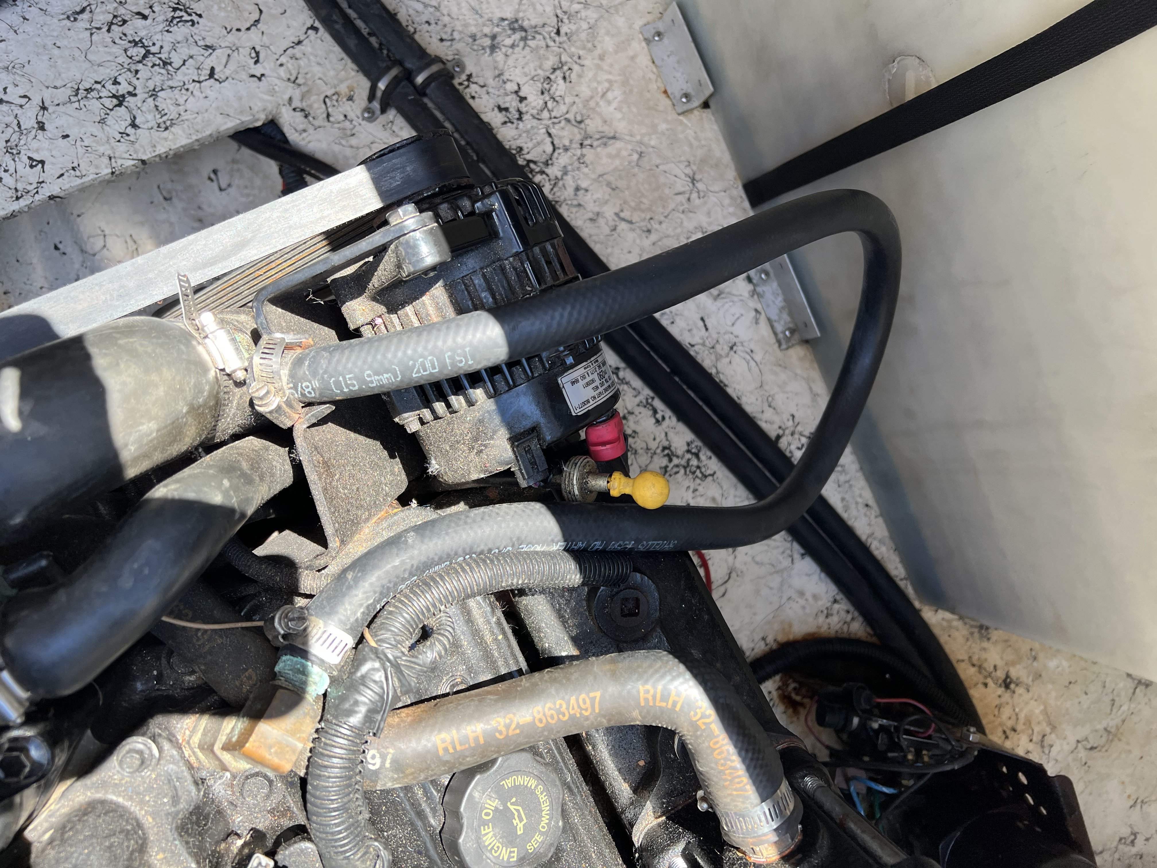

  • Pat310Pat310 Member Posts: 603 ✭✭✭
    This is how i bypassed my engine water heater loop
