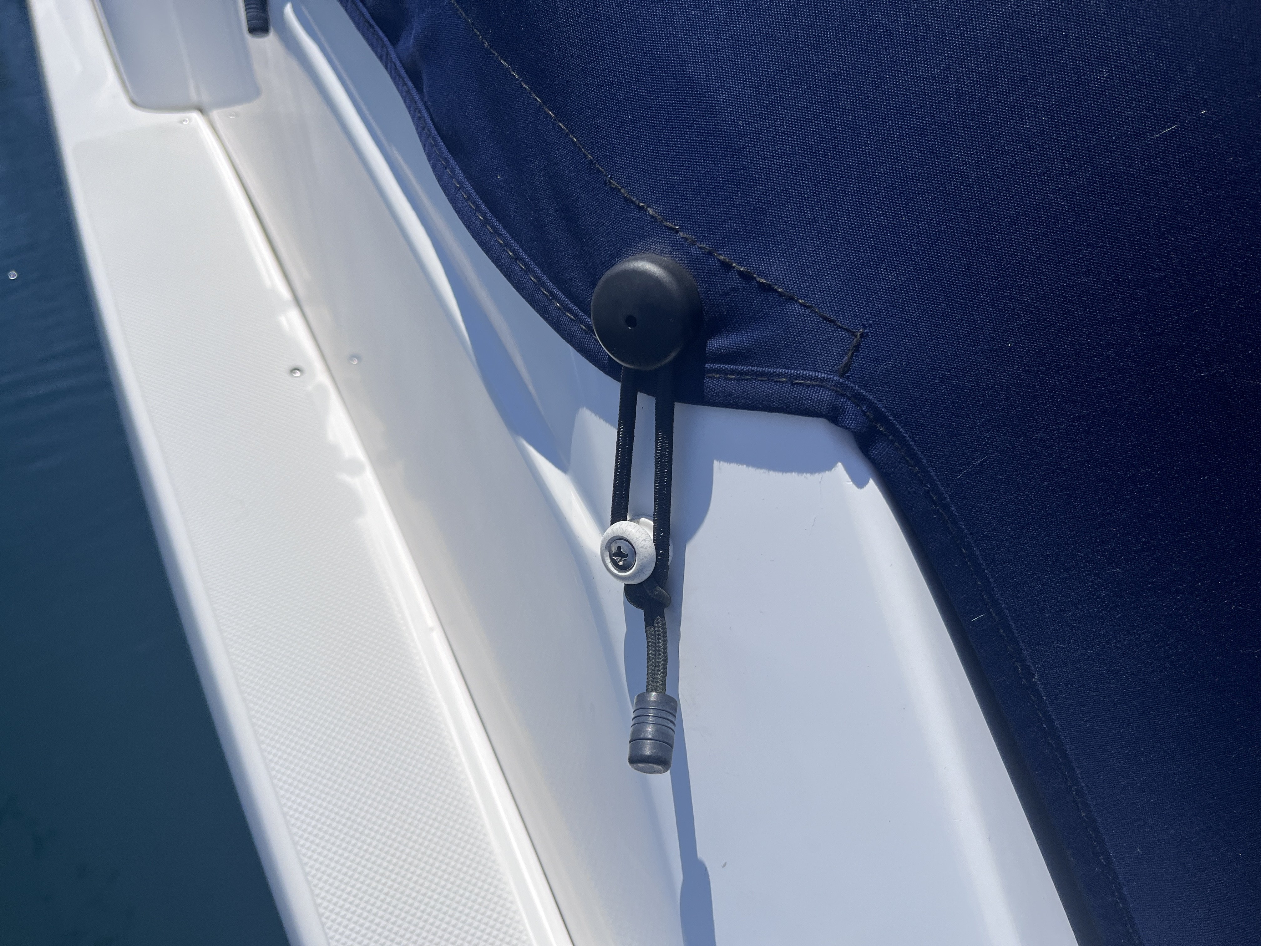

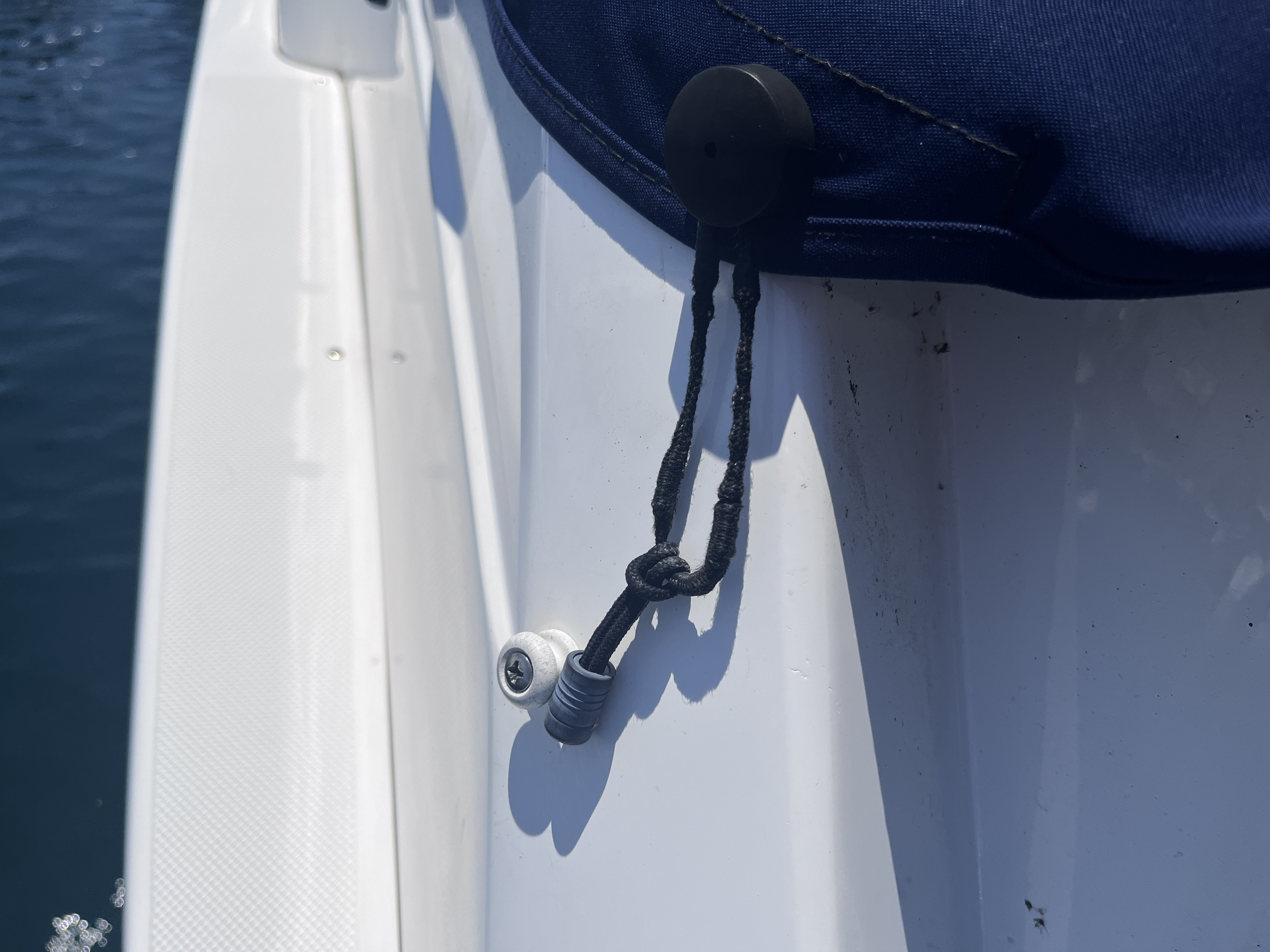

    Replaced a bunch of worn out Stayput fasteners...

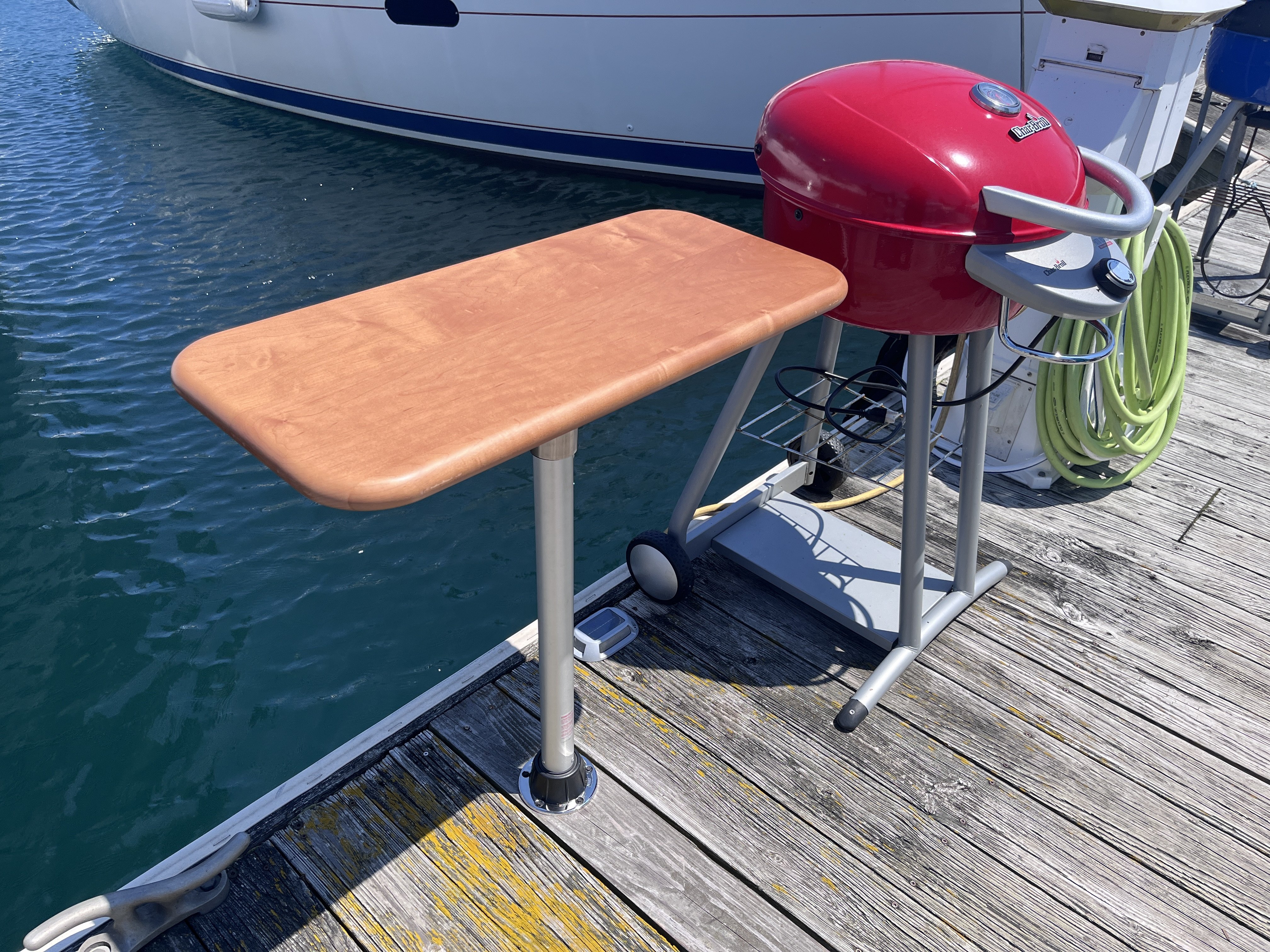

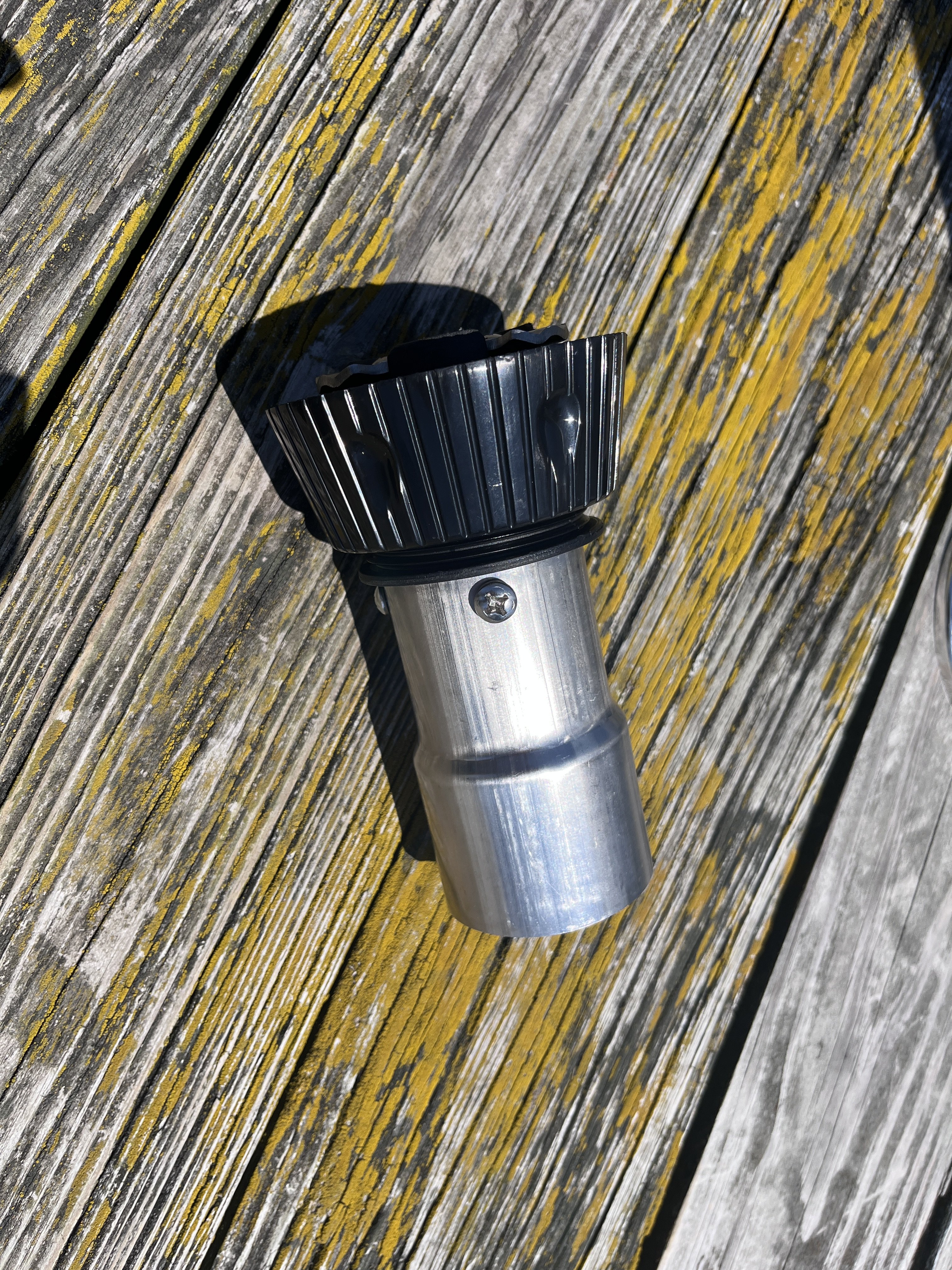

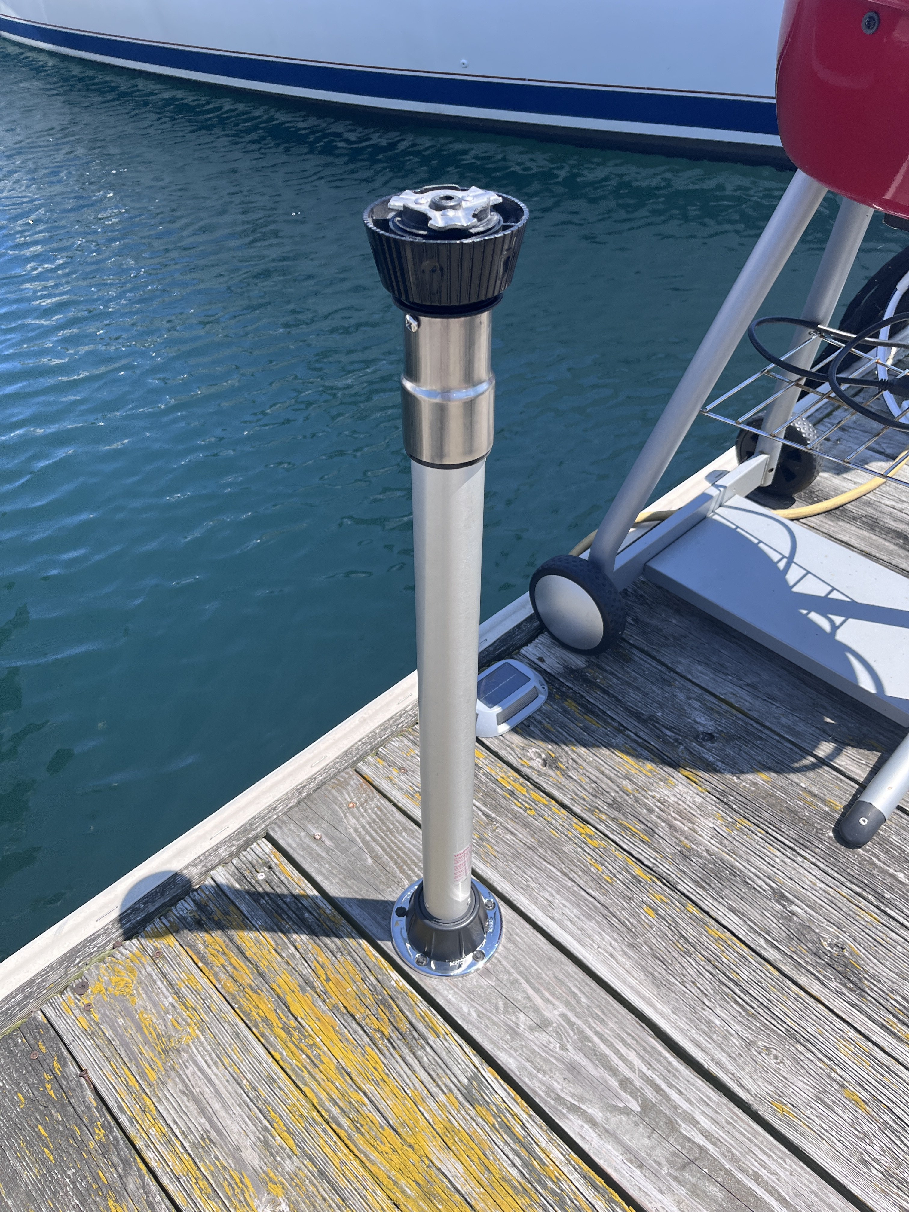

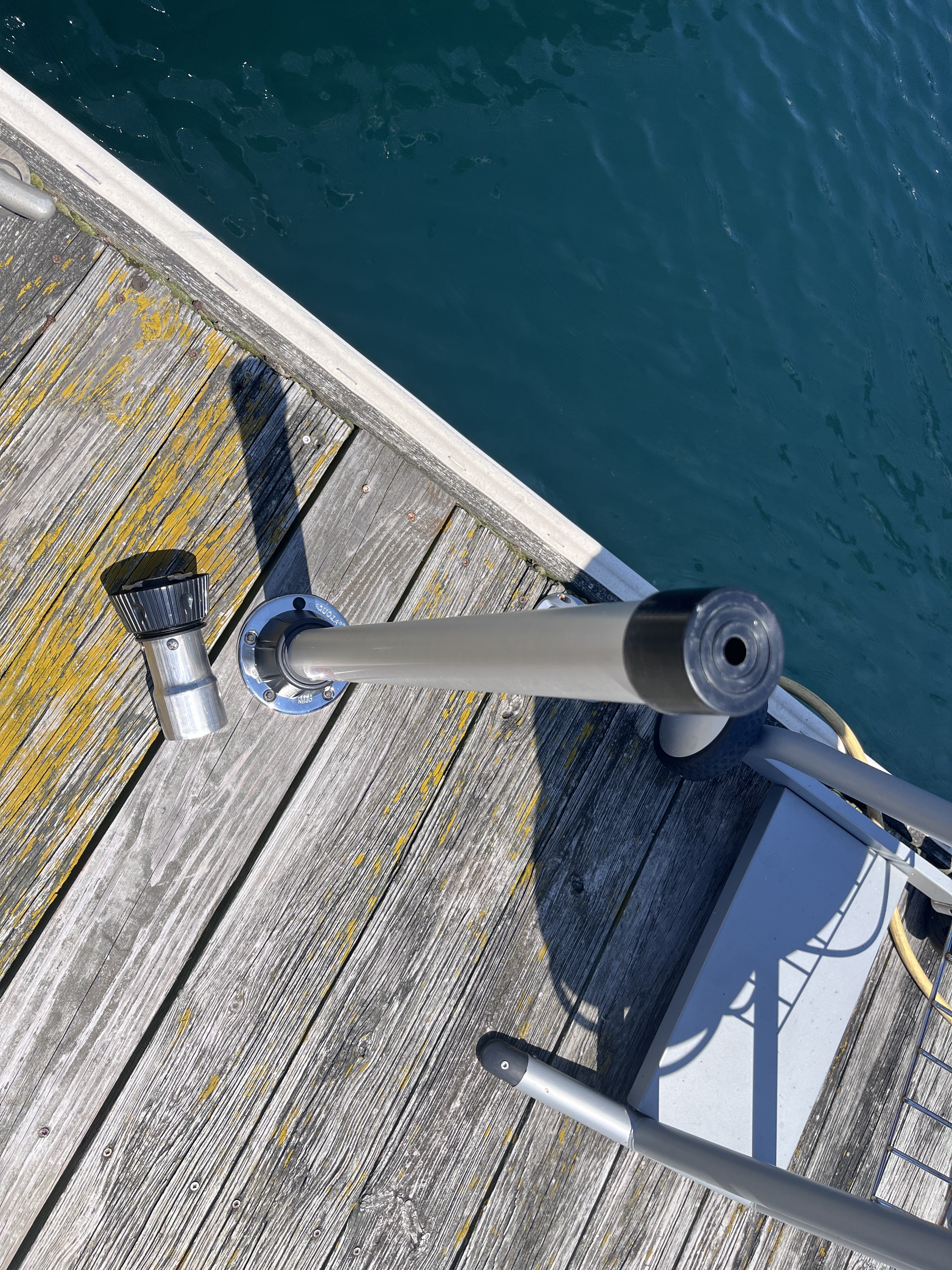

    With a few spare parts laying around made an adaptor which converts my galley table into a dockside table...
  • grouch0jrgrouch0jr Member Posts: 249 ✭✭✭
    Love the multipurpose table
