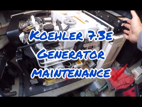

    Good video of all the maintenance items, this is on the 7.3e but close enough.
    https://youtu.be/GRUm3DZcuzs
