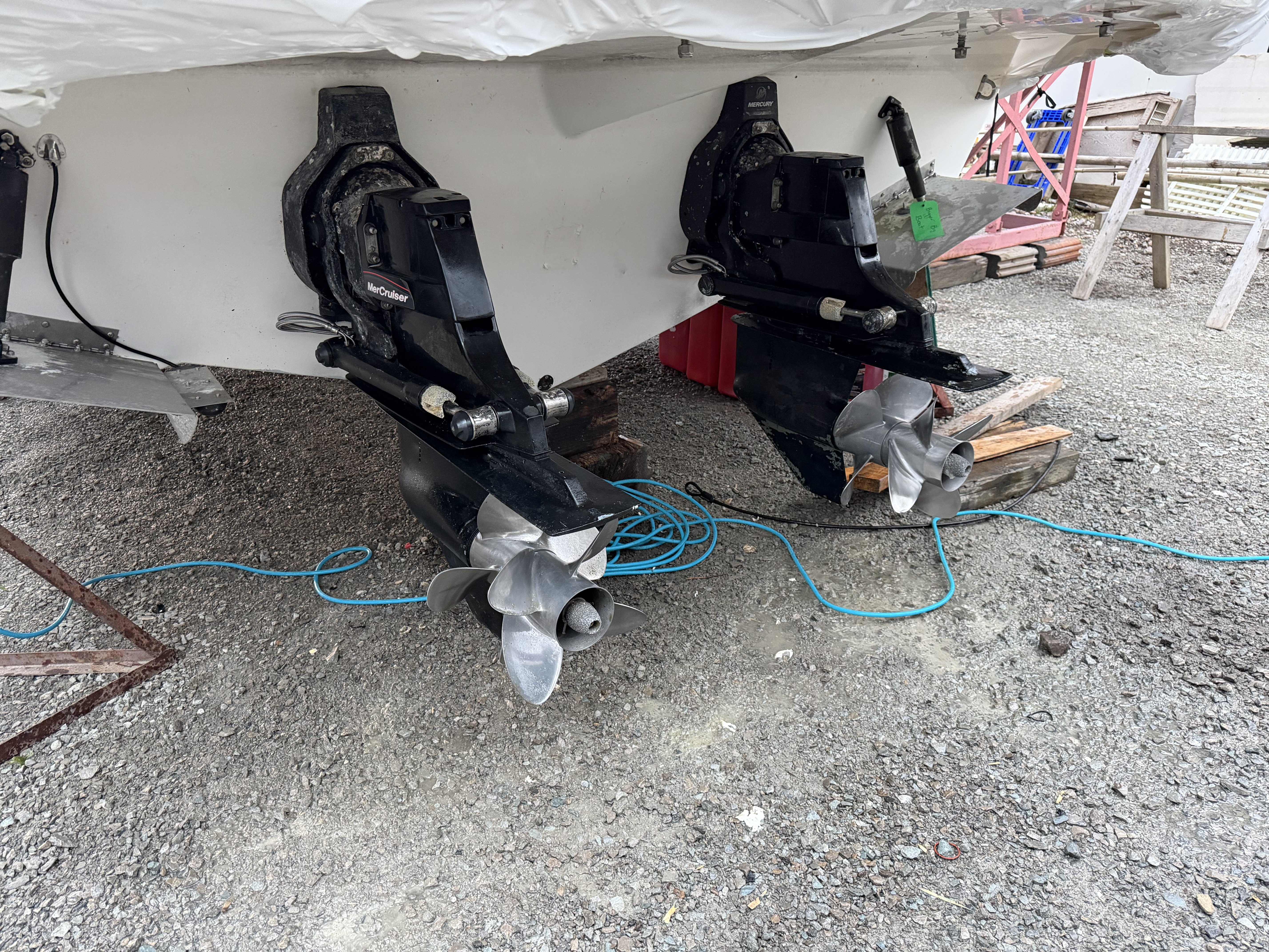

    Love clean props!
  • aero3113aero3113 Member Posts: 10,085 ✭✭✭✭✭
    Me too!! ⚓️
  • kordokordo Member Posts: 251 ✭✭
    How did you clean them and what happened to your bottom? I thought you started painting it.
  • YYZRCYYZRC Member Posts: 5,586 ✭✭✭✭✭
    Spray on muriatic acid and rinse after the bubbling stops. 5 minute job.
    Bottom is painted. I didn’t paint the transom.
    I had some luck with white vinegar on my props but I had to remove them and soak them, your method is easier.  My boat is coming out of the water this week and like you I painted just the bottom.  I suspect I'll have a lot of zebra mussels on the transom.  Did you have any?
