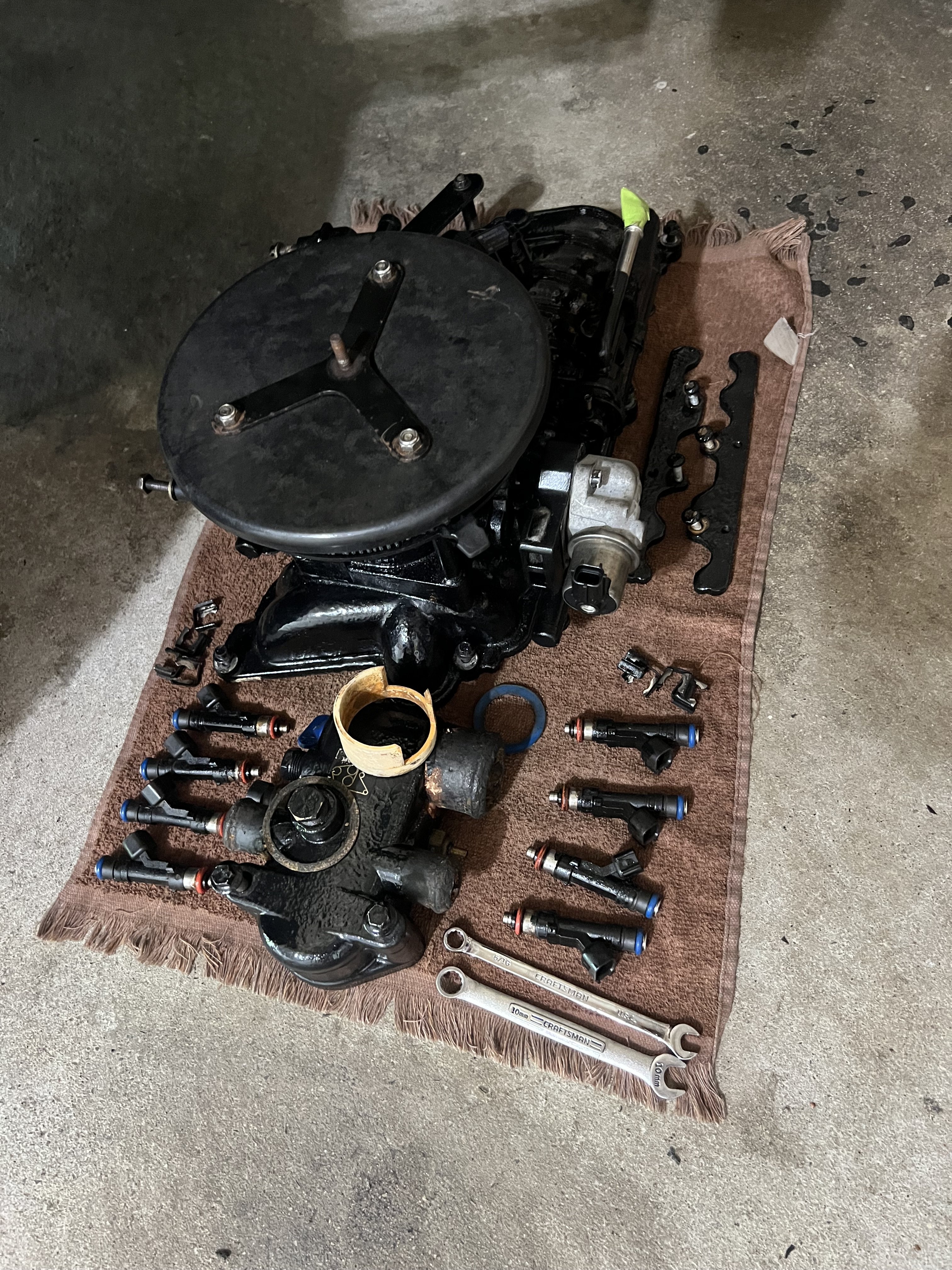

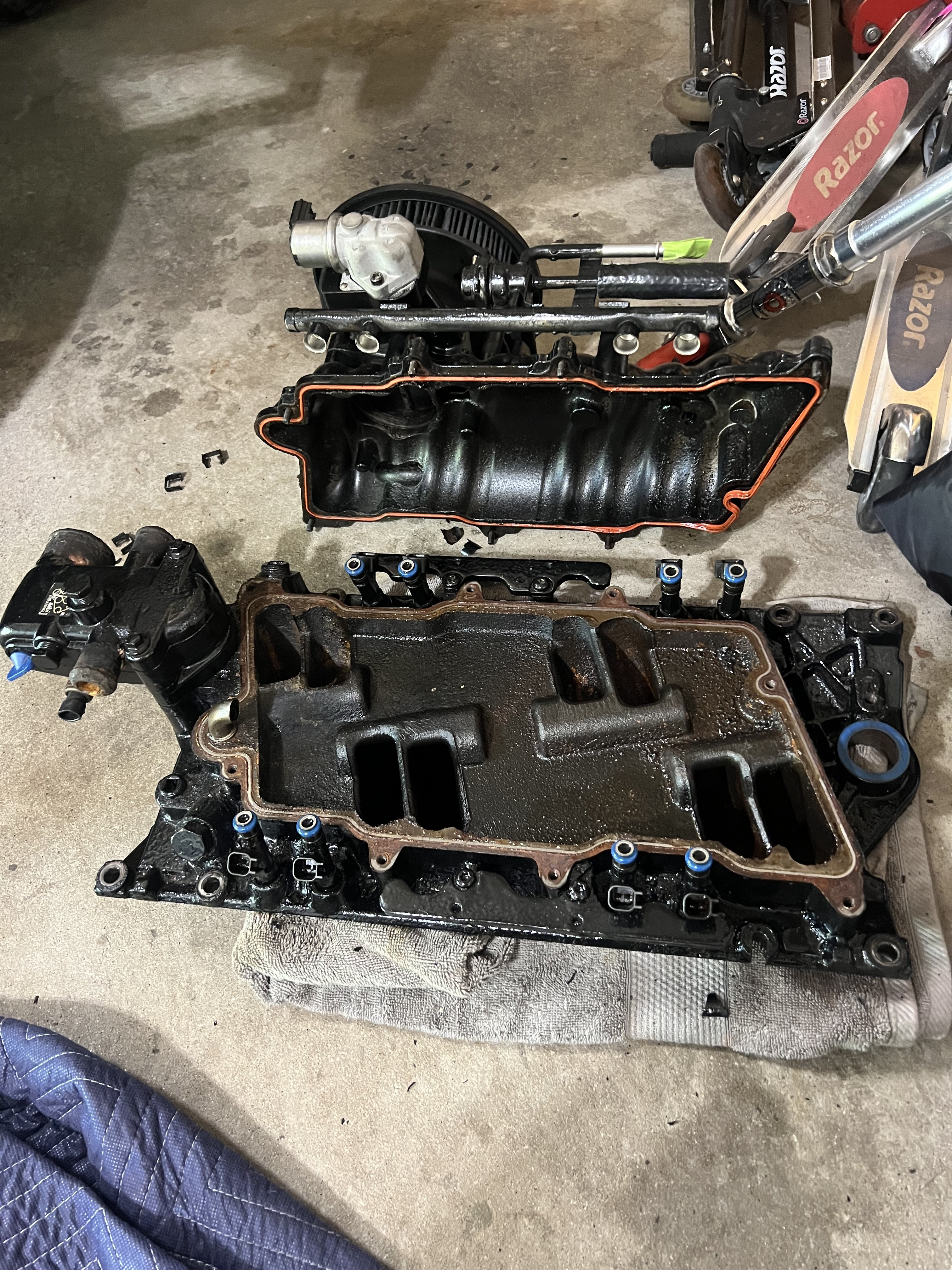

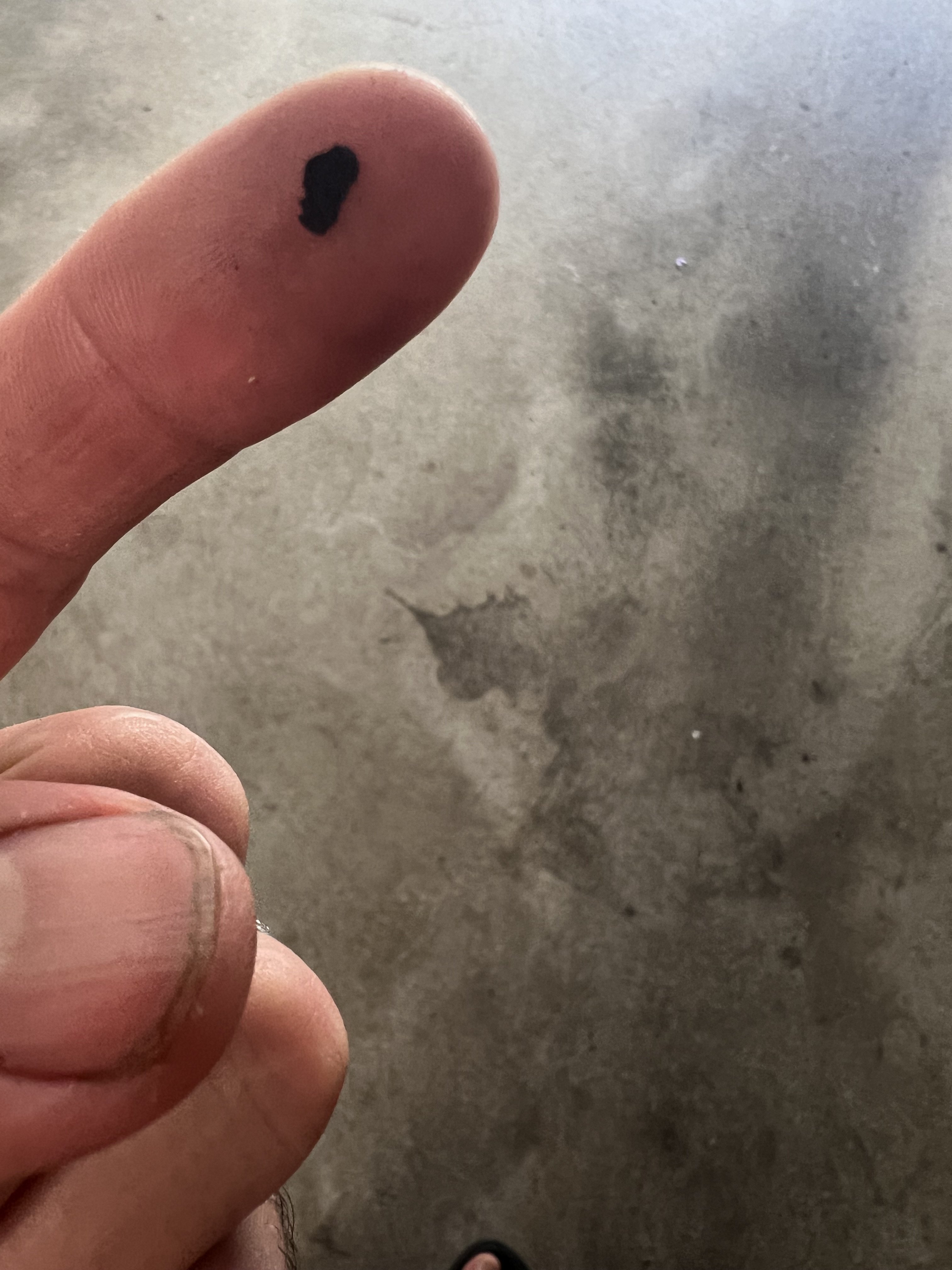

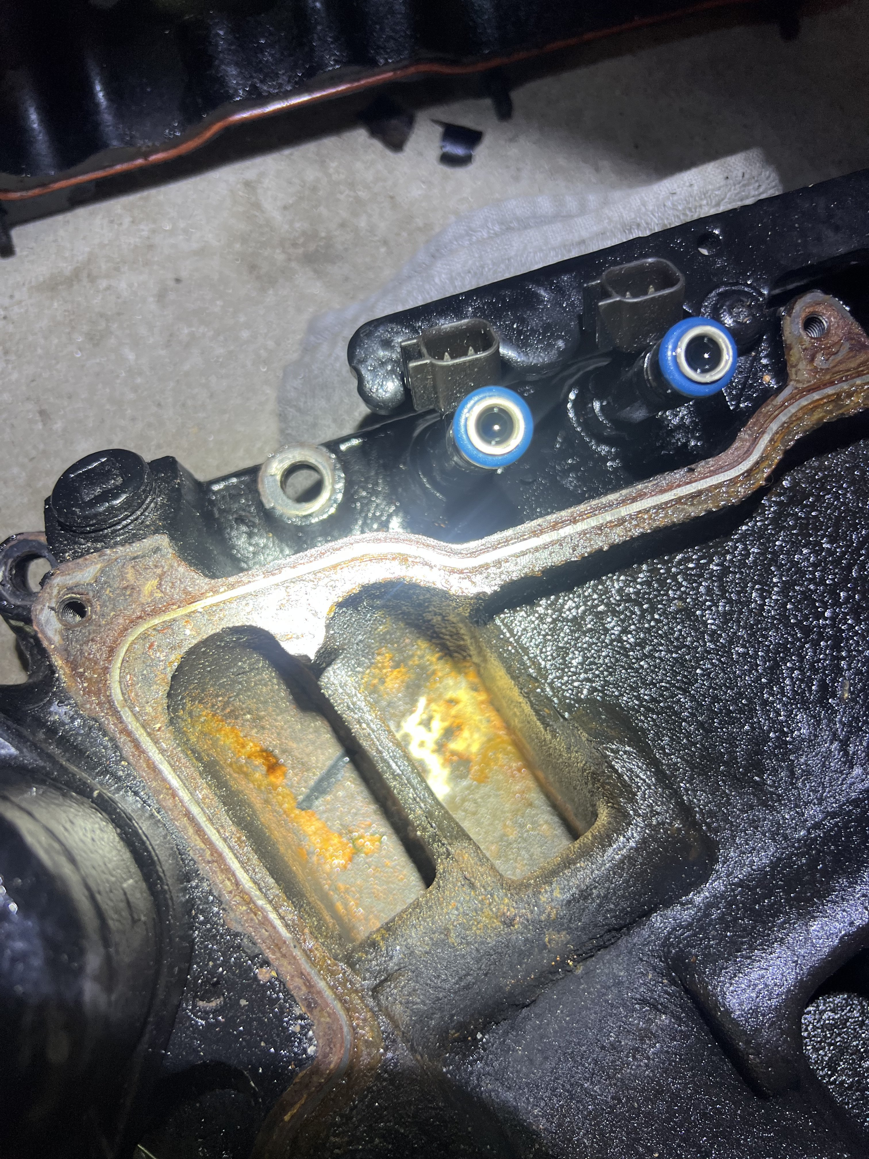

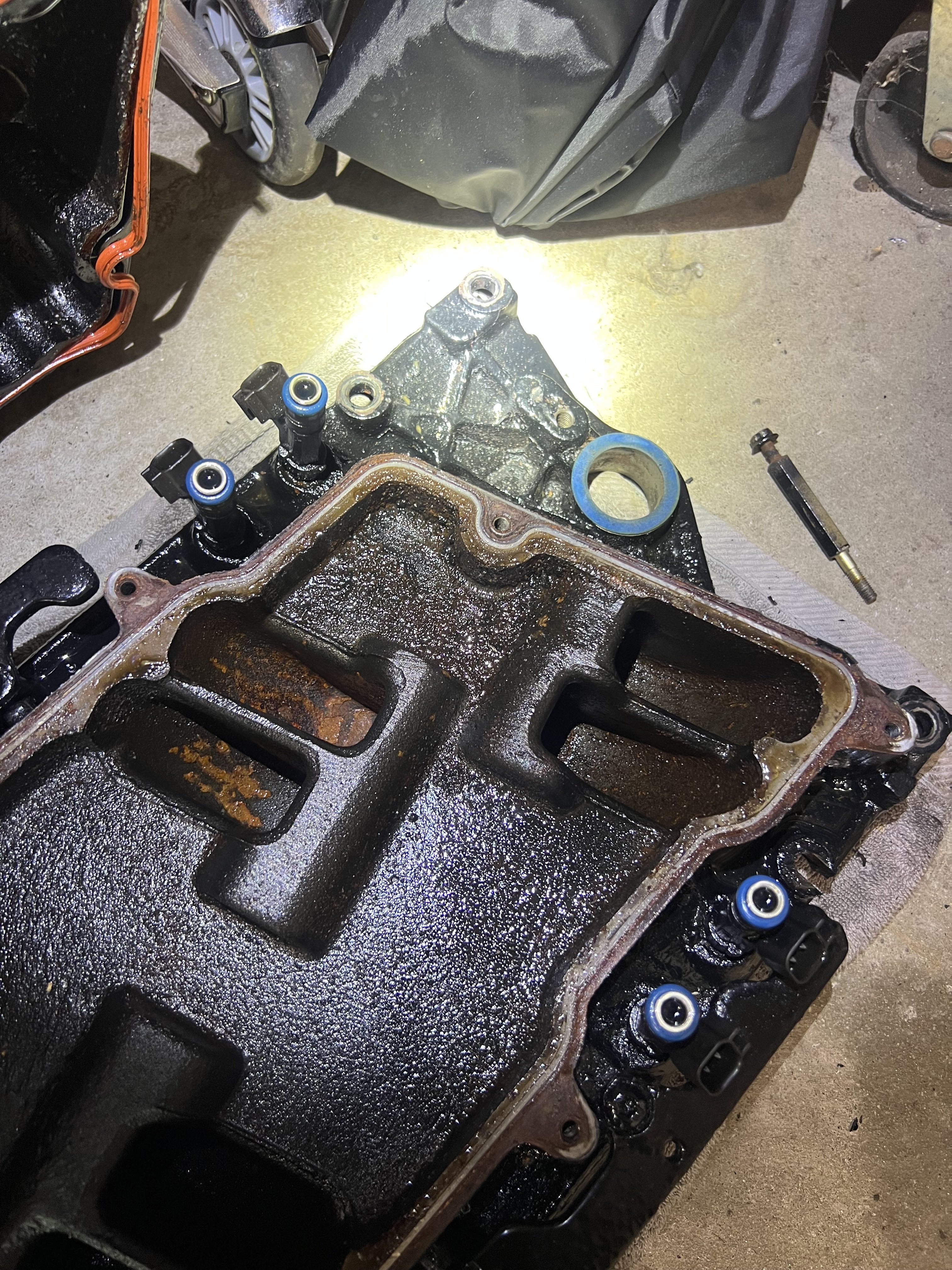

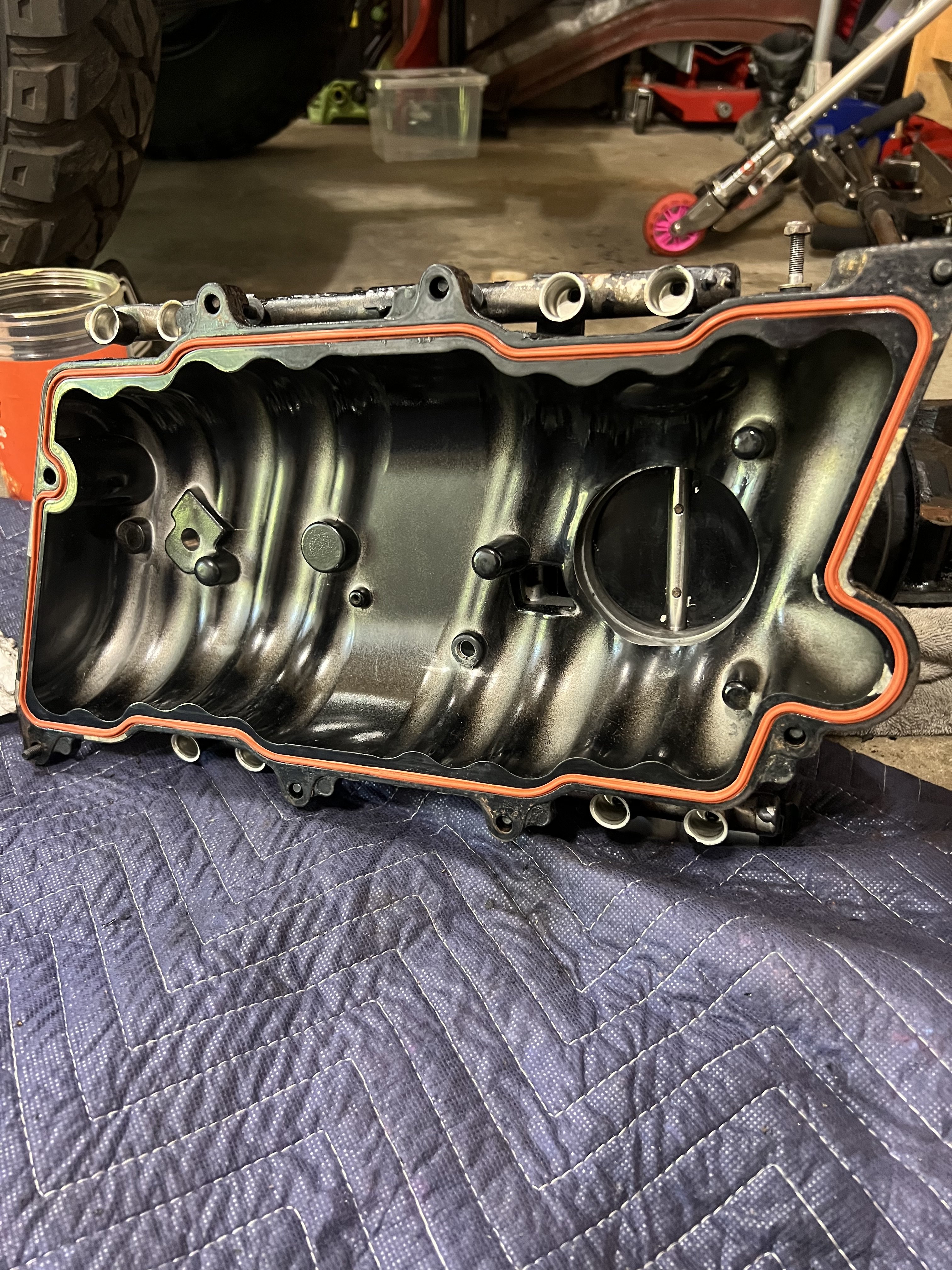

    I took the intake apart today. As soon as I pulled off the top, I saw a pretty big flake of paint in the number one injector. I just don’t know if it chipped off or fell in when I pulled the top off. Pretty coincidental. Top side of the intake inside was pretty dirty, got that all cleaned up. I stopped over at the machine shop today, he should be done today. There was a low spot between 3 & 5 and one of the valves wasn’t seating all the way around, I believe it was the #1. The thermostat was a bit@h to get out! I had to use a slide hammer!
  • aero3113aero3113 Member Posts: 10,031 ✭✭✭✭✭

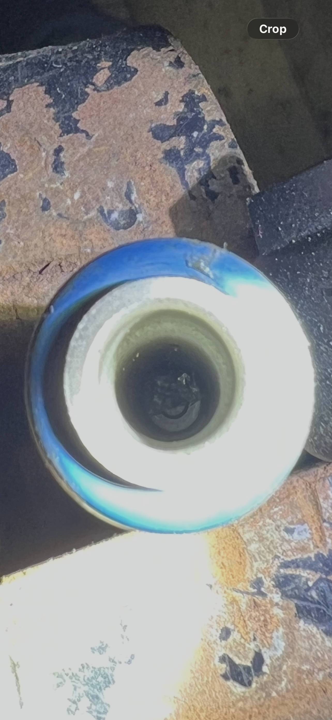

    I just said to myself that I should look into all of the injectors. Sure enough, there was a chip of paint in the #5 injector! I know my cool fuels were replaced. They probably didn’t clean out the injectors at that time. This engine always was a little lower in RPM’s but was still within range. I always blamed it on the gauge.

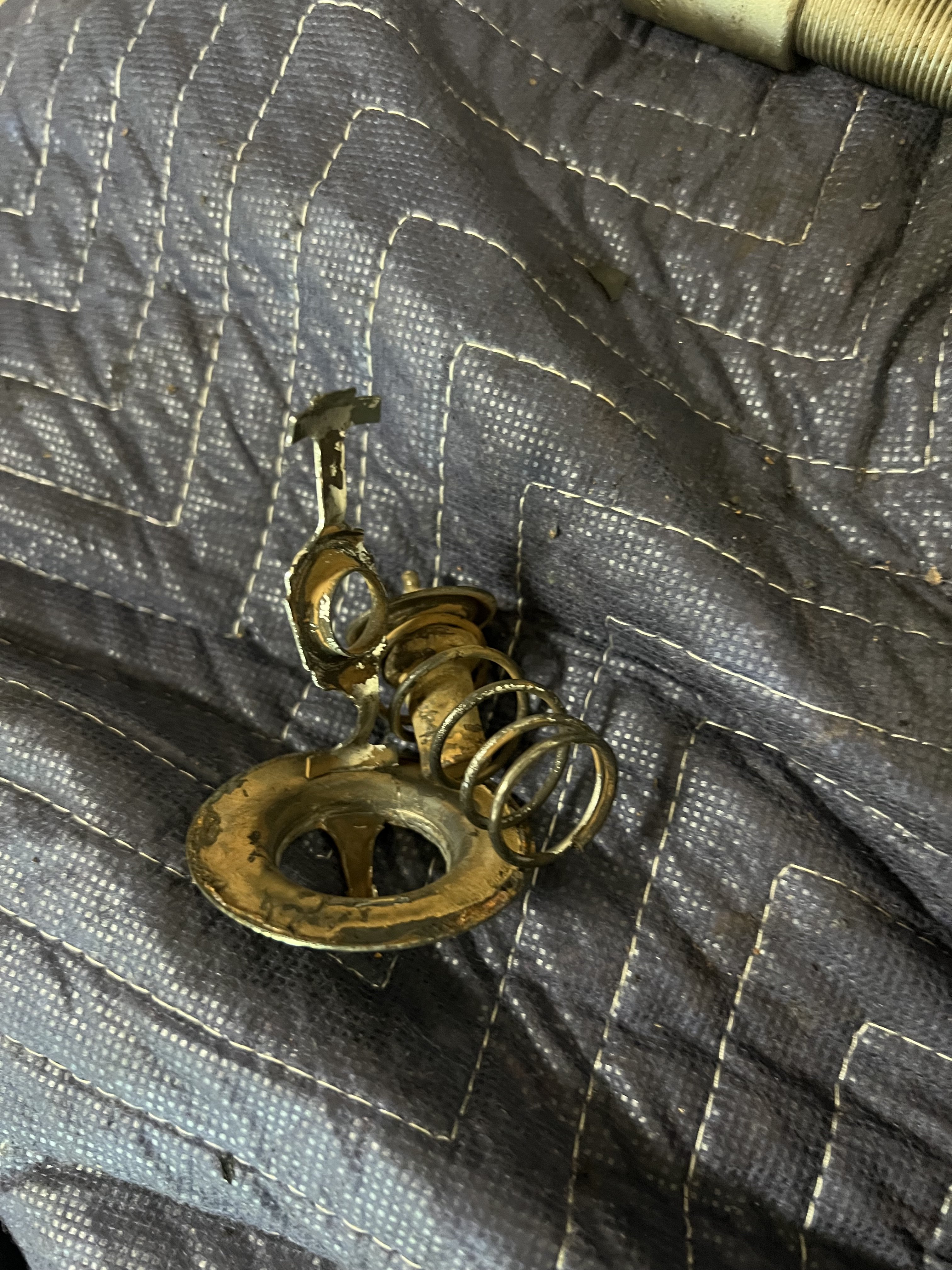

    I got the opposite head off to bring to the shop on Monday. The exhaust shutters were gone on that side! I ordered EMP shutters, half the price of OEM. $50 for one set instead of $100. I bought 2 sets. I’ll look the other side over and if it still looks good, I’ll keep it for future use. The company has a good reputation. There’s cheaper on Amazon but I don’t want to chance them.

    Am I correct in thinking that the shutter pieces went out the exhaust? Brovo drives aren’t like Alpha’s where they will get caught and you have to remove the drive to remove the pieces. I wanted to stick my borescope in but didn’t want to do it with water in the pipe.
