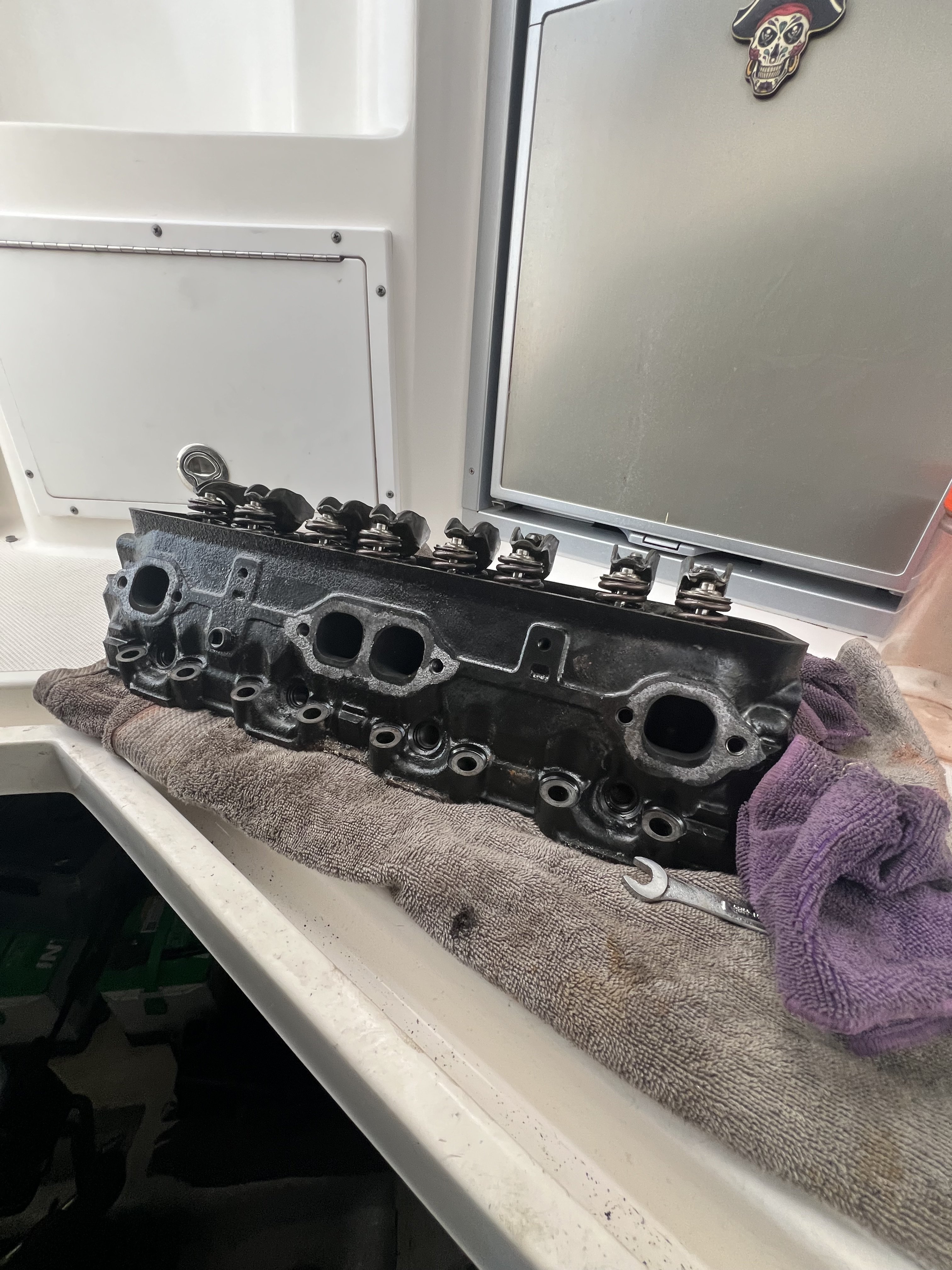

    I got the opposite head off to bring to the shop on Monday. The exhaust shutters were gone on that side! I ordered EMP shutters, half the price of OEM. $50 for one set instead of $100. I bought 2 sets. I’ll look the other side over and if it still looks good, I’ll keep it for future use. The company has a good reputation. There’s cheaper on Amazon but I don’t want to chance them.

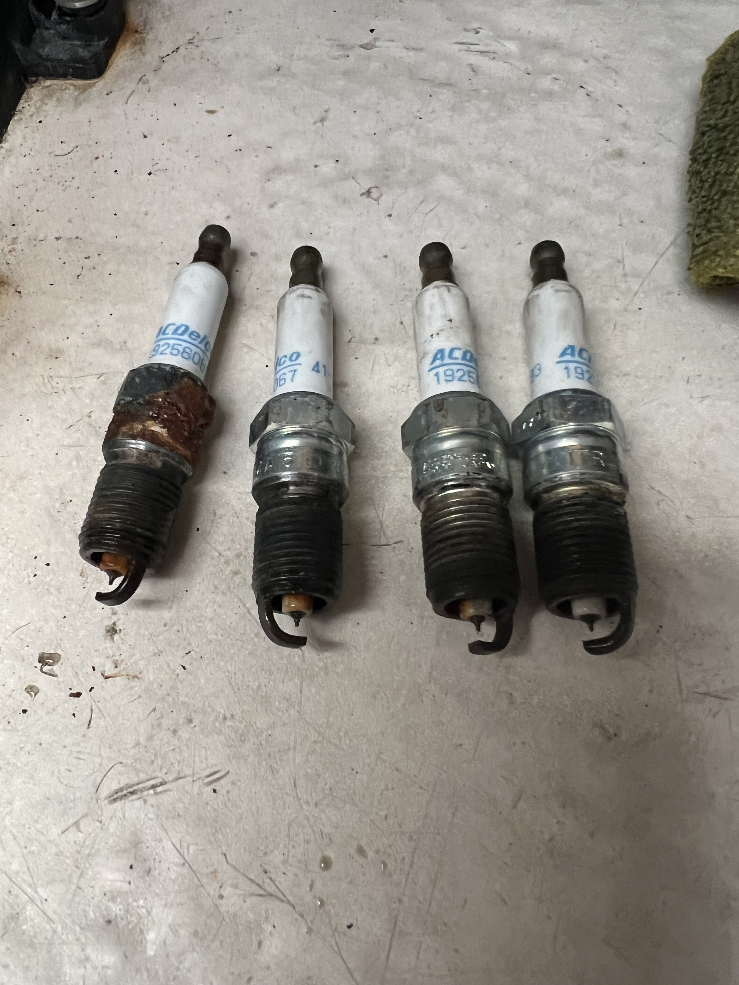

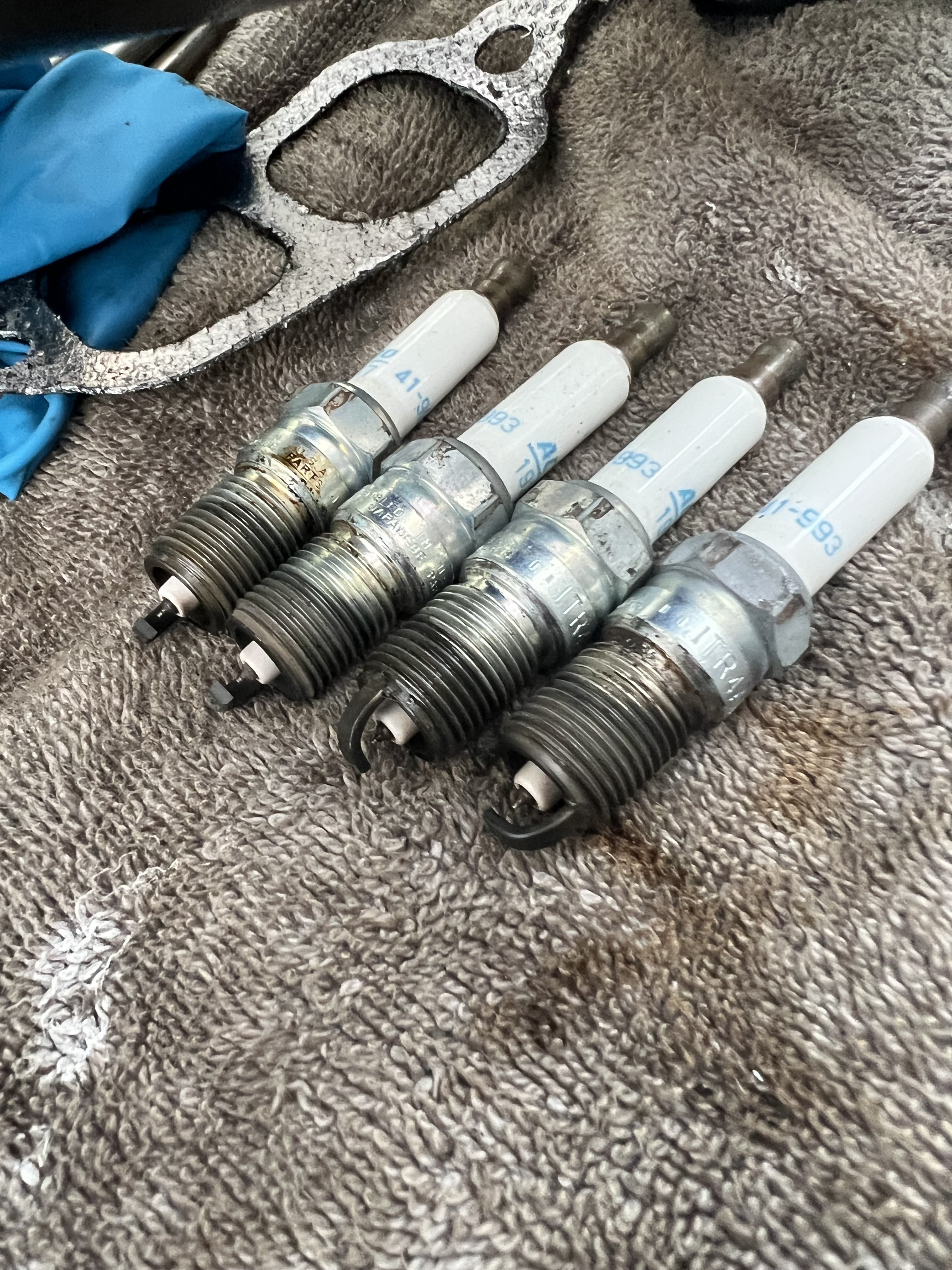

    2, 4, 6 and 8 plugs looked good. Maybe a little lean (thinking intake leak) but no where’s near 1, 3, 5 and 7!
    1, 3, 5 and 7
    2, 4, 6 and 8

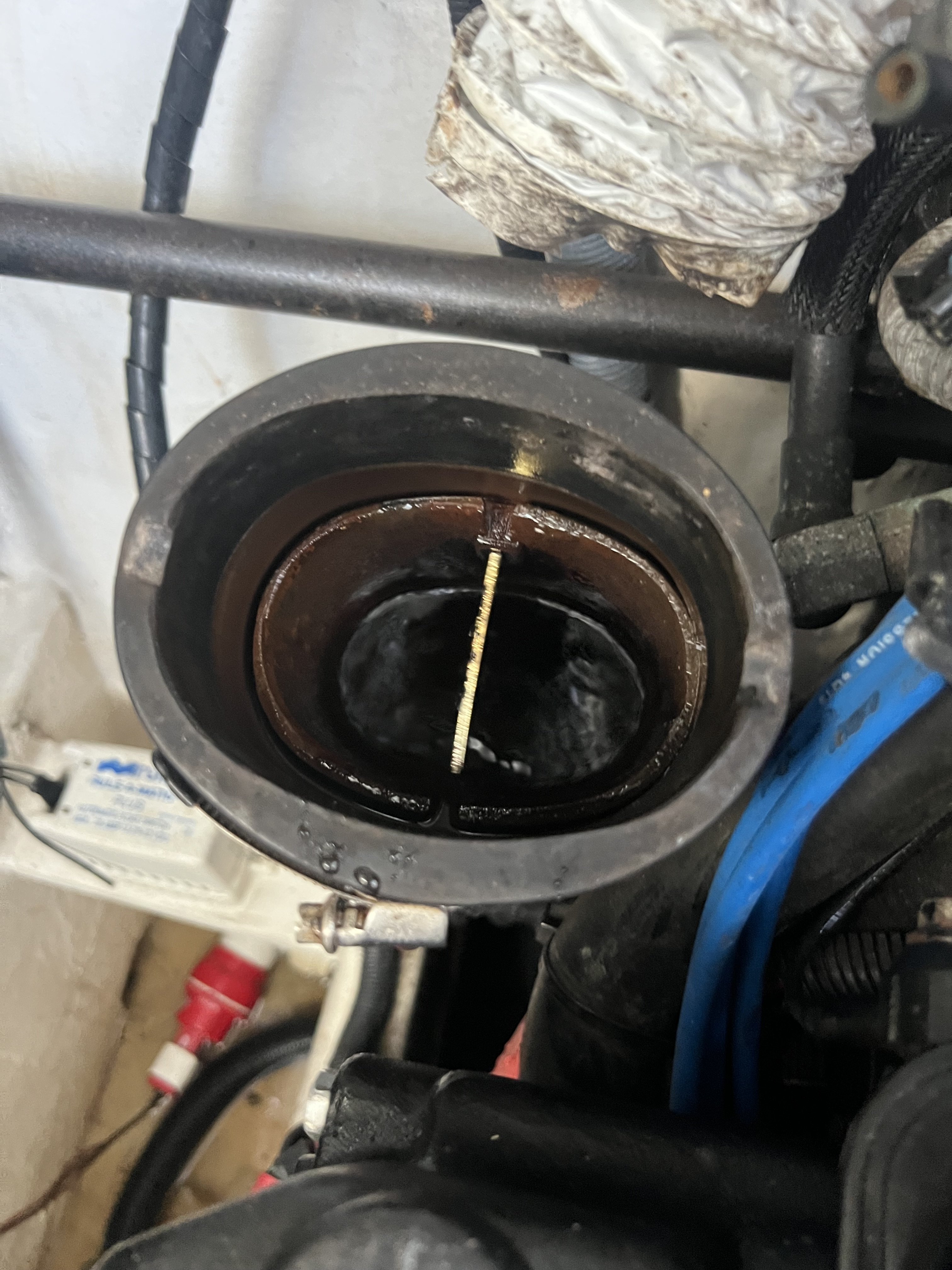

    Am I correct in thinking that the shutter pieces went out the exhaust? Brovo drives aren’t like Alpha’s where they will get caught and you have to remove the drive to remove the pieces. I wanted to stick my borescope in but didn’t want to do it with water in the pipe.
