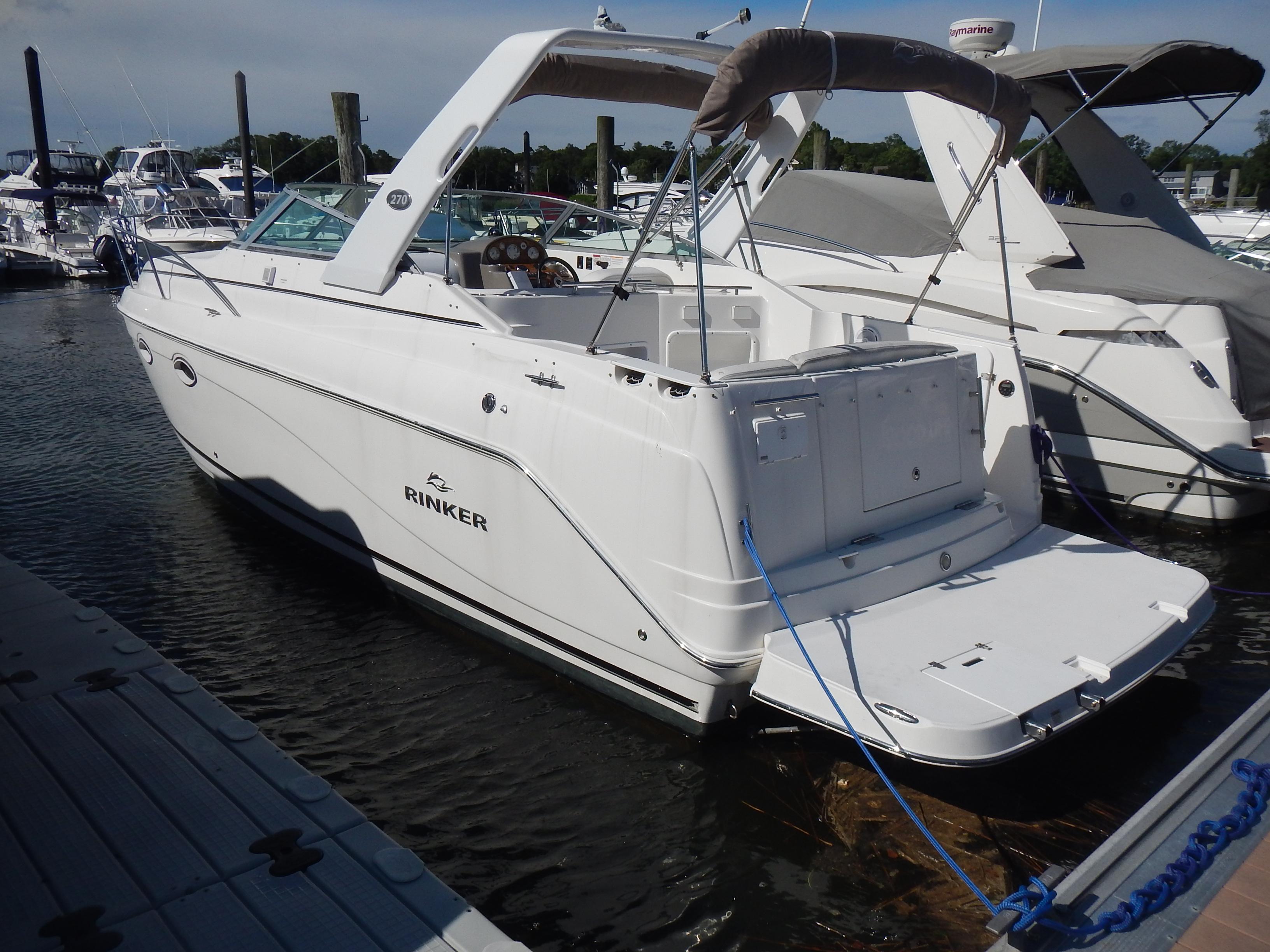

    Do you only have one place to plug in or two? This boat only has one --> http://imt.boatwizard.com/images/1/39/22/5853922_20160630052651691_1_XLARGE.jpg but I seem to remember people talking about having two or three of these..

    A friend on mine had a 270 with A/C only and he had a "single" shore power connection also.....
    Same here...my 2002 270 has a single 30amp input with a/c and heat.
    2002 - 270FV Mag 350 B3
  • J3ffJ3ff Member Posts: 4,224 ✭✭✭✭✭
    Well that's interesting, I wonder what the difference is.
  • rasburyrasbury Member Posts: 8,906 ✭✭✭✭✭
    Ditto in mine, has factory a/c and heat with one shore power but it is located on the other side of the arch than yours. I had thought the a/c and heat were kind of one unit. For where you at and had one or the other installed, you'd want the heat! Here in Florida we boat all year and for sure would want both. Great boat for our family, wish i had it in a slip to hang out on but have to save the boat bucks where I can. Good luck- lots if valuable info on here for sure...
  • Cableguy GregCableguy Greg Member Posts: 5,075 ✭✭✭✭✭
    You should only have one shore power input. The bigger boats, like the 310 and higher, usually have 2 30amp ports. The ones with three are the bigger boats that have 2 30amp ports and a port for a CATV connection. Most of the newer boats have what is call "It's Shore Choice" where there are ports on both sides of the boat so you don't have to drape the cords across the boat.
     I live in Pittsburgh and I have used the heat once in the 2 1/2 years that I have owned my 280. The only reason I had the heat on was because of a chilly Steeler home game in late October that I took the boat to. I usually run the air all night in the summer when it is muggy out.
  • summerxsummerx Member Posts: 211 ✭✭✭
    I would just make sure that the shorepower/AC was added properly.  I would want to make sure that it wasn't a DIY job done without the proper knowledge/know how.
  • Dream_InnDream_Inn Member, Moderator Posts: 7,910 mod
    & to add, the 420 has 2 - 50 amp connections.  Mine has the 2 30 amp connections and CATV/Phone with shore choice, as mentioned.
