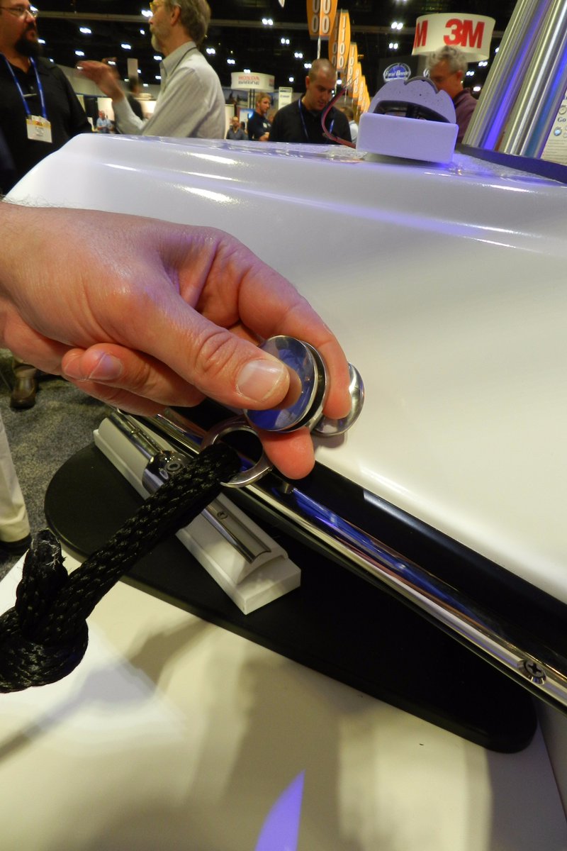

    I was planning to use the cleat forward of the gas fill for a fender; I guess it can do double duty!  I also have a couple of these fender locks that I never installed on my Four Winns; maybe I'll install them on the Rinker.
    https://www.amazon.ca/Taco-Metals-Marine-Stainless-Release/dp/B00S80R4JY
    I thought the lower cleat would be awesome for a stern anchor at the beach.  I will have some sort of dinghy brackets so the pop ups won't be ideal.
