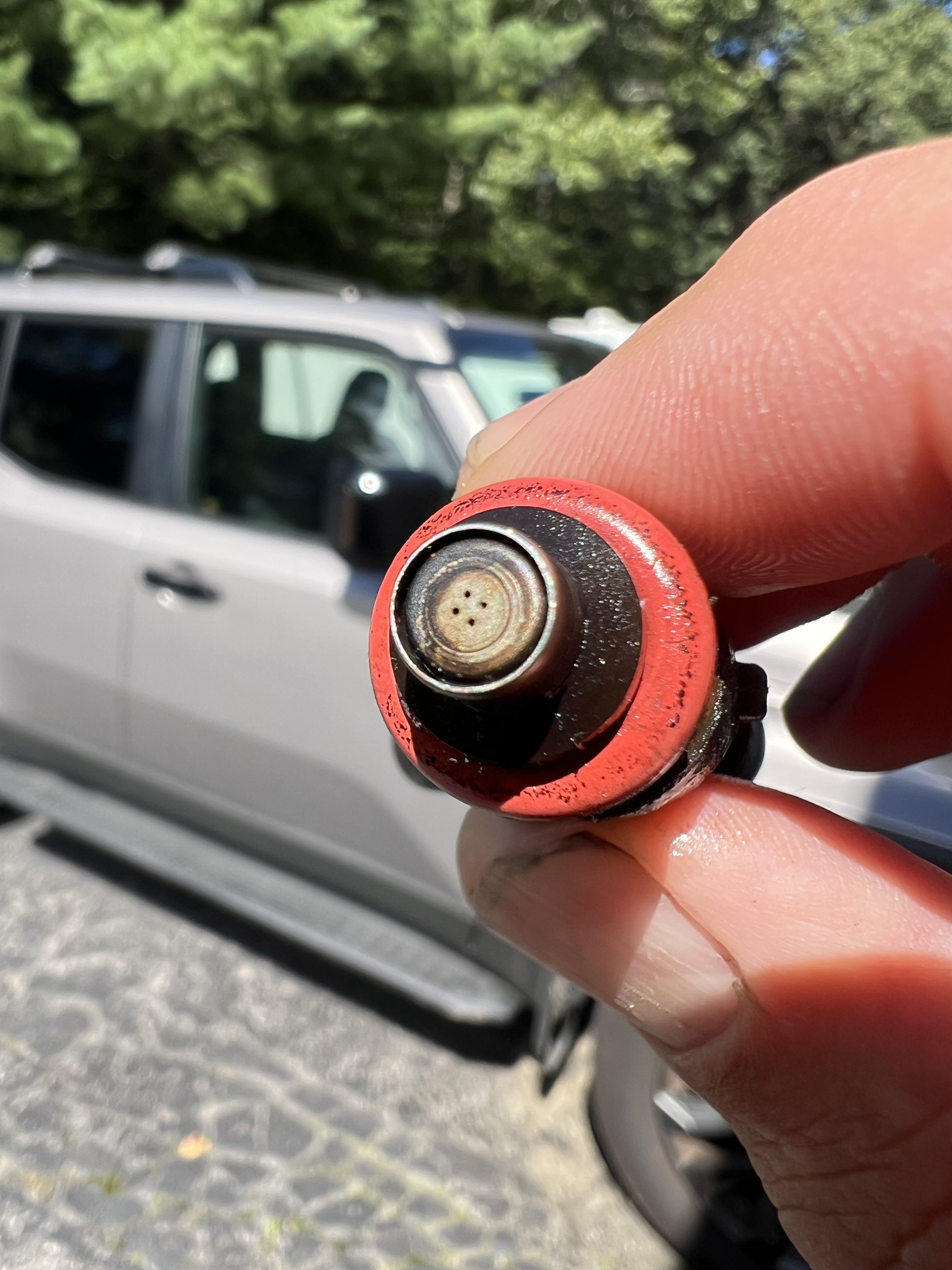

    @YYZRC , I noticed that your fuel injectors have 3 holes, mine have 4. I remember reading that there are different types. Are you sure you ordered the correct ones? I think the 4 hole is a newer version.
  • aero3113aero3113 Member Posts: 9,861 ✭✭✭✭✭
    I just remembered you have different engines in the new boat so they might be correct.
    @YYZRC , did you get your injectors off of amazon? I see I can get 8 for $75.00. Just hope they’re reliable.

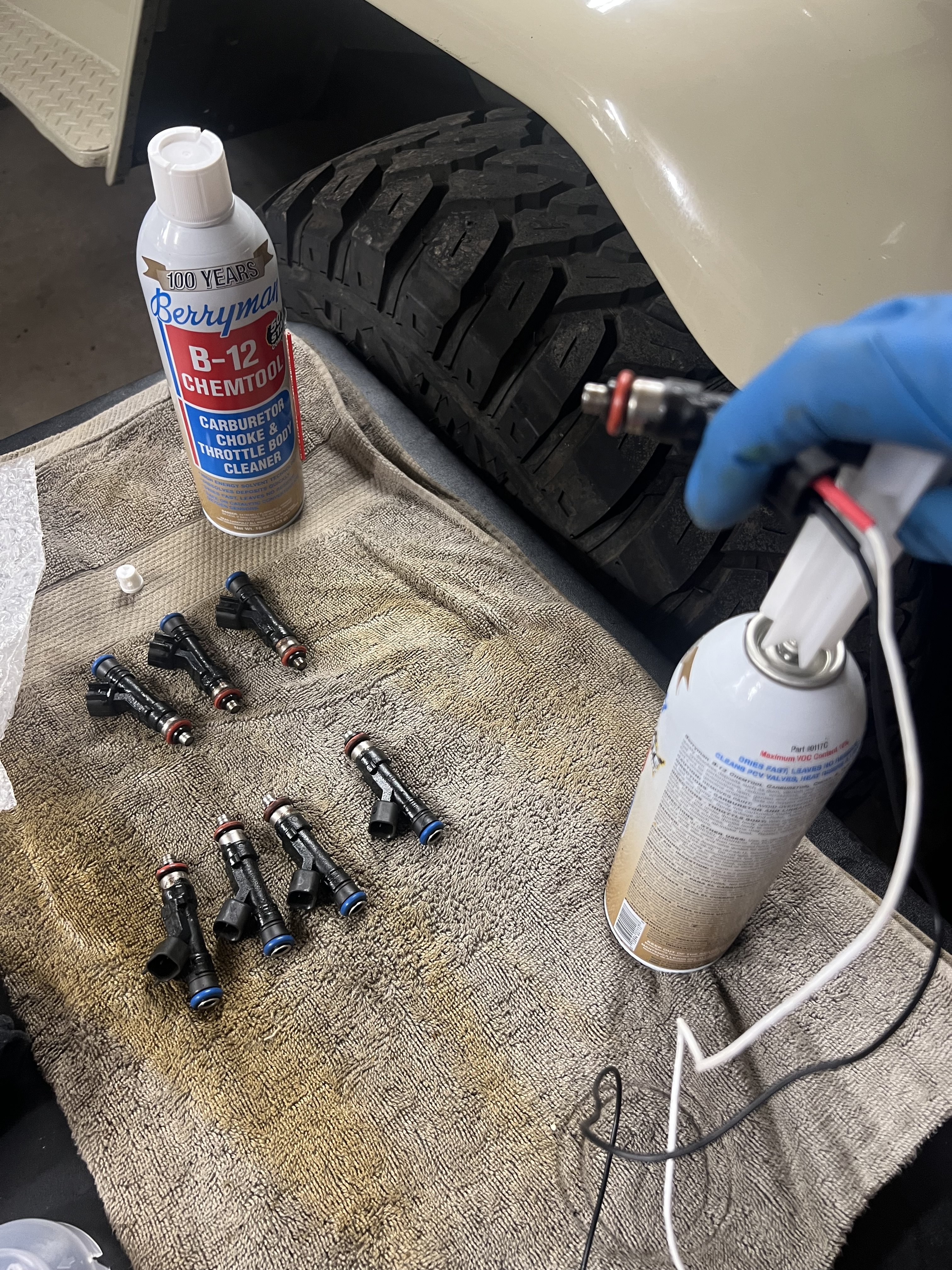

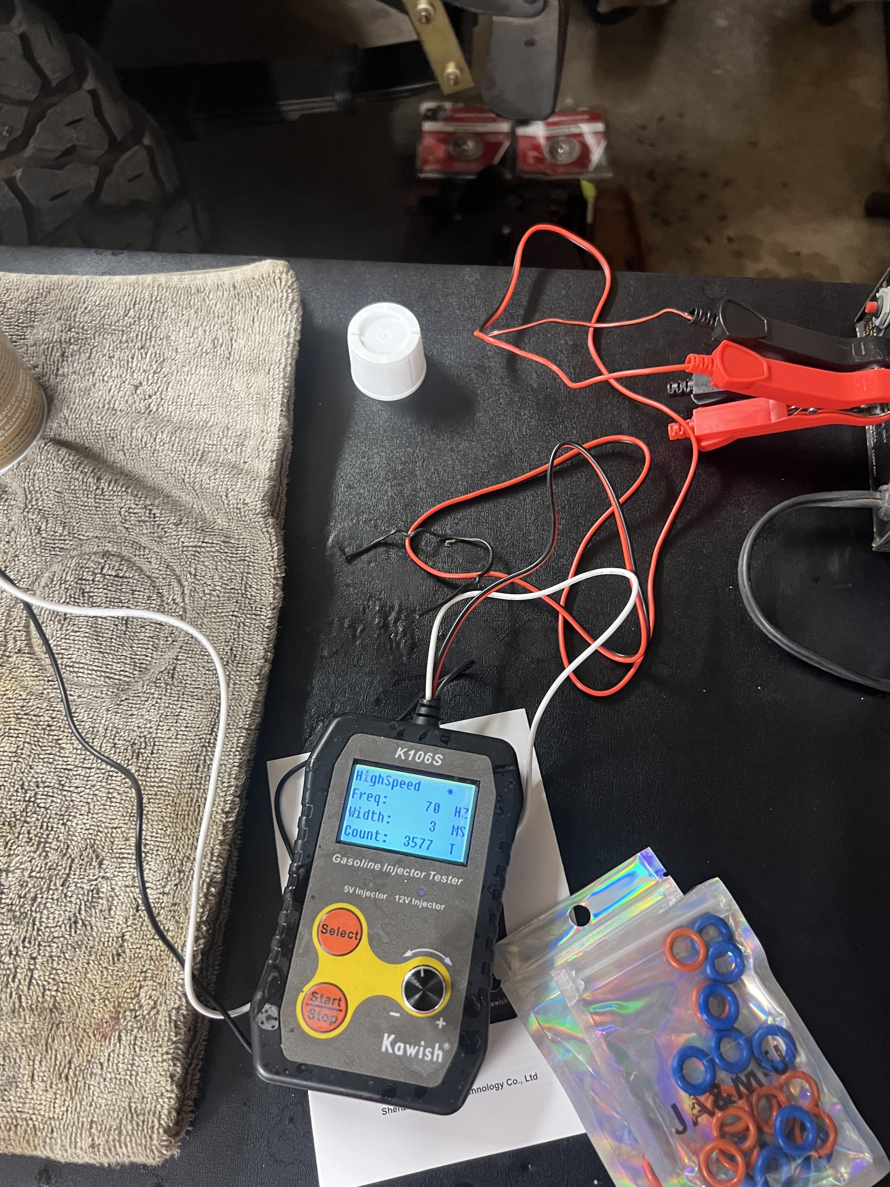

    @YYZRC , my injectors look pretty good and I checked the solenoids, they’re opening and closing. I bought this tool and will try cleaning them myself.
    https://a.co/d/05pFeHjH
  • YYZRCYYZRC Member Posts: 5,465 ✭✭✭✭✭
    edited September 19
    That's cool, please post results!
    I was quoted $25 USD per injector to clean/flow test.

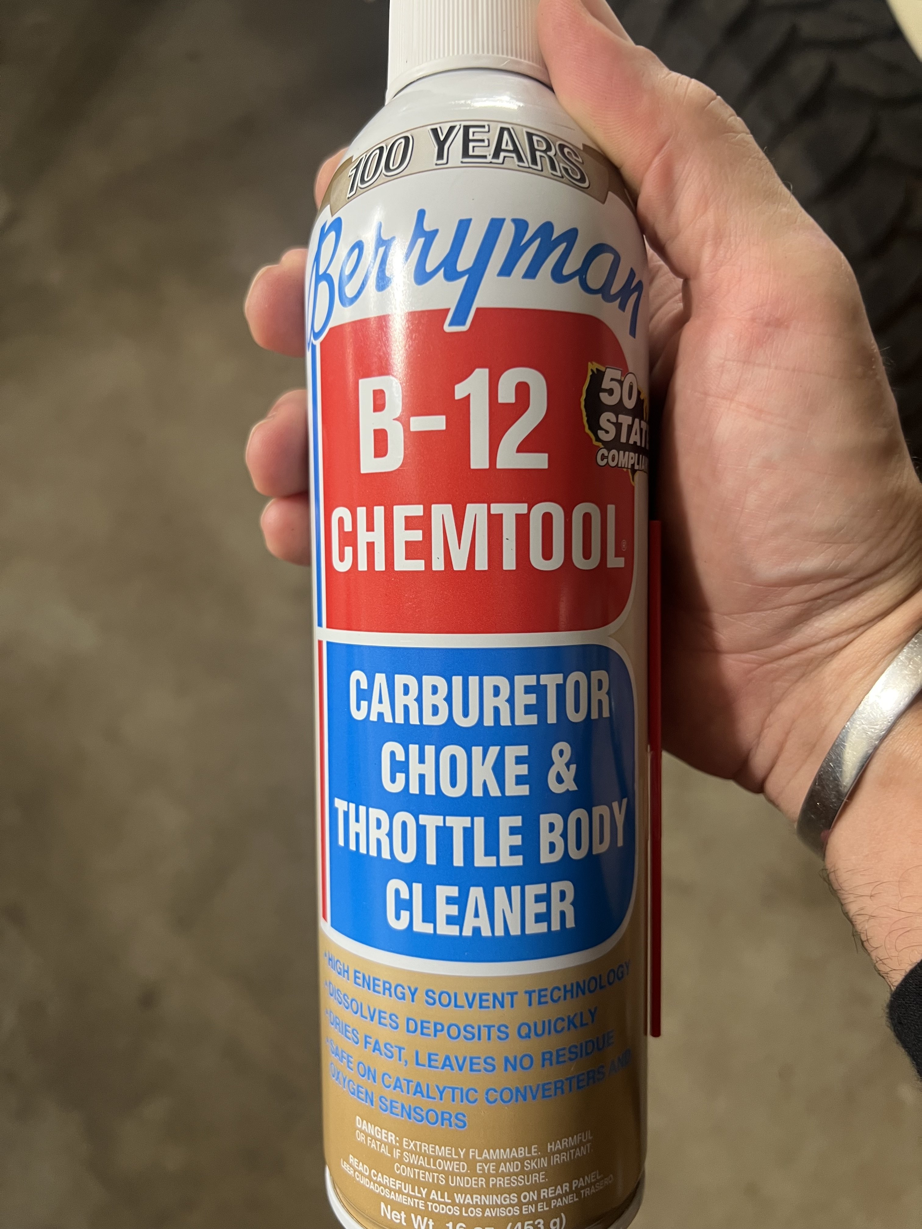

    @YYZRC I highly recommend the fuel injector tester. It’s a great way to get the concentrated cleaner through the injector. A couple of them seem to spit a little at first then cleared up. I went through all 8, did them twice. I used Berryman B-12.
    edited 9:21PM
    I bought some new o-rings off of Amazon but they were a little loose on the injectors. The old O-rings are in surprisingly good shape, I’ll probably end up reusing them.
