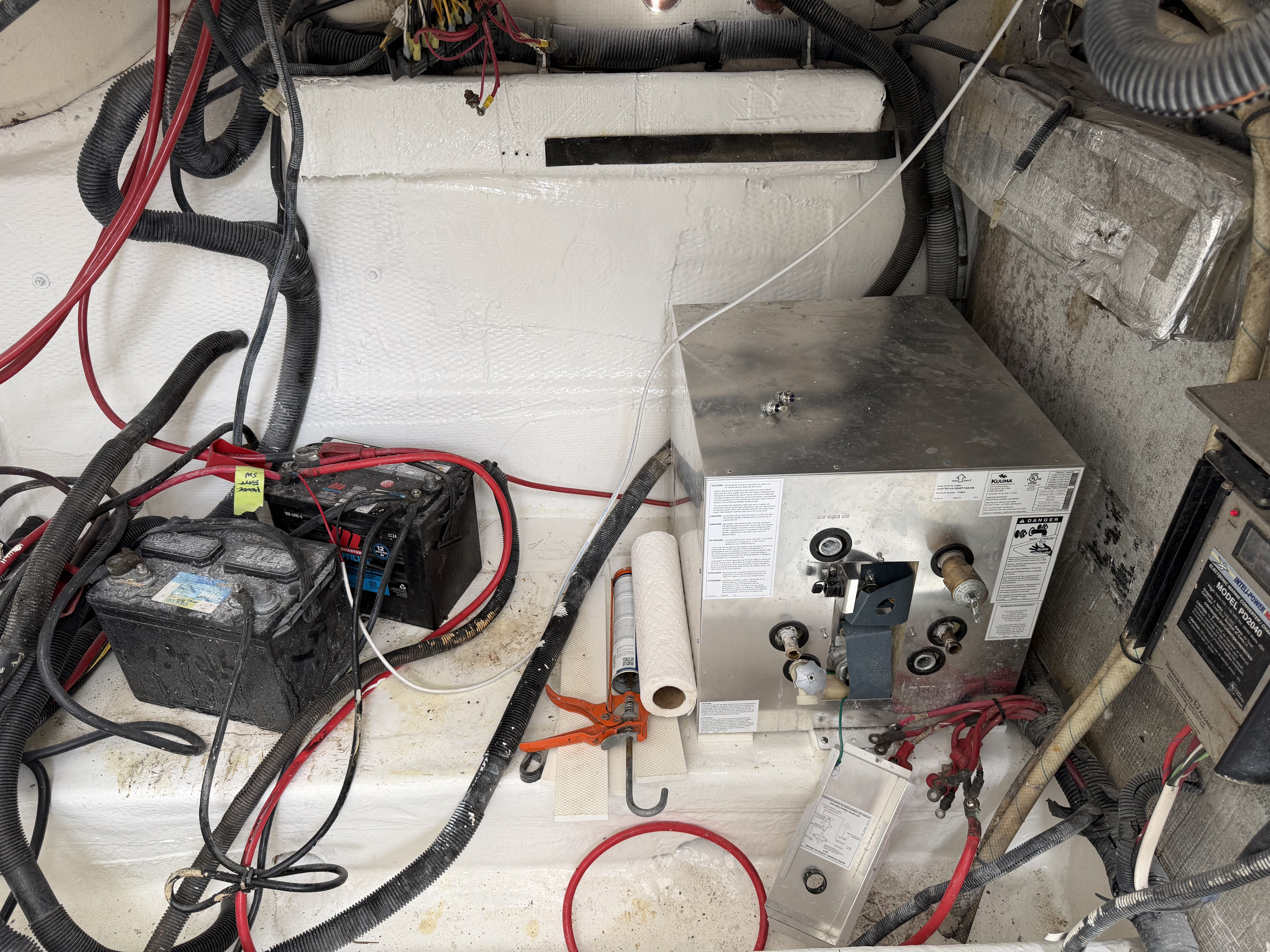

    Where will you or putting the water heater?
    I'm going to move it to the port side. I've removed all the starboard side plumbing (aft sink, transom shower) and I'm relocating the freshwater inlet to the port side.
    So, my only issue with this would be weight.  So, if you like to anchor out (& use your shower), you will find out that as you use your generator, fuel lightens on stbd side.  As you use your head, it gets heavier on port side.  You will notice that your shower drain is on the stbd side of the shower.  I will sometimes run both motors off the port side if I know I'm going to have a long weekend and make a lot of use of the generator.

    Understood. I think the weight distribution difference in my case will be minimal. I run an 11 gallon water heater which would be about 120lbs full. My house setup is lithium so the batteries (port side) will save about 50 pounds vs deep cycle flooded, offsetting about 1/2 of the water heater.
    But most critically, I will be mounting my hydraulic lift on the platform to carry my dinghy (700 lbs), and the motor is on the starboard side. On my 350, I always carry more fuel in my port tank to offset the dinghy motor weight bias. Will likely have to do the same on the 390.

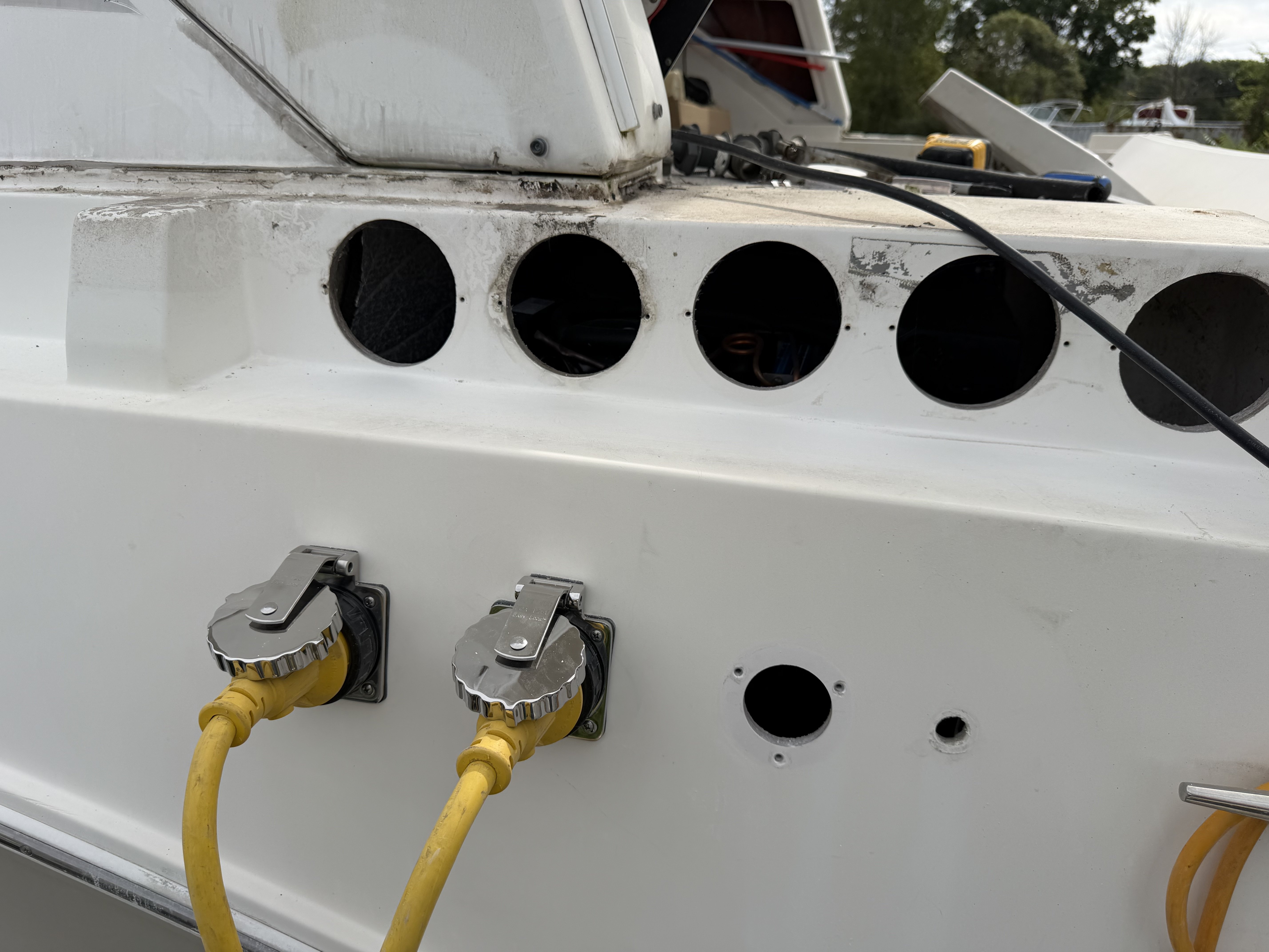

    Freshwater inlet moves to the port side (where the waste outlet is now). Power inlets also moved to port side (same as your 400). Waste outlet TBD (likely starboard side). Will be same setup as my 350. I use an Aquor inlet, totally awesome.

    The aqour inlet looks great!  & yes, moving the power to the side is much better!  Not sure why they had it down below in the way, never understood that one.

    The original shorepower location on the 390 is insane. I would love to know who decided that and why. In the captain's log I found, the owner replaced the inlets 3 times in a 10 year span due to shorting out. Not to mention the trip hazard.

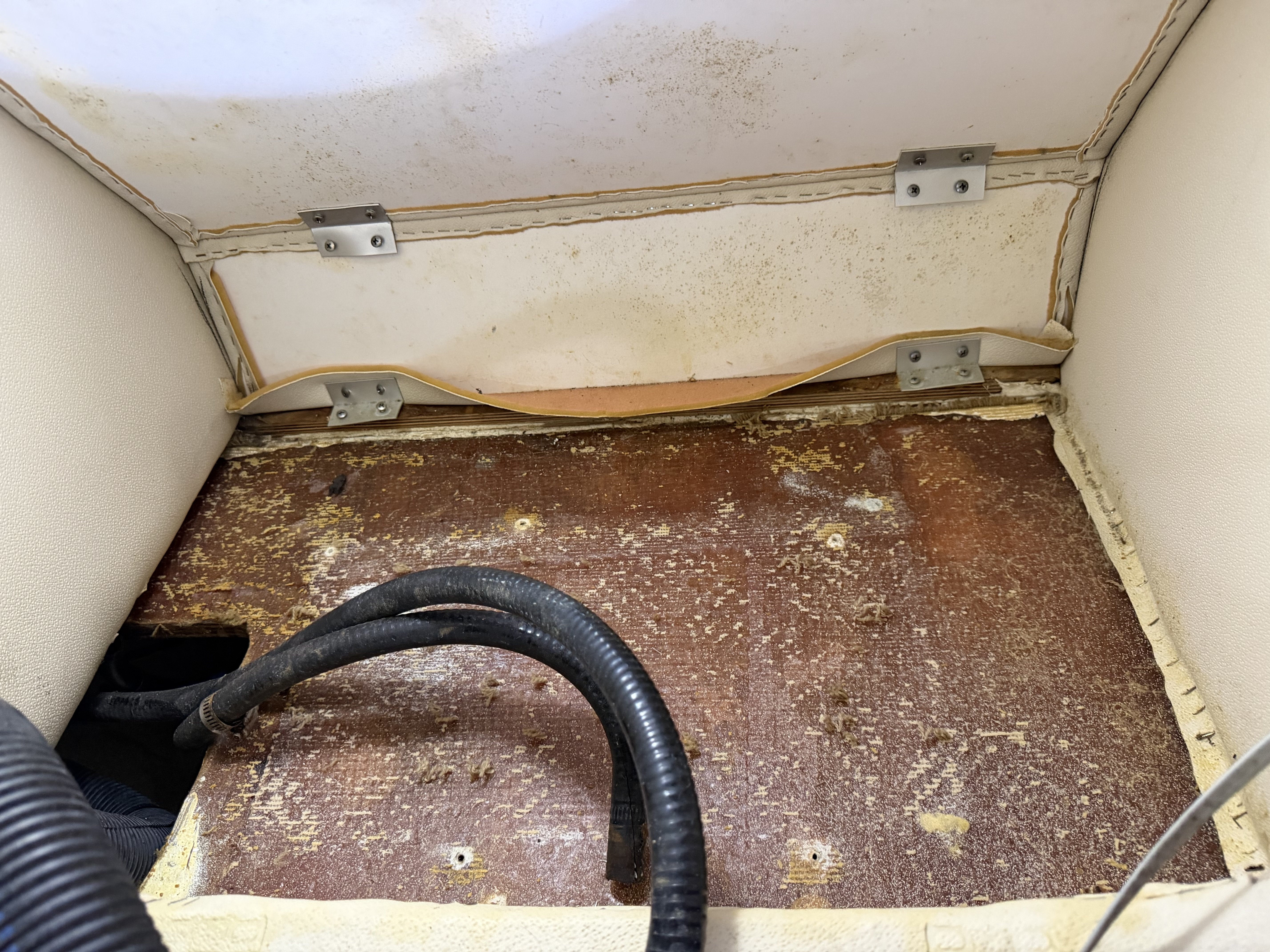

    Fair amount of water leaking in at the stern end of the aft cabin. Pulled down the cabinetry and the vinyl wrapped plywood was soaked/rotten. Certainly doesn’t help that the boat doesn’t have canvas right now. Will try to track down the source.
    Edit: the cabinets were held in place with 26 screws. No wonder Rinker went bankrupt.

    Water heater mounted in its new home. Sitting on starboard strips so it doesn’t rot out.

    Shore power relocated similar to 330/350 with nice new Marinco inlets

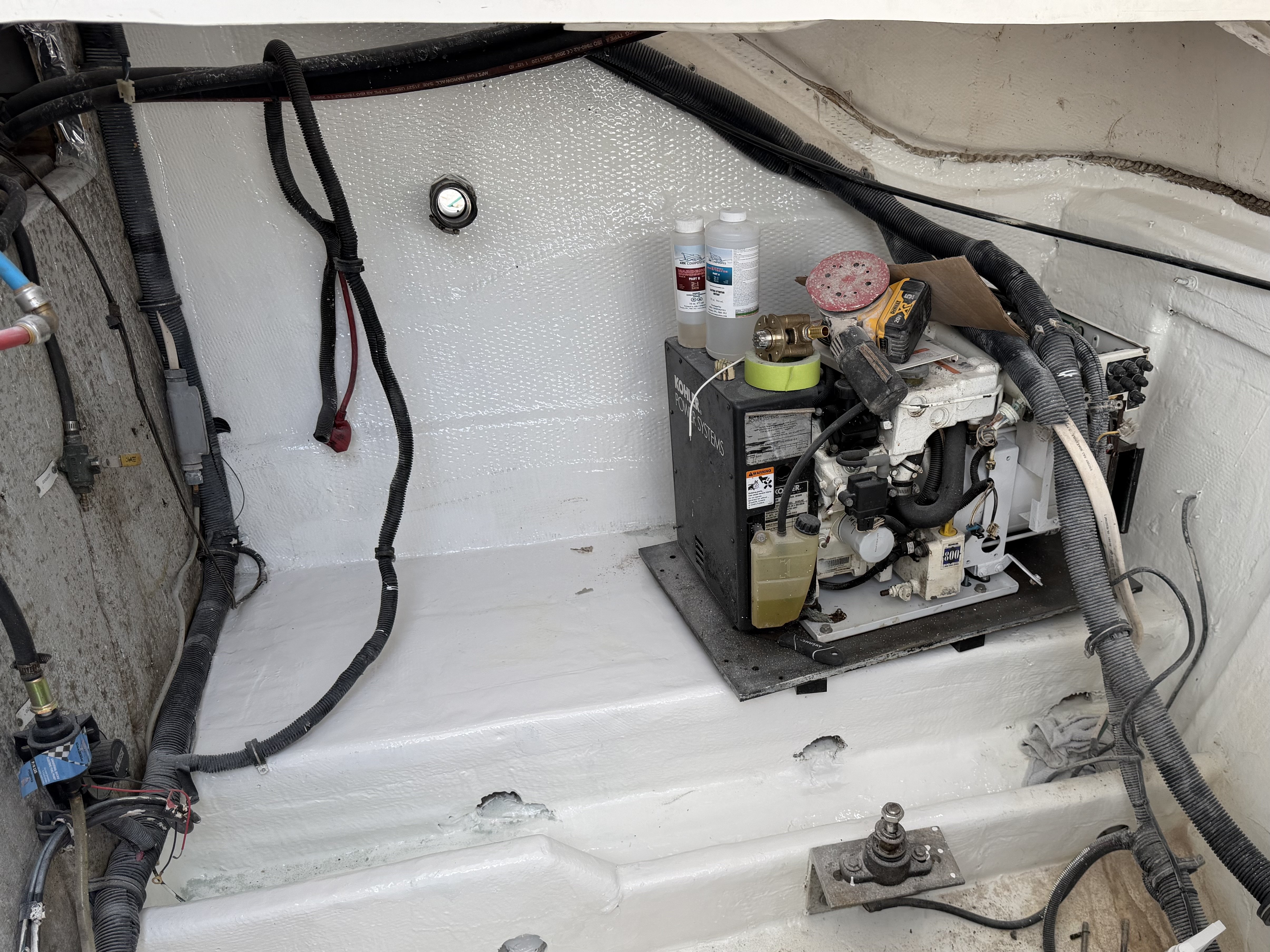

    Bilge paint almost done.
  • aero3113aero3113 Member Posts: 9,864 ✭✭✭✭✭
    Looking good!!
